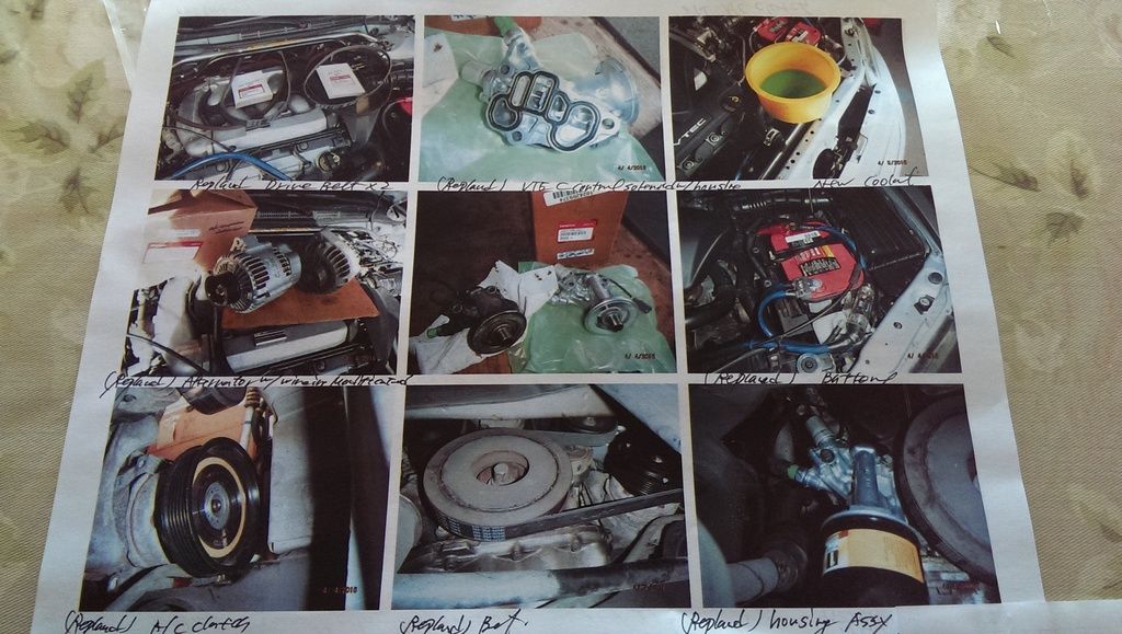

(Didn't know this 'till a while ago, but he is a former F1 mechanic in Japan, and opened up his shop some 20+ years ago up here in Seattle. I don't know anyone else who can do the mechanical work so carefully like he does. His paperwork might be a bit old school, which it doesn't matter to me at all, but the cool thing is that he always documents all of his work "with photos", and carefully goes over the details. Unlike other shops I've known, I feel like I'm talking to him as if I was seeing a doctor lol.)
His printout looks like something that we all wanna do it (taking diy pics 'n posting them w/ details) for fun lol:
He didn't even charge me for installing the battery, though modding one terminal was required. He even fixed my side mirror glass being loose, and adjusted the alignment on my door latch for free, which neither of these were even addressed in the first place.. I just found that out the next day. :roflbow:
