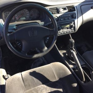

Aloha.
Documenting a possible Jay Thirty Two 6MT LSD heart transplant.
______________________________________
Donor Engine: ('03 CL-S 6MT)
– Motor
– Six Speed Manual LSD Transmission
– ECU (PGE-A12)
– OEM Axles with Half Shaft
– Shift Cables and Shift Box
– Alternator
– Starter
– Clutch
– Flywheel
– Intake Manifold
– Exhaust Manifold
– Fuel Rail
– Injectors
– Coils
– Engine Harness
– All Sensors Needed
Maintenance : (CL-S 6MT OEM Parts Replacement)
– Throttle body gasket
– Throttle position sensor gasket
– Cylinder Head Cover Gaskets
– Valve Cover Gasket
– Rubber Grommets
– Intake Manifold Plenum Chamber Gasket
– Intake Manifold Gaskets
– Exhausts manifold gaskets
– Head gaskets
– EGR Gasket
– Spark plugs
– Spark plug wires (leads)
– Ignition coils
– Distributor Rotor
– Exhausts Manifold ----- Aftermarket DC Sports (HHS5528)
– Drive belt
– Timing belt
– Tension pulley
– Idler pulley
– Water pump
– Oil pump
– Pressure relief valve
– Oil Filter
– Main Seal (Front & Rear)
– Axle Seals
– Oil Pan Gasket
– Thermostat
– Radiator hoses
– Alternator
– Starter
– Clutch
– Flywheel
– Intake Manifold
– Fuel Rail
– Injectors
– Water temperature sensor
– Fuel Pump
Required Add-on : (For '02 Accord V6 to run with no hazards)
– Engine mounts ----- OEM ’03 CL-S 6MT
– Transmission mounts --- OEM ’03 CL-S 6MT
– Intake manifold ----- OEM ‘09 TL SH-AWD J37
– Thermal throttle body gasket ----- Aftermarket '03 CL-S 6MT by P2R (P141)
– Thermal throttle body gasket ----- Aftermarket '09 TL SH-AWD J37 by P2R (P149)
– J35 Top plate ??
– J35 Intake manifold cover
– J37/J32 Throttle body adapter ----- Aftermarket '03 CL-S 6MT by P2R (P383)
– EGR Block off plate??
– Engine air intake ----- Aftermarket '03 CL-S 6MT by AEM SRI
– Shift knob
– Shift boot ----- OEM '02 Accord 5MT
– MT brake pedal ----- OEM '02 Accord 5MT
– Clutch pedal ----- OEM '02 Accord 5MT
– Clutch pedal mounting box ----- OEM '02 Accord 5MT
– Master cylinder ----- OEM ’03 CL-S 6MT
– Slave cylinder ----- OEM ’03 CL-S 6MT
– Dash wire harness with E Plug ----- OEM ’03 CL-S 6MT
– CL-S 6MT Fuse box??
Required modifications:
– J37 2009 – 2014 TL-S SH-AWD Intake Manifold installation for more hood clearance
– CL-S 6MT E Plug custom wiring to Accord’s dash wire harness
– If not the above, a whole CL-S 6MT Dash Wire harness installation
– Shift Cables and Shift Box installation
– MT brake pedal, Clutch pedal, and Clutch pedal mounting box installation
– A car key reprogramming service at a dealership due to the new ECU installation
Watch-outs:
– Some Accords may not have a machined print for the clutch master cylinder in the firewall
– MT brake pedal installation may possibly be a PITA
Notes kept from fellow 6GA members’ wisdoms:
"Manifold part# 17160-RK2-A00 from Acura
Manifold cover part # 17116-R70-A00 from Honda
P2R adapter part# P383B= (Black), P383R= (Red), P383= (Silver)
P2R gasket part# P141
P2R gasket part# P149
That is all the part #'s for the parts that you will need to make the 09 TL awd manifold to work.
You will need qty of 9 bolts size 8mmx65mm with 1.25 pitch.
For the manifold gasket i can't find the part number but just call them. They have awesome customer service.”
“Anyhoo. ... happy to hear that you're going the j37 route. Everything works ok except the imrc ... problem is that the j32a2 IMRC is spring retained ... meaning the j32a2 ECU only sends the open signal ... once the open signal stops being sent by the j32a2 ecu, the j32a2 IM spring closes. The j37 IM IMRC requires both an ON and OFF signal to open and close ... respectively. Thus we left the butterfly valves open all the time and did not wire in the IMRC signal. You might lose a bit of torque low in the RPM ... but you gain a bit in the higher RPM band.”
“No real issues from running that (J37 IM). Basically just have to block off one port”.
“You’d have to either put in an entire harness and re wire it to your accord cluster and hvac, or just cut one plug off and re wire into your existing dash harness in your accord now.”

Parts need to be removed:
– Motor + mounts
– Engine Wire Harness
– Six Speed Manual LSD Transmission + mounts
– ECU (PGE-A12)
– Shift knob, Shift Cables and Shift Box
– Brake pedal
– Clutch pedal
– Master cylinder
– Slave cylinder
– Alternator
– Starter
– Clutch
– Flywheel
– Intake Manifold
– Exhaust Manifold
– Fuse box
– Dash Panel + Shifter Console + Steering wheel
– Dash Panel Wire Harness
– Trunk Release Unlock
– Taillight Trunk Open Unlock

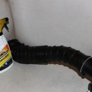

Parts per Modification:
– Intake manifold & gasket ----- OEM ‘09 TL SH-AWD J37
– J35 Top plate ??
– Shift Knob ----- OEM ‘03 CL 6MT
– Clutch Master cylinder installation
– Emergency Side Brake / Parking Brake Relocation
– Brake pedal, Clutch pedal, and Clutch pedal mounting box installation
Watch-outs:
J37IM Swap:
You will need qty of 9 bolts size 8mmx65mm with 1.25 pitch.”
