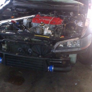

Hi Sil2DrV6, working on my 02 accord - swapped in the j32a2 and hit the hood clearance issue ‍♂️ just reading your posts I see you used the j37 IM is that much smaller without reducing flow?
Hello! Congrats on getting the motor swapped! Yes, that's the whole reason why I got the J37 IM. The adapter is necessary tho, made by P2R Power Rev Racing. Otherwise, as far as I heard, you gotta cut out the subframes to lower the clearance, or rase up the hood.
