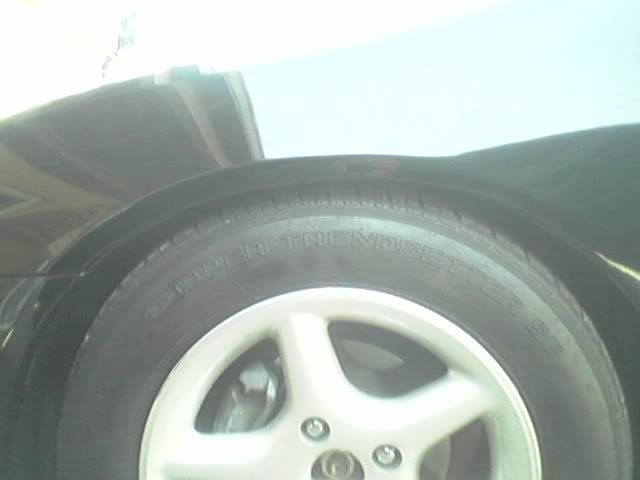

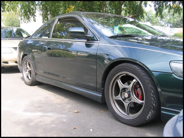

c'mon guys. a honda ain't a honda unless it's slammed :D
it's more like 3 inches or so, but still there is barely a gap...check it out.
yeah, but you have 15's (?) on there.... that would kill the ride if you had 18's and a decent tire size. I think it looks f*ckin' cool...... but I couldn't deal with all the scraping.... and speed bumps.:)
