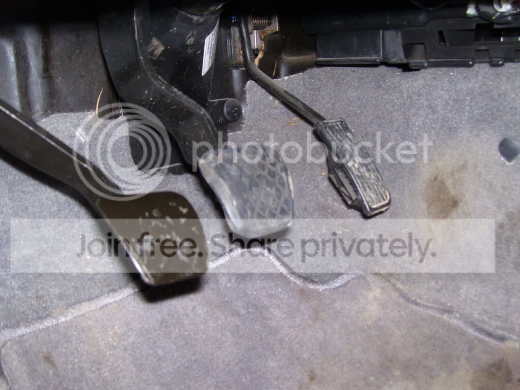

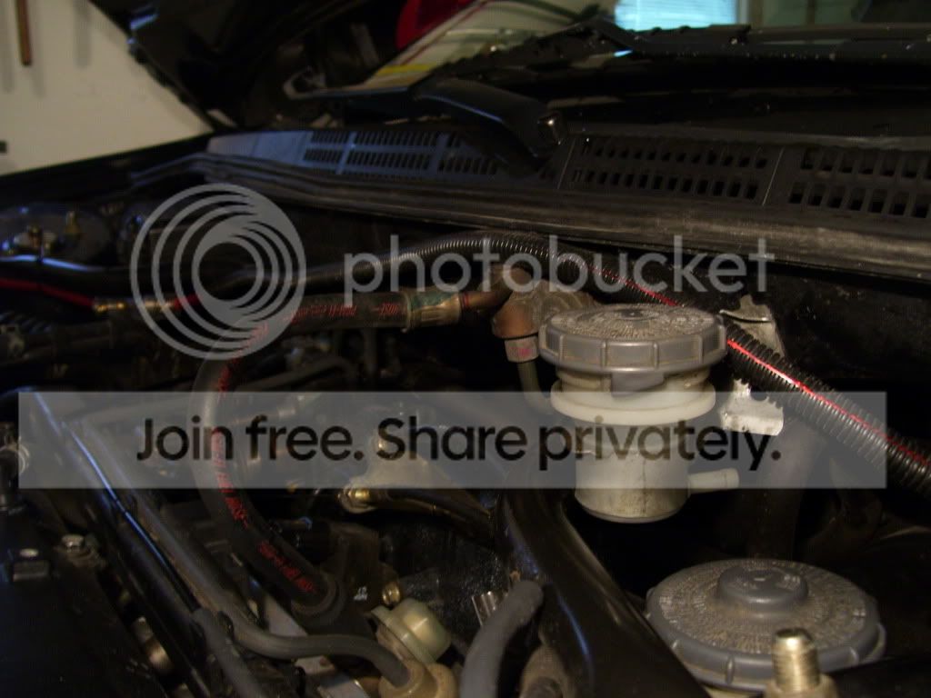

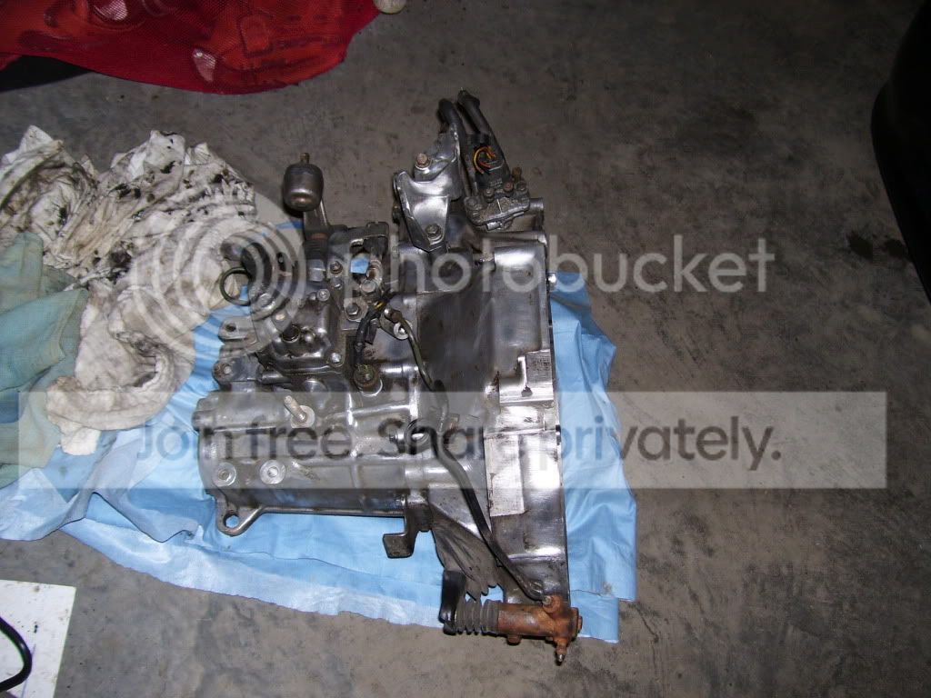

well installed clutch pedal/master cylinder and the resevoir last night. cleaned up the transmission yesterday too since it was a big chunk of grease and dirt. now its shiny <3
Also i have almost everything to swap. Waiting for axle to arrive and the intermediate shaft (also called the Jack Shaft?) i hope to go down to the junk yard and get on monday. and then i just need clutch lines and a couple bolts and then i'll be ready to swap! :D
Lol, why does everyone mount their clutch pedal crooked or off. Once you have your 5spd, it's going to be a complete different car! You will fall in love with your car all over again. It's the best thing ever!
Lol i know, i fixed it a little bit. its almost perfectly straight now. I know dude, im so excited! haha

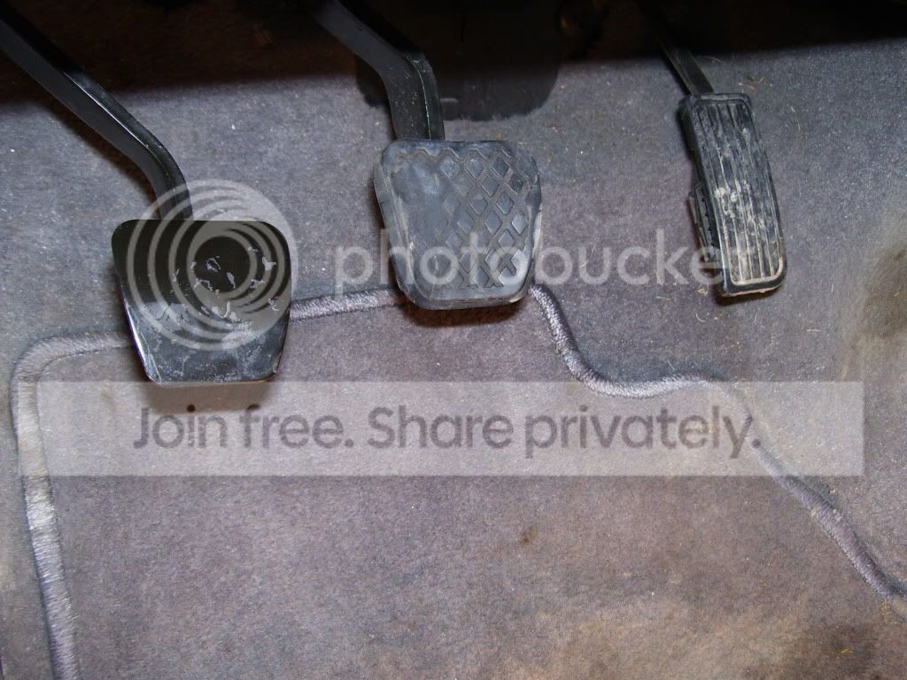

you think thats crooked lol?! you should see mine...i couldnt find a 6th gen pedal anywhere....first i used a 5th gen and it broke on me im guessing cuz of my stage 4 clutch and its oldness and now im using a 99 CL pedal....which also feels like its about to break and doesnt mount straight at all...i had to put a spacer on one of the nuts to angle it dats how bad it is.....you pedal lookz lik it came from factory lol
His pedal looks factory? lol. Here is a decent picture of my 5spd swap pedal. Picture is kind $hitty. I'll take a better one tomorrow.
