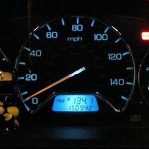

I just finished installing my Pioneer AVH-P440BH, and when I started my 2002 honda accord coupe 4 cyl, the SRS light was on! I haven't seen it before! I ran my ipod wire near the SRS control box, and i bumped that little piece of transparent plastic that is over it. Could've that set it off? I also removed the wiring harness that connects the tail lights (the one in the dirvers side fuse box) so I could wire in my reverse signal to the harness. I noticed that when I had the connector unplugged i didn't get the familiar honda "Beep beep beep" when the door is open and the ignition is on ACC. Once I plugged it back in the "beeps" continued beeping again. could've that set off my SRS light?
Also my battery died, but I don't think that would've set it off. I have seen the threads on how to reset the SRS light. Should I go ahead and do that? Or should I have it taken into the dealer to have them check it out? I want to make sure that my car's airbags are safe in the case I would get into an accident.
What would you do?
