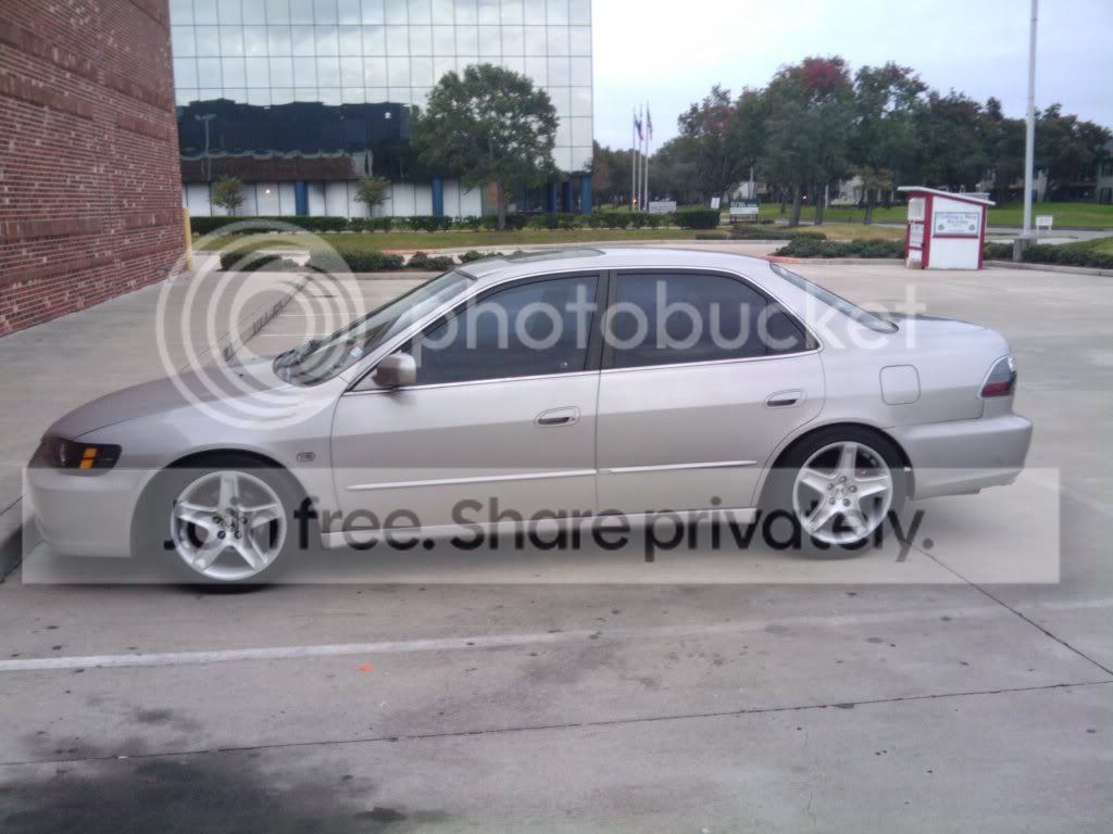

Brand & model:Tokico HP Shocks(Blues)
Price paid and from where:$300 Shipped From eBay,cant remember the seller name.
Pros:Better than OEM.
Cons:Kinda Soft when paired with Lowering Springs,but like most ppl say it isnt really meant for lowering springs.
Final verdict:Love it,cant really complain bout this setup.
Brand & Model: Ksport GT Lowering Springs
Priced Paid and from where: $154 Shipped from eBay from a seller called StreetRays.item was shipped same day and i got it the next day cuz hes a TX seller www.streetrays.com
Pros: Really good quality springs and give u a god drop.
Cons: None at all
Final Verdit: I absolutely love them and will recomend to anybody wanting lowering springs,Gives u a good amount of drop F 2.25 R 2.5 cuz all i had was 1 finger gaps on 235 45ZR 17 tires and none on 235 45R 17 tires.
