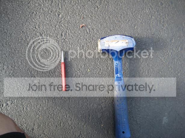

Hello, this is the 2nd time I have removed 8 of these pesky rotor screws and I used a method today that I have seen others do it but I couldn't believe how easy it really was. No drilling, no cursing, just 2 tools needed:
I don't even know what you call that thing on the left but that is a Eastwing sledge on the right, I think you can use a smaller hammer of course as well as maybe a strong philips screwdriver but hey use the right tools man!

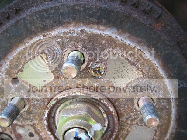

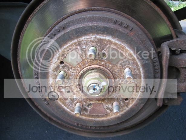

Here are what the screws looked like before I got to them. Nice and frozen:

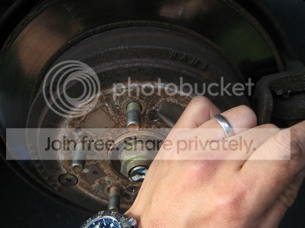

You basically hit it at an angle to create little dimples and try to manually force the screw to turn counterclockwise:

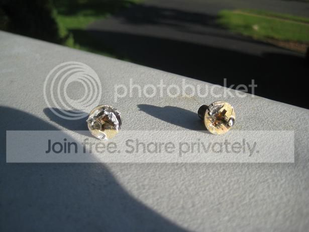

Almost there:
OUTTAY:

Little thing on the left looks like a nail set, or nail punch. Actually for installing floor or chair moldings in a house, lol.
