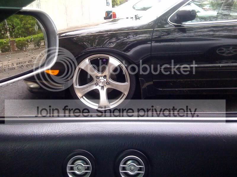

Yeah....
helped my boy finally drop his infinity.....
