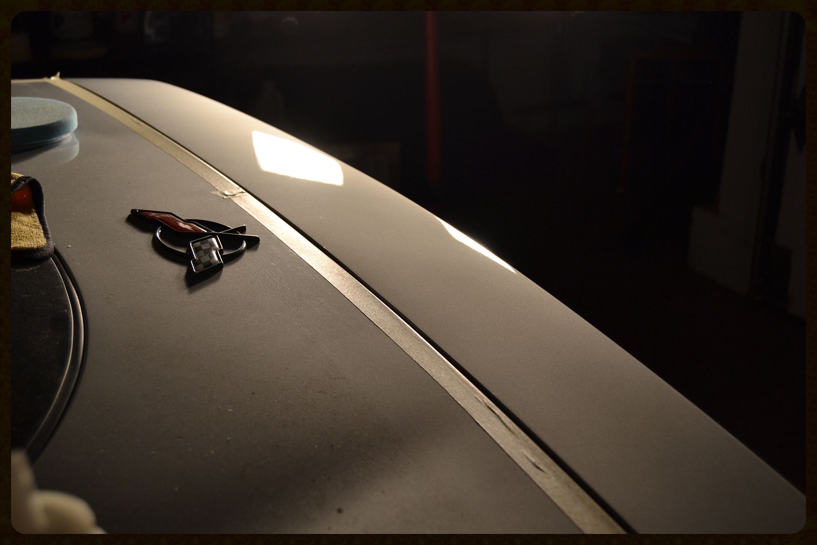

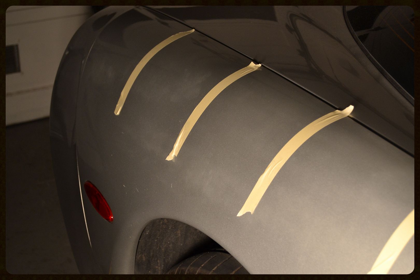

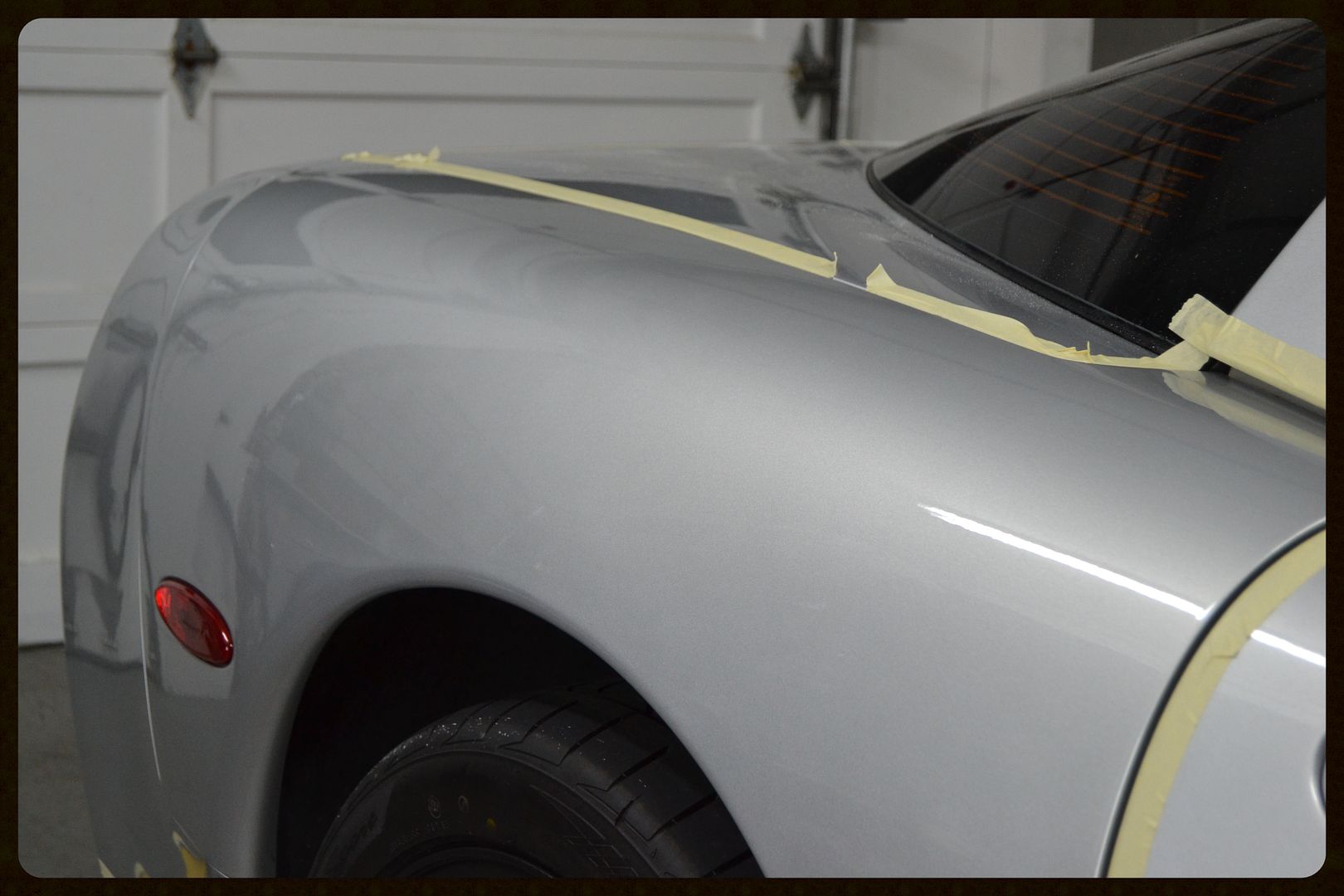

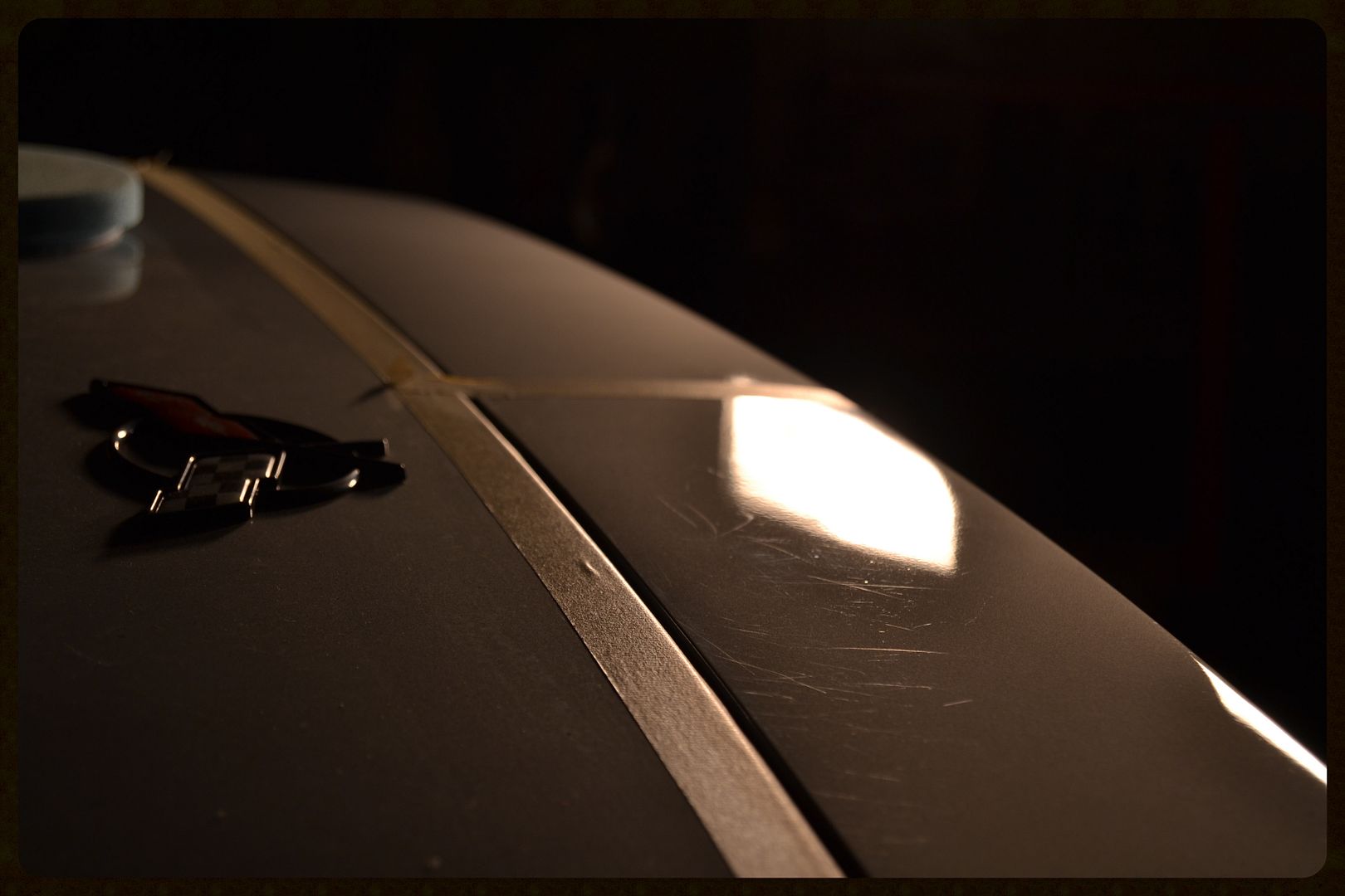

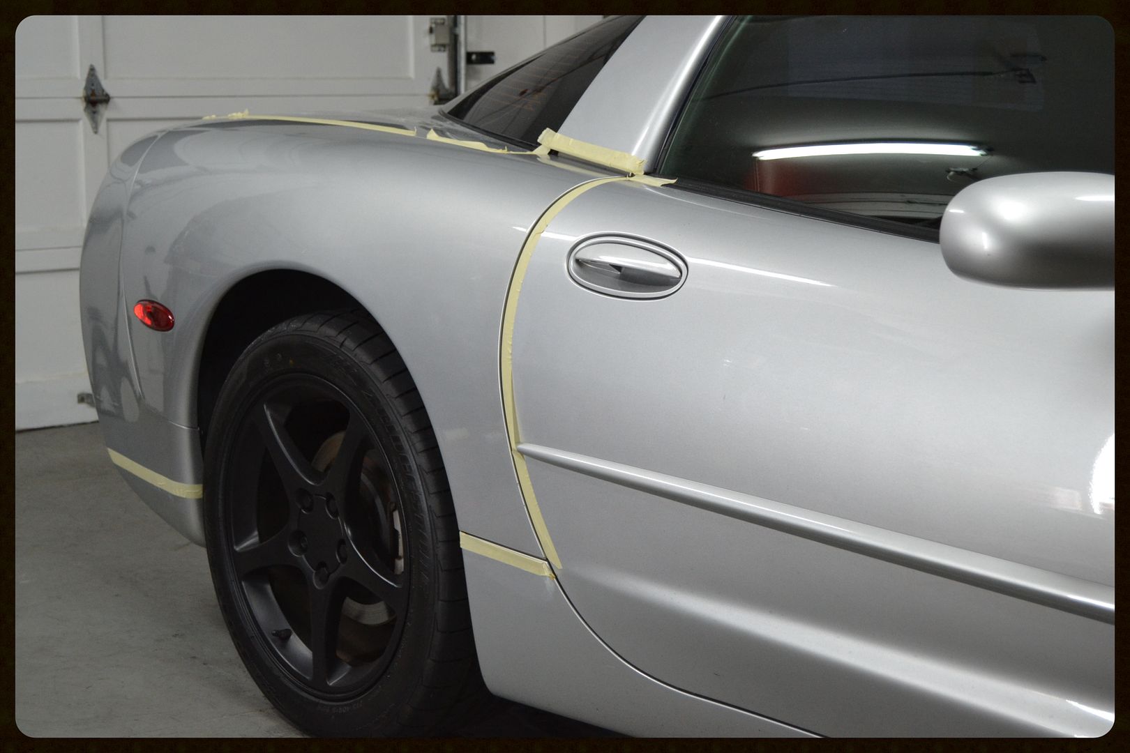

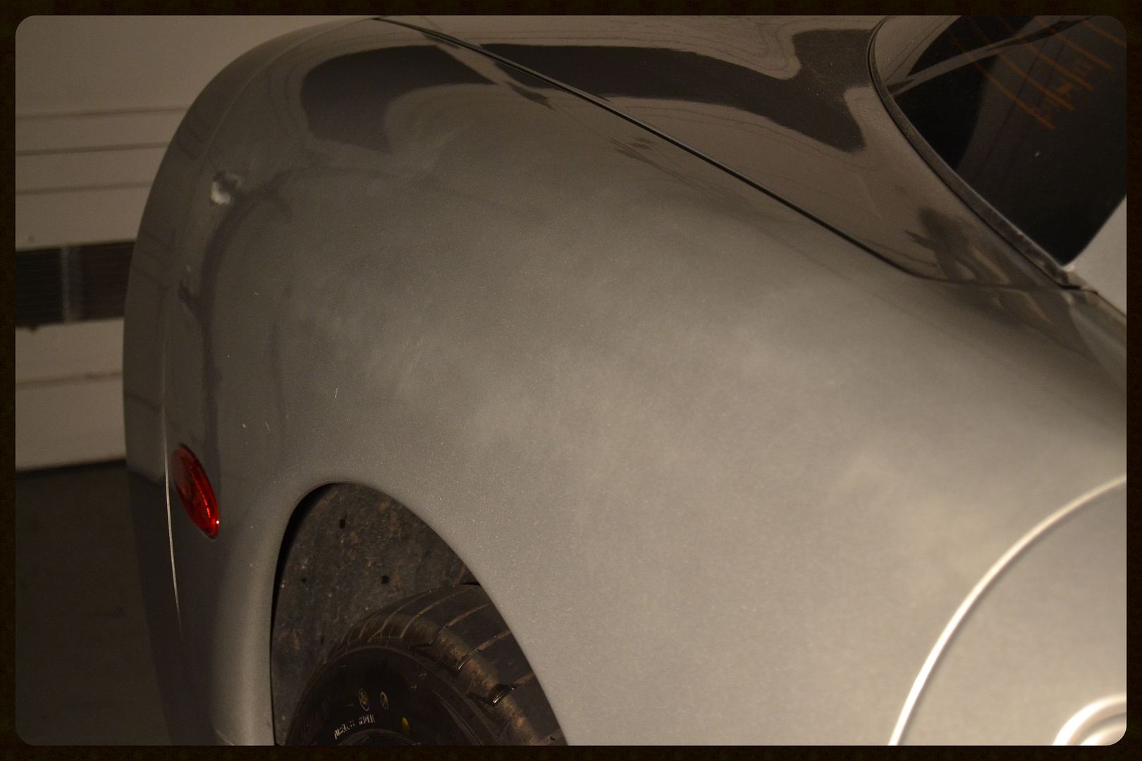

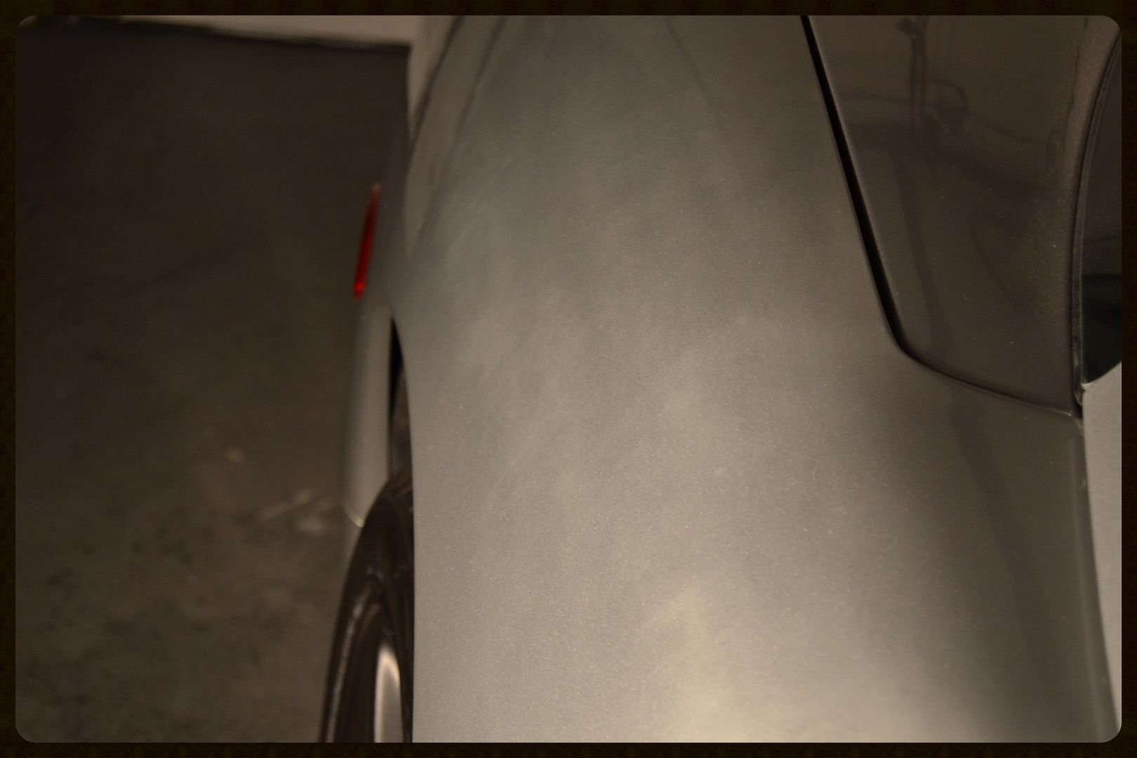

Also did a 2 step paint correction on a friends 01 corvette quarter panel and rear bumper. It was poorly resprayed with single stage paint, and it's showing really bad oxidation. He decided he wanted to keep it until the summer so I told him what his options were, and we decided a coating was the best choice to prevent the oxidation from reoccuring.
Here's what I had to work with

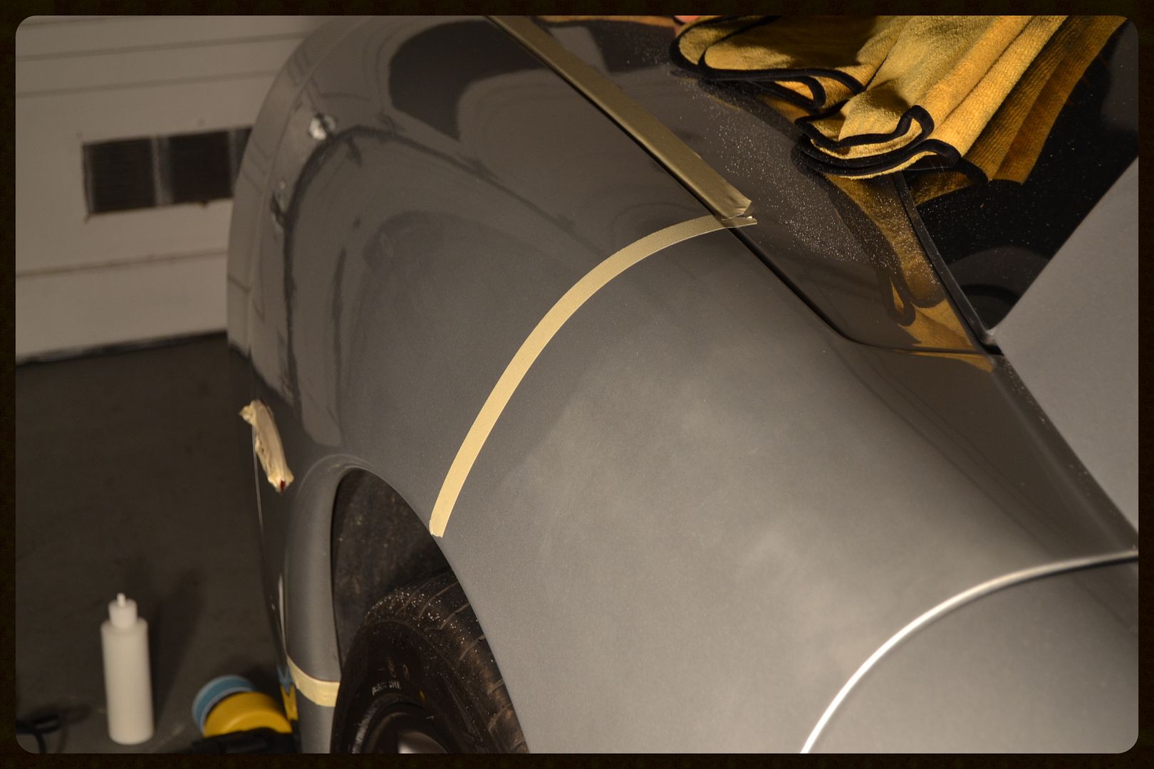

Setting up my test panel to see which combination would yield the results I am looking for
Settled on a 2 step paint correction. 50/50. Gloss & Shine is coming back
Finished up and coated with Opti Coat 2.0 Letting it cure for 12 hours before letting it be exposed to the elements
Process:
Wipedown with Optimum No Rinse
Clayed with Nanoskin Fine grade sponge w/ONR as clay lube
Meguiars DA/Menzerna Super Intensive Polish/Cyan Cutting Pad
Meguiars DA/Menzerna Power Finish/White Foam Pad
Carpro Eraser for wipedown to remove all silicone, and oils from polish prior Opti Coat
Apply Opti Coat
(Total Time Spent):1hr 30mins
Any comments, questions, or suggestions, feel free to leave a remark. Thank you for viewing.

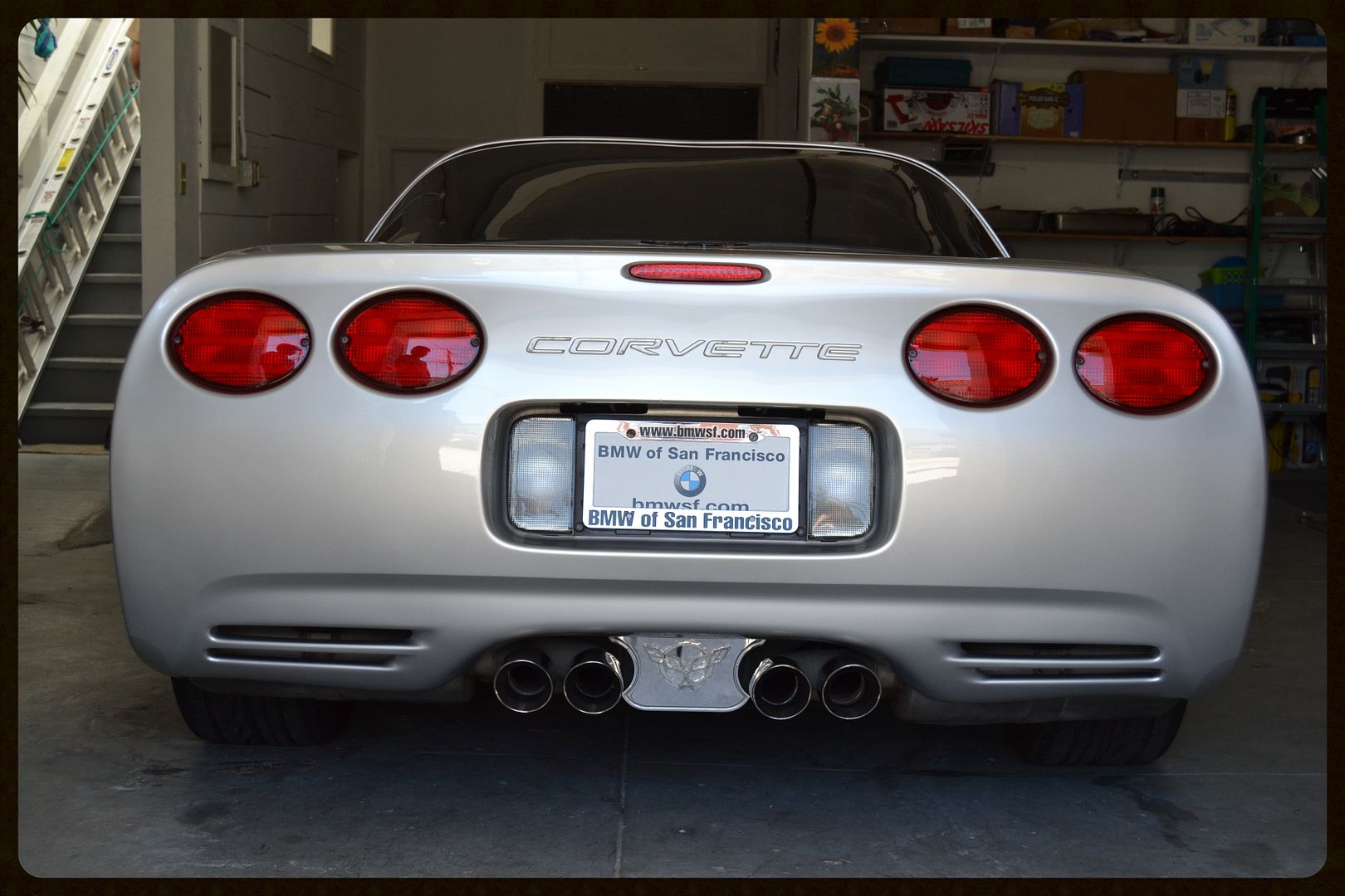

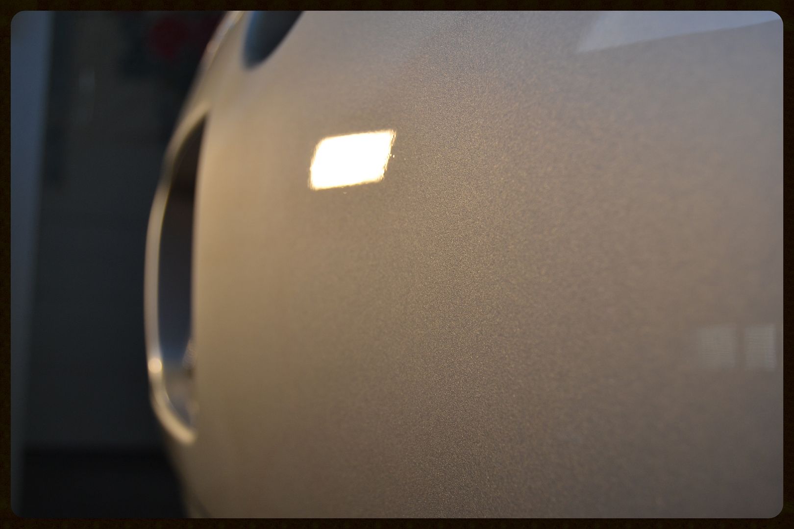

Finished Part 2 of polishing this morning with the rear bumper. The clear was much harder on the rear bumper so I had to adjust the aggressiveness on this panel. OEM clear coats on corvette are known to be rock hard, and it requires a more aggressive approach to level the paint, and will take much more section passes to correct compared to soft clear coat like Hondas.
Starting with the top of the bumper
Done
On this silver metalic color, it was very hard to capture defects with my camera so I only have this finished picture of the rear bumper
Very nice pop from the flakes
Completed rear end

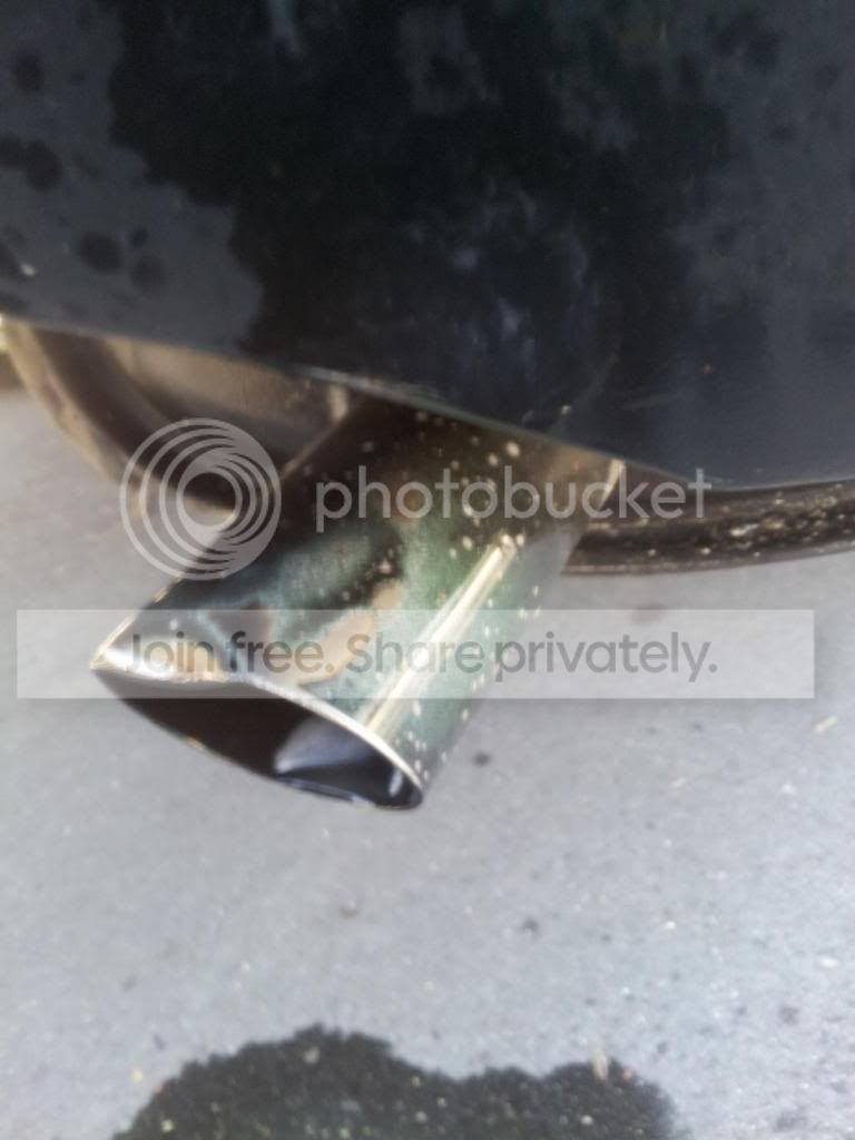

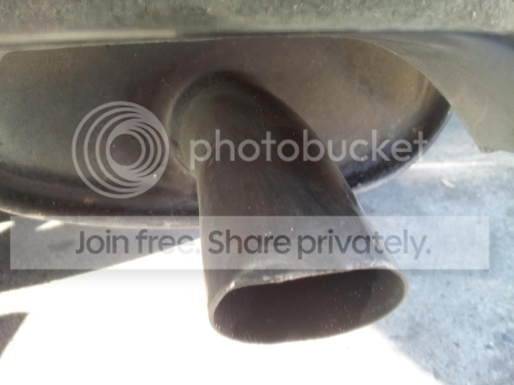

I polished my exhaust tip, for one reason or another it was painted the same color as my car.
[Tools used]
* 60 grit sandpaper
* 140 grit sandpaper
* 2000 grit sandpaper
* water
* Elbow Grease

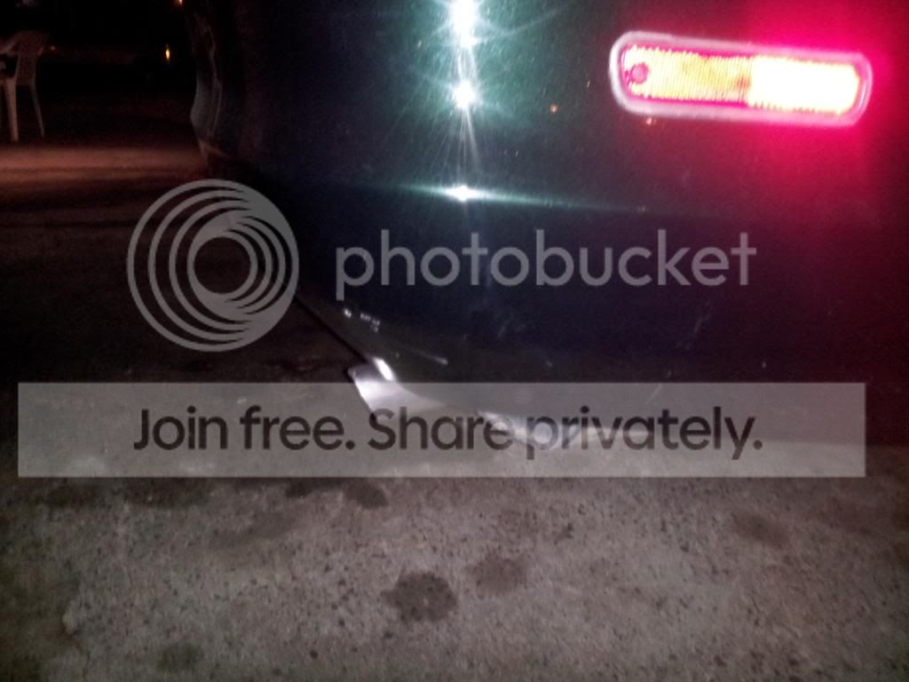

Okay, about a month ago i noticed it was paint on my exhaust tip i took some steel wool to it; I didn't finish obviously. so this how i left it.

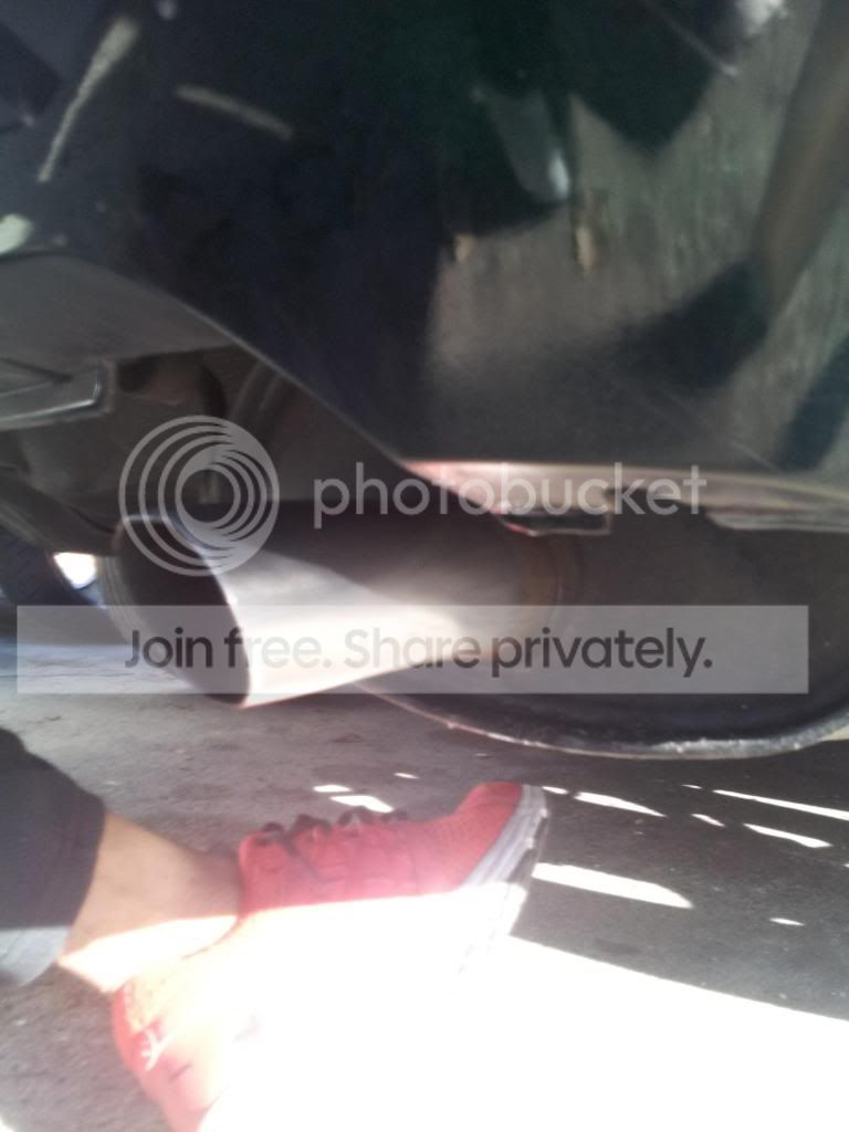

After wetsanding with 2000 grit for about 20min.
I was getting nowhere fast until i remembered that the dollar store sold sandpaper.:hihi: but about 5min of dry a sanding with 60 grit.

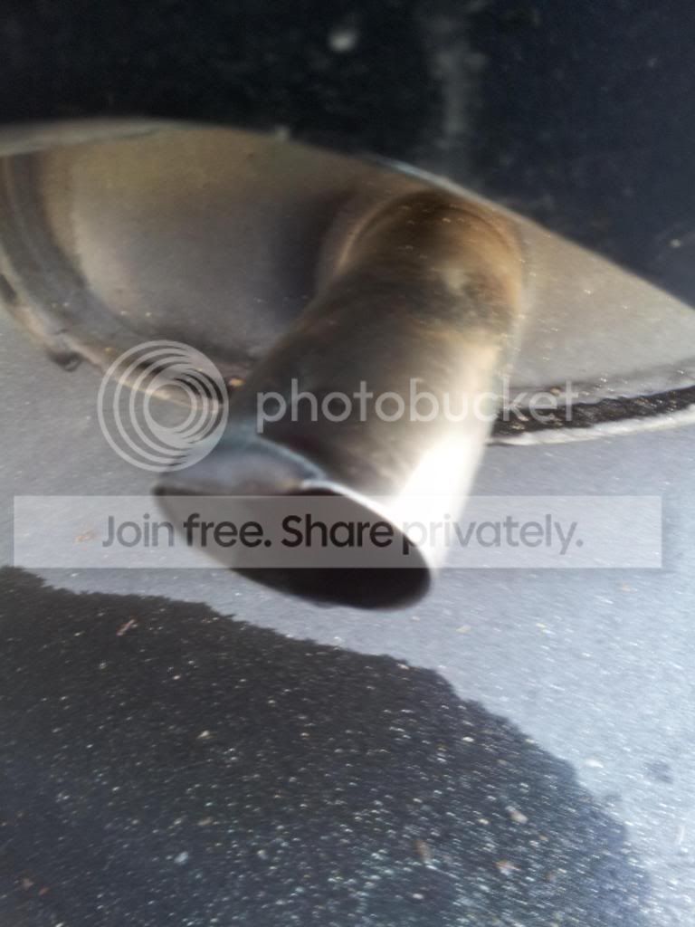

5 min of sanding with 150 grit.

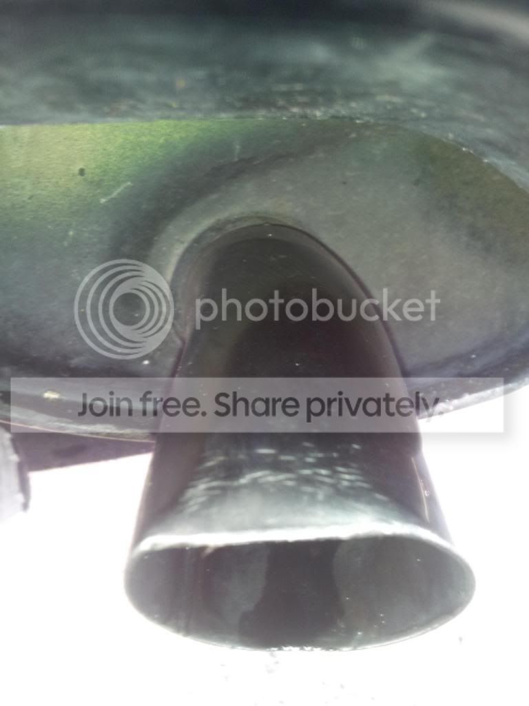

I wet sanded with 2000 grit again to finish.
The end result.
:GetMoney:
