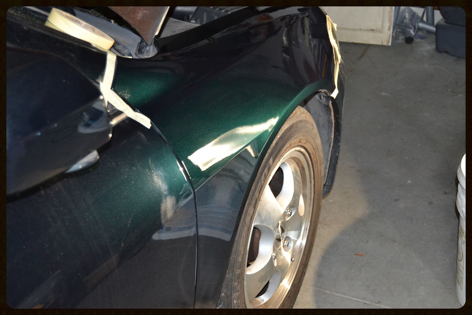

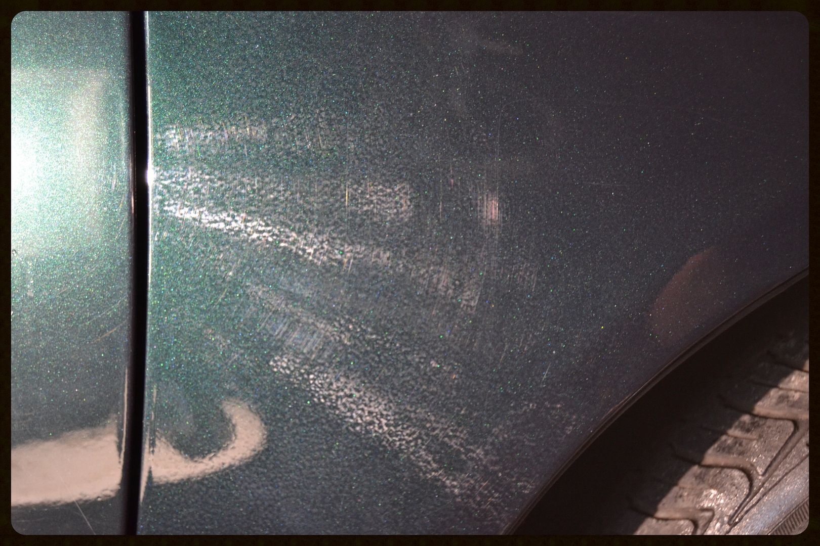

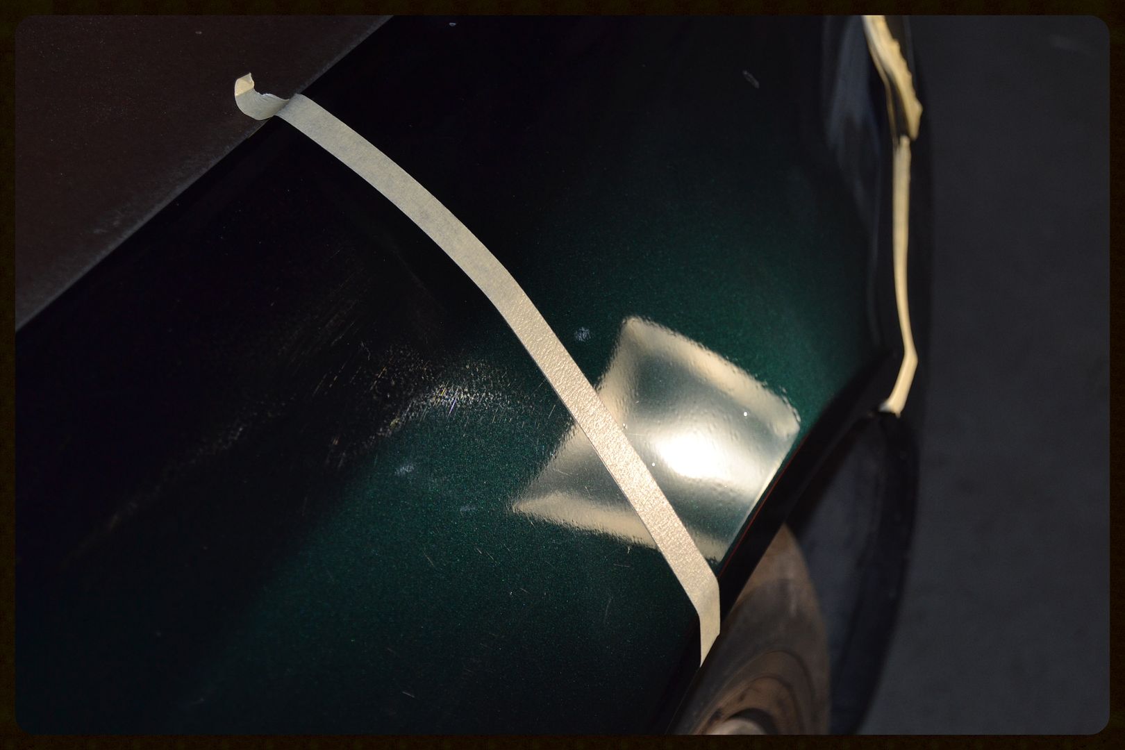

Starting to correct the paint on my auto accord to get it ready for my sister. Started with the fender today.
Starting condition
Half way done
Done
Applied Opti Coat Coating
Process used:
Wipedown with Optimum No Rinse
Clayed with Nanoskin Medium grade sponge w/ONR as clay lube
Harbor Freight Da/Menzerna FG400 compound/Meguiars Microfiber cutting pad
Harbor Freight DA/Menzerna Power Finish/White Foam Pad
Carpro Eraser for wipedown to remove all silicone, and oils from polish prior Opti Coat
Apply Opti Coat
(Total Time Spent):1hr 15min
Any comments, questions, or suggestions, feel free to leave a remark. Thank you for viewing.

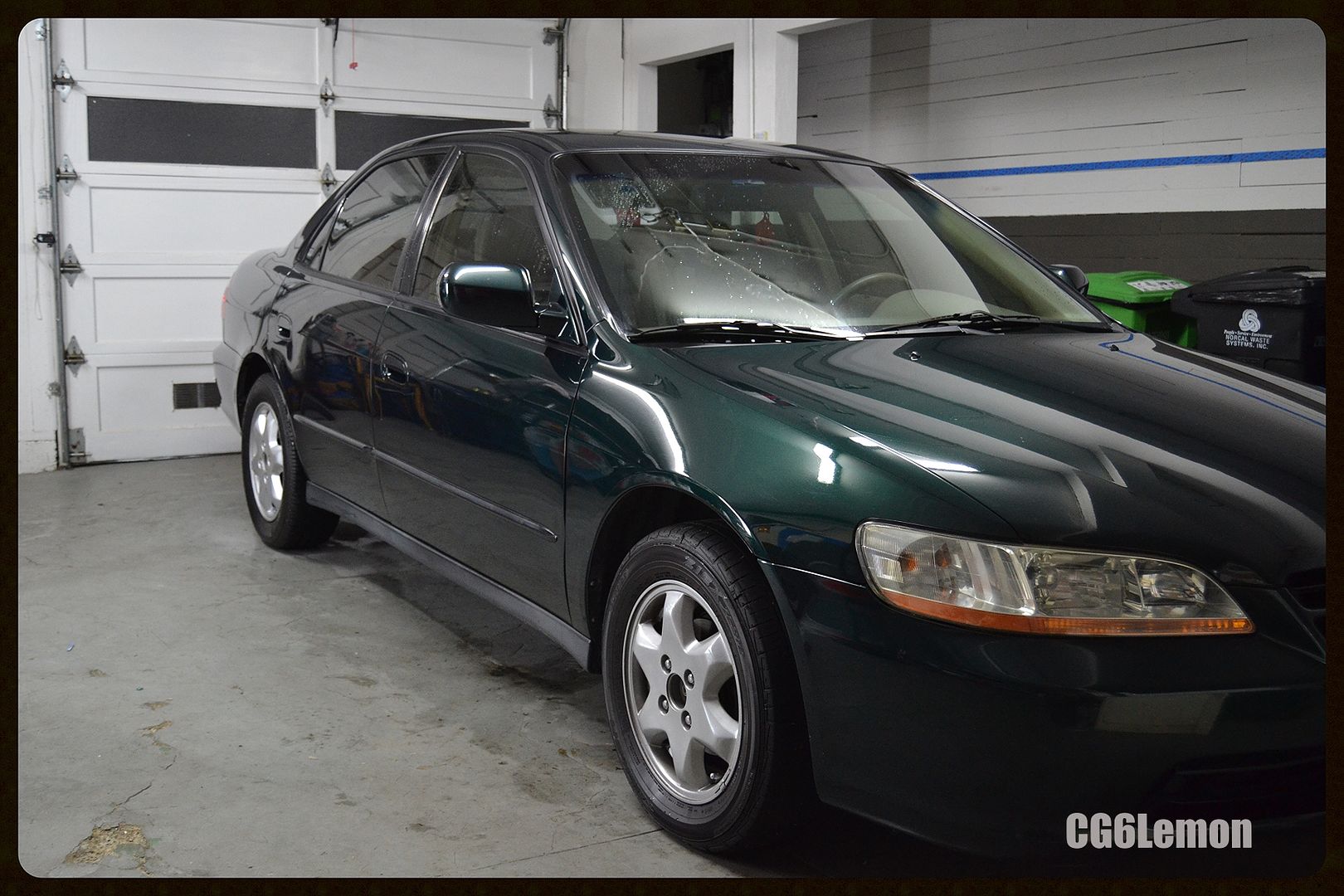

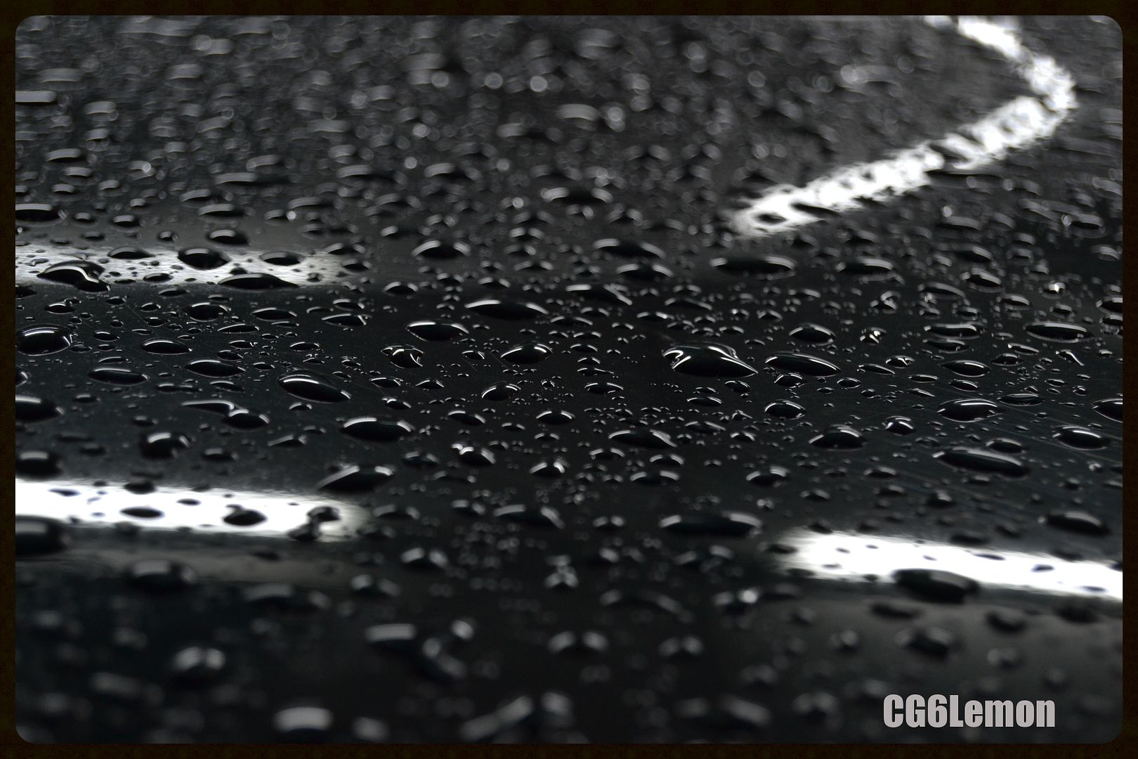

It was raining today so I had a chance to inspect the protection on my paint. Wasn't too happy with the beading from the sealant so I decided to clay it and apply a new layer of sealant. The last time I applied a sealant was 3-4 months ago so I guess not too bad.
Still some decent beading, but not happy with it
After prep and applied new layer of sealant. Woohoo tightness returned!
Not bad of a shine with just a decontamination, and sealant. Did not do any polishing yet...
Process:
Clayed with Nanoskin Fine grade sponge w/ONR as clay lube
Dried it off
Applied one layer of Wolfgang Fuzion Sealant using cross hatch pattern technique to ensure even coverage
Let it cure for 30mins and buffed off
