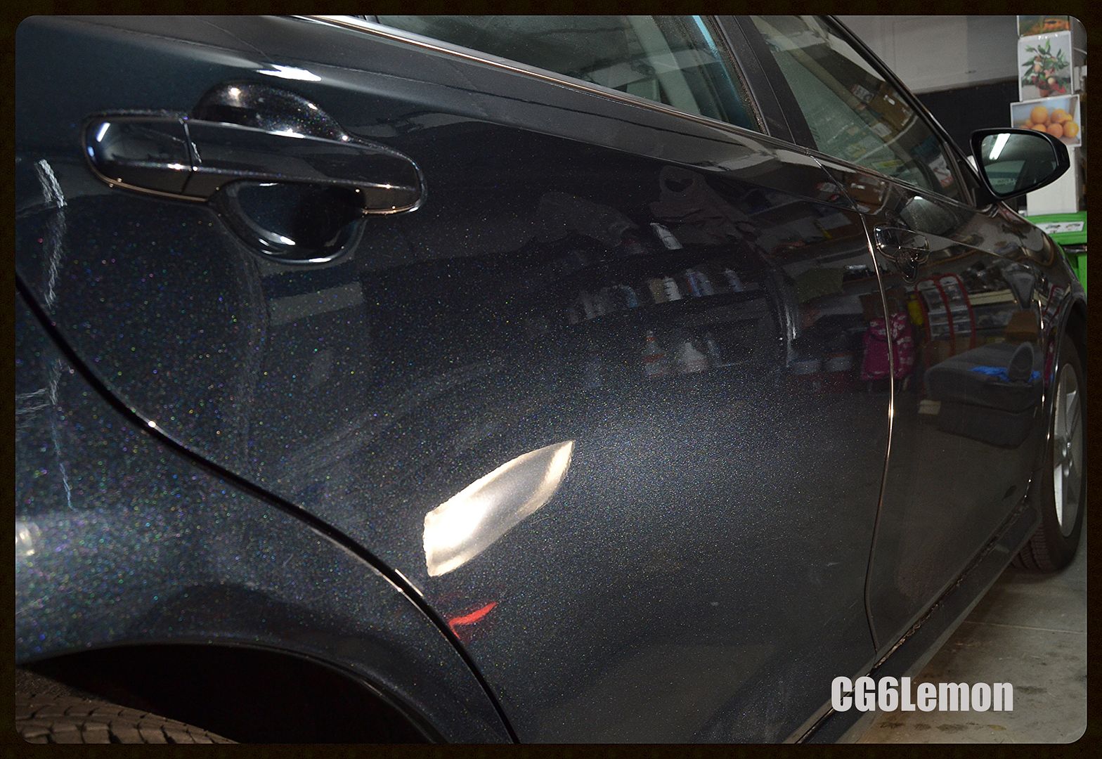

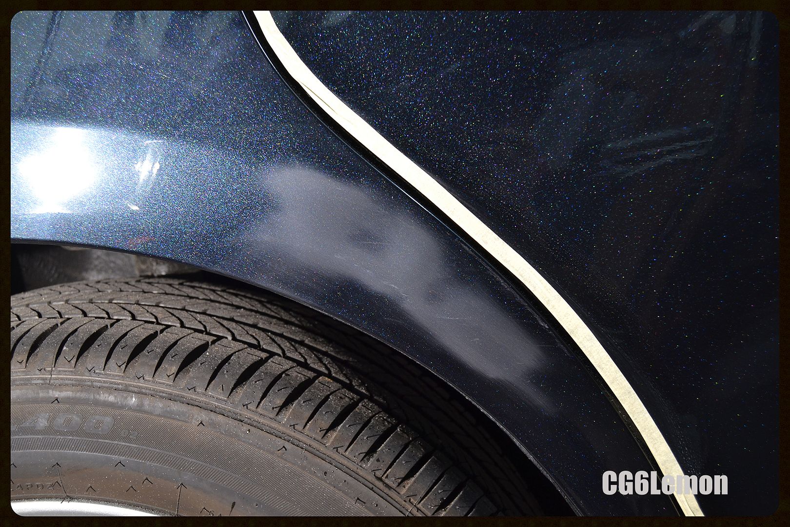

Car condition on arrival

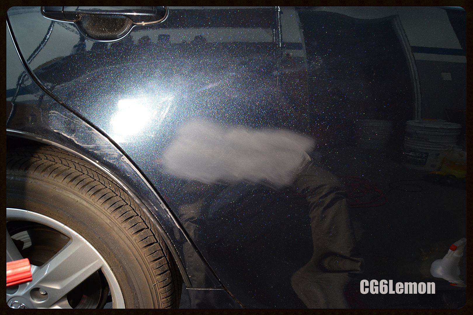

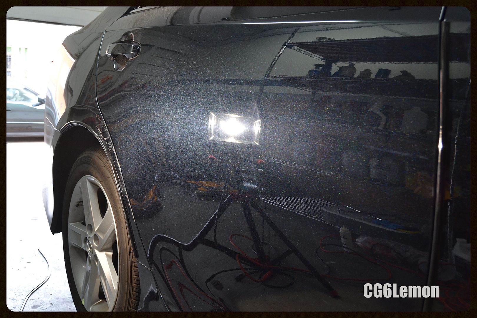

Started working on half of the door.
*Process:
Harbor freight DA w/ 3" Meg MF pad & Meg 101 compound @ speed 4.5

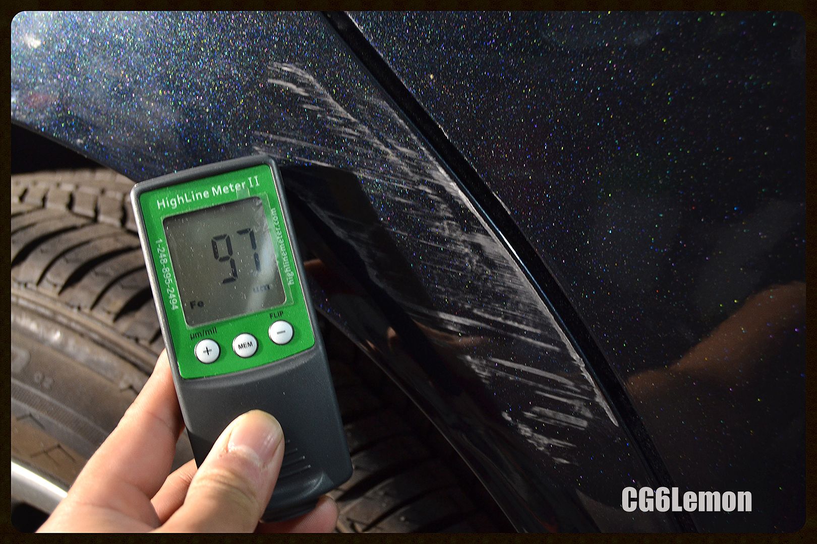

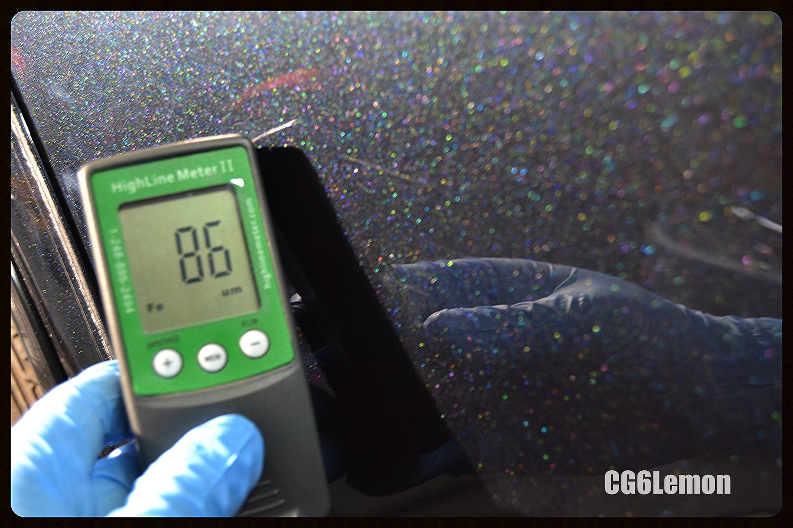

Knowing this car was bought brand new and no previous signs of respray, the paint had healthy readings ranging from 90-130 microns.

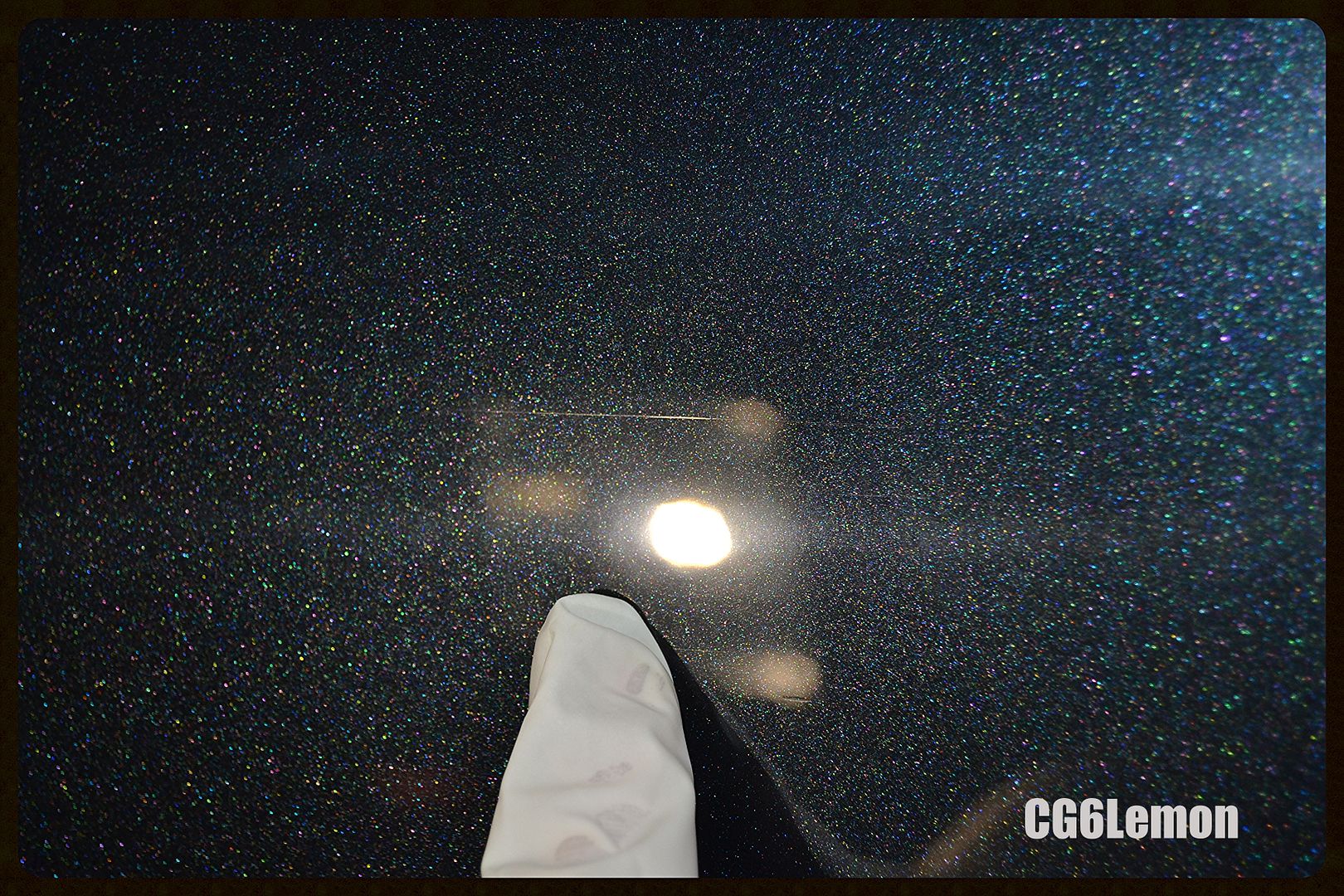

Same section zoomed in. Only left with one scratch that I did not chase.

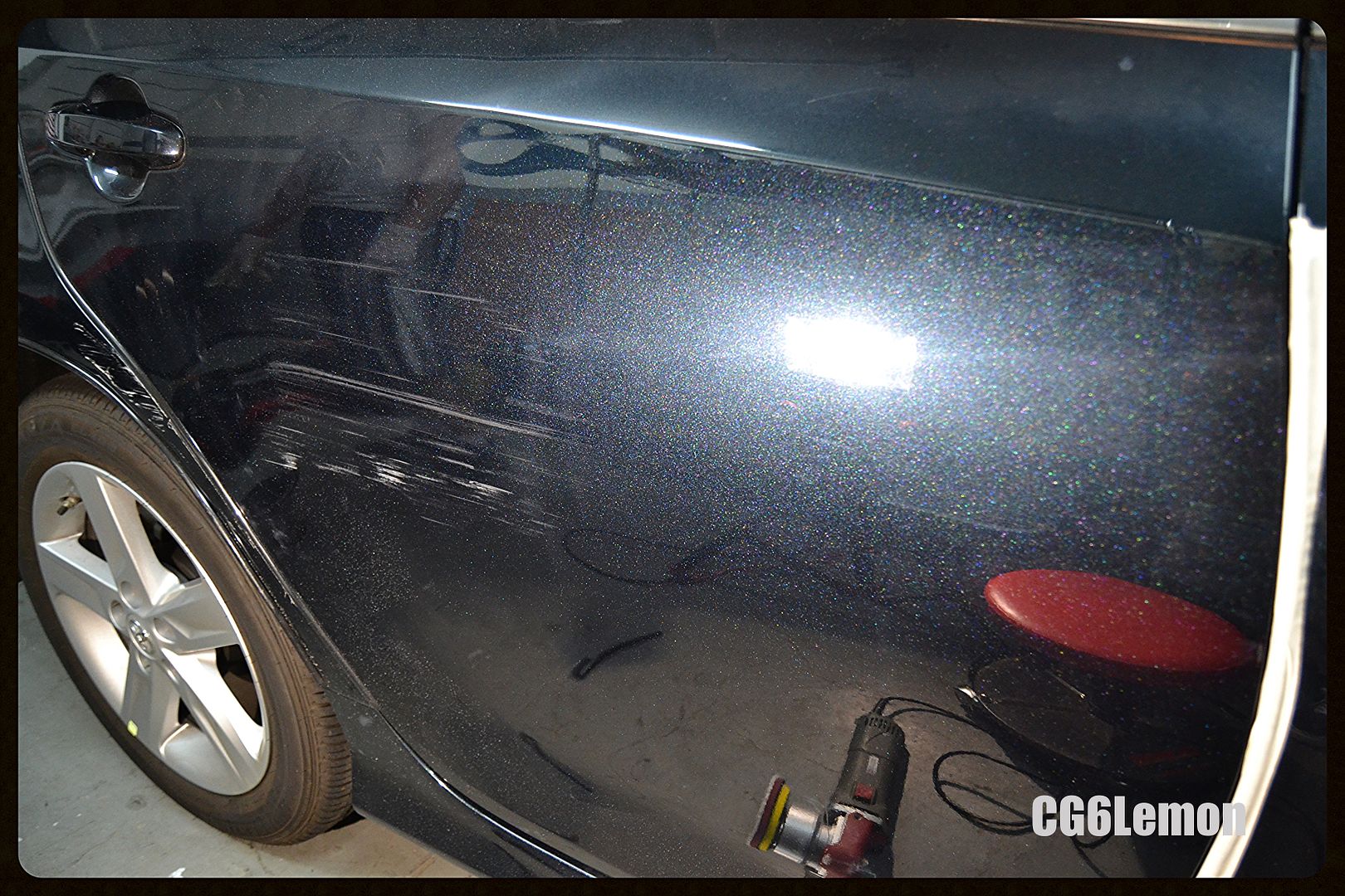

Now I am left with the left side which have deeper scratches to remove/level
After using the same technique as above, I am left with the deeper marks.
Whole shot of door
Although it is a huge improvement compared to before, I knew there were still room for improvement.

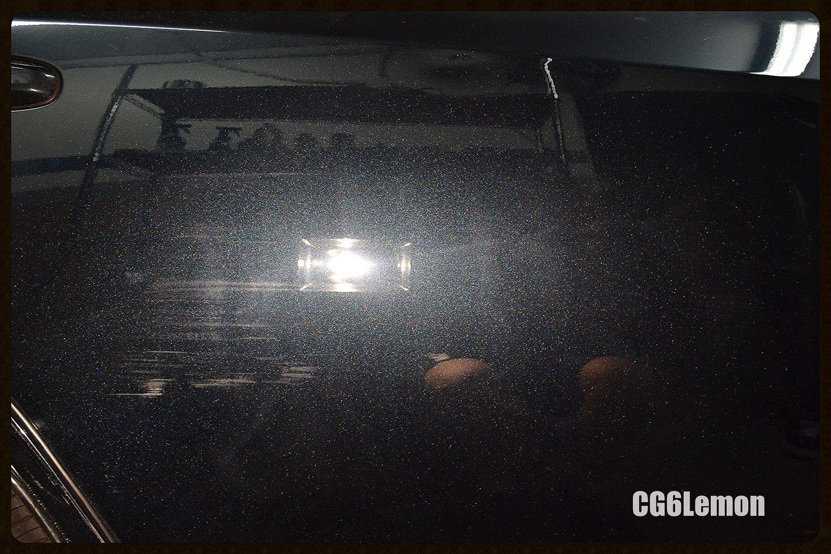

*Process:
Damp sanded with 2500 grit then refined with 3000 grit
After compounding, ended up with this

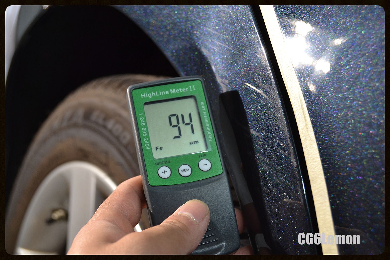

I took some readings, and made a decision to chase a little bit more with the scratches so I damp sanded again with the same process.
Another round of compounding, and I end up with a result that will pass my standards.

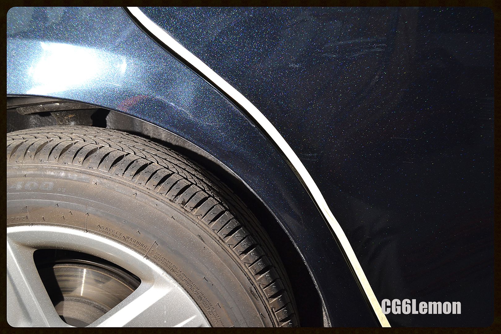

Because of my decision to chase the scratches, I had to sacrifice some clear to reach my goal.
Couple pics of the door all finished up. I still need to refine the paint with polish.
*Process:
Whole shot of door
