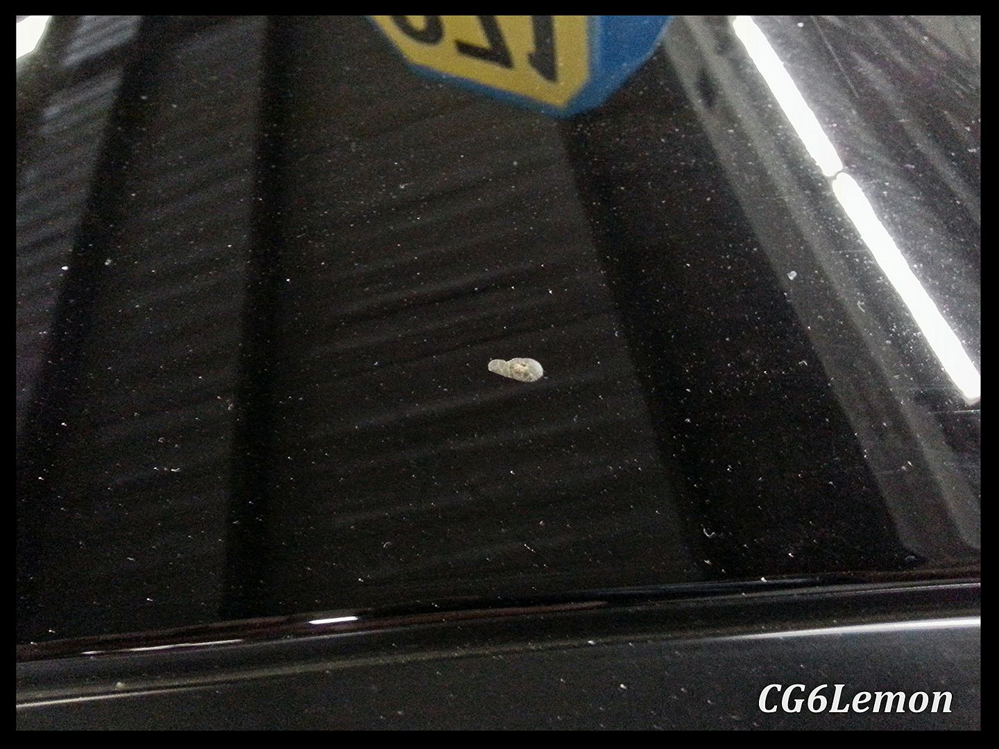

How to remove tree sap using solvents
What is tree sap? Tree sap is a sticky substance seeping out of trees which in turn falls onto a vehicles surface if parked within it's vicinity. There are many methods/techniques to removing tree sap, but I am going to cover using solvents for this topic. Any type of solvent such as paint thinner, mineral sprits, acetone, etc.
Step 1: Identify the surface area of the sap
Use your eyes and see which areas are covered with tree sap. Different surface areas require different approaches. It may be on paint, glass, soft top, vinyl top, and plastic.
Step 2: Identify it's hardness with touch
Use your finger and touch the tree sap to determine how old/how long it's been on the surface of the vehicle. The softer/fresher, the easier it will be to remove, and vice versa.
Step 3: Choose a method and attack
I chose to use solvents in my approach.
Step 4: Inspect for further damage caused by tree sap
The tree sap I'm working on is on the paint surface. The tree sap feels hard to the touch which means it's been sitting for a while.
I used a hair blower to heat up the sap for 2 mins at a close range, but don't hold it in one spot for a long time. Use a left to right sweeping motion and keep it a couple inches away. Then I grabbed a waffle weave towel and applied some paint thinner to the corner of the rag and let it sit on the sap for 20 secs. Afterwards, carefully scratch at it with the towel to break it apart. Rinse and repeat.
After about 3mins I finally broke through the tree sap and it shattered in pieces.
Afterwards inspect to see if the tree sap did any damage to the paint. I made some scratches during the process so I hand compounded and polished the scratches. Other than that I did not see any further damage.

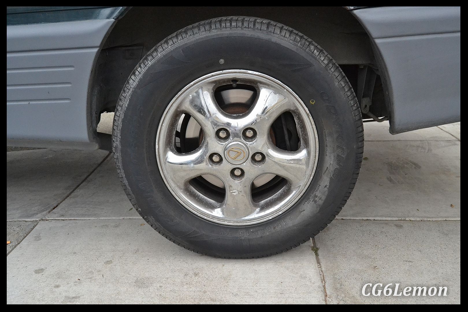

Why Chrome Finish wheels are not real chrome
l wanted to clear the misconception that some people might see a wheel in chrome finish and think it's real chrome. The chrome finish is actually a "very" thin plating. If not maintained properly and cleaned on a weekly basis the finish can be damaged quite quickly. I have a couple of pictures to demonstrate what can and will happen if neglected.
Pics of wheel being used as an example
Medium stage of damage. A lot of pitting from brake dust and heat. This is unrepairable unless brought to a wheel refinish shop.
End result. The thin plating chipped off.
Thanks for viewing. Welcome any comments or input.
