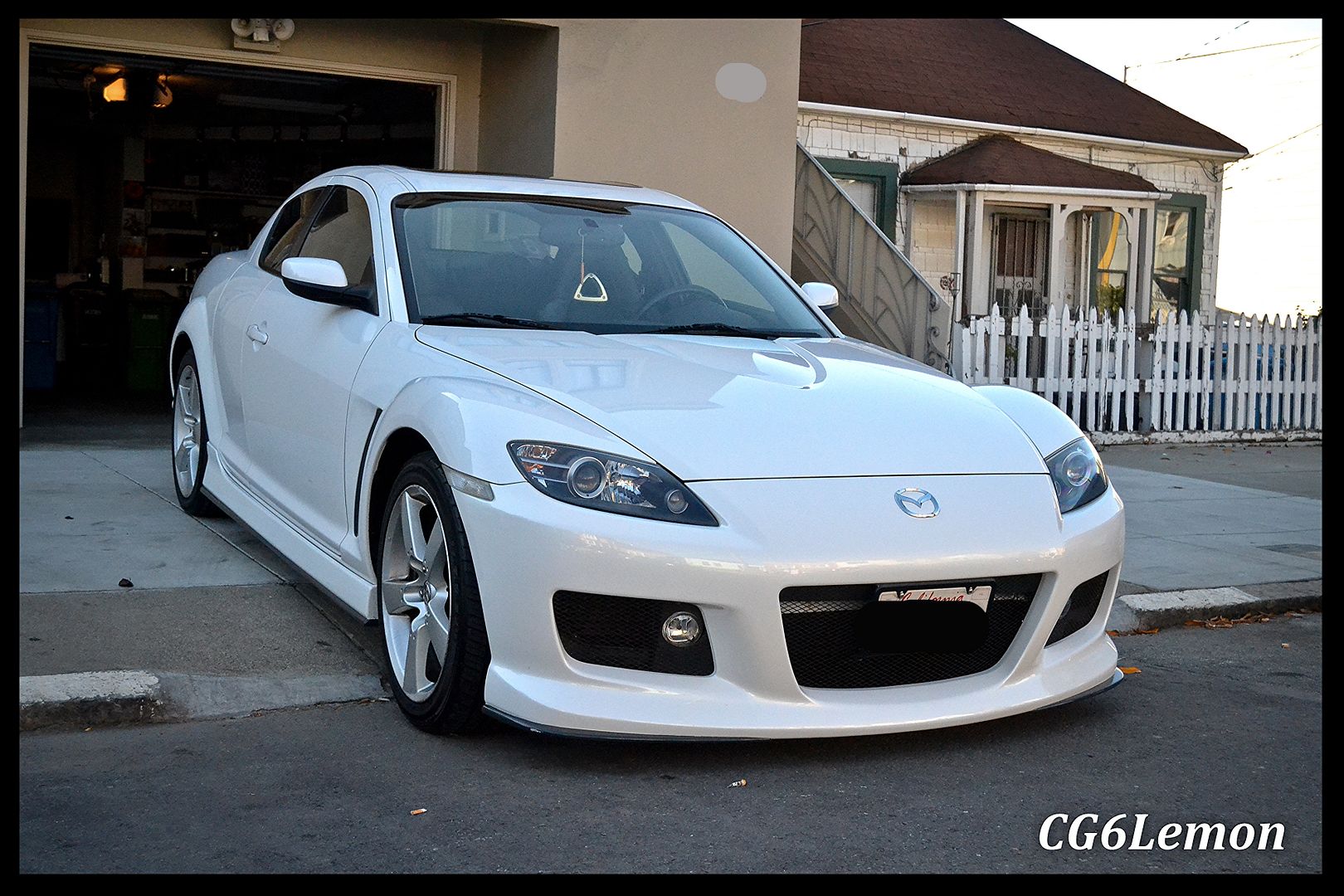

Car: 05 Mazda RX8

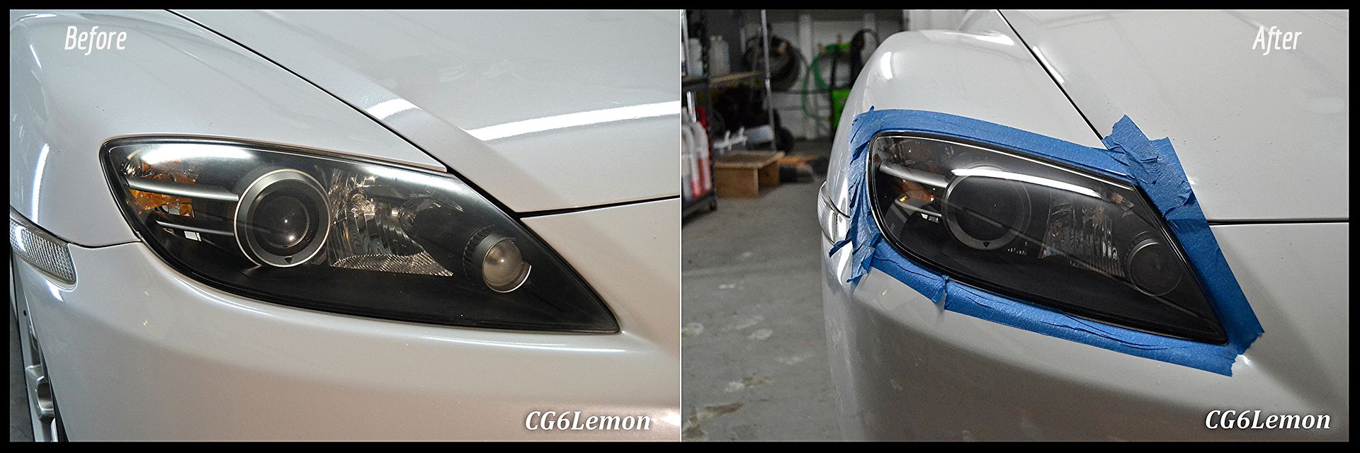

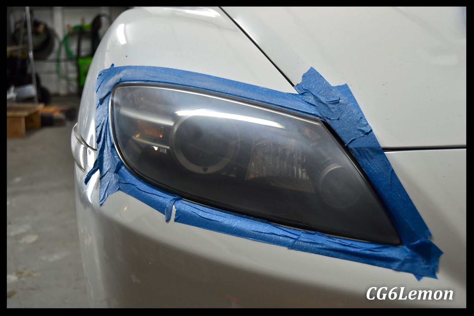

Started off correcting and restoring the headlights first. Taped off ready to go
Ran into a minor circumstance that I did not factor in for the quote. My 3 inch sanding disks were not able to reach the corner of the headlight design. I sanded by hand and polished by hand
Dry sanded 800, wet sanded 1500 and 3000
Before and afters
Other side

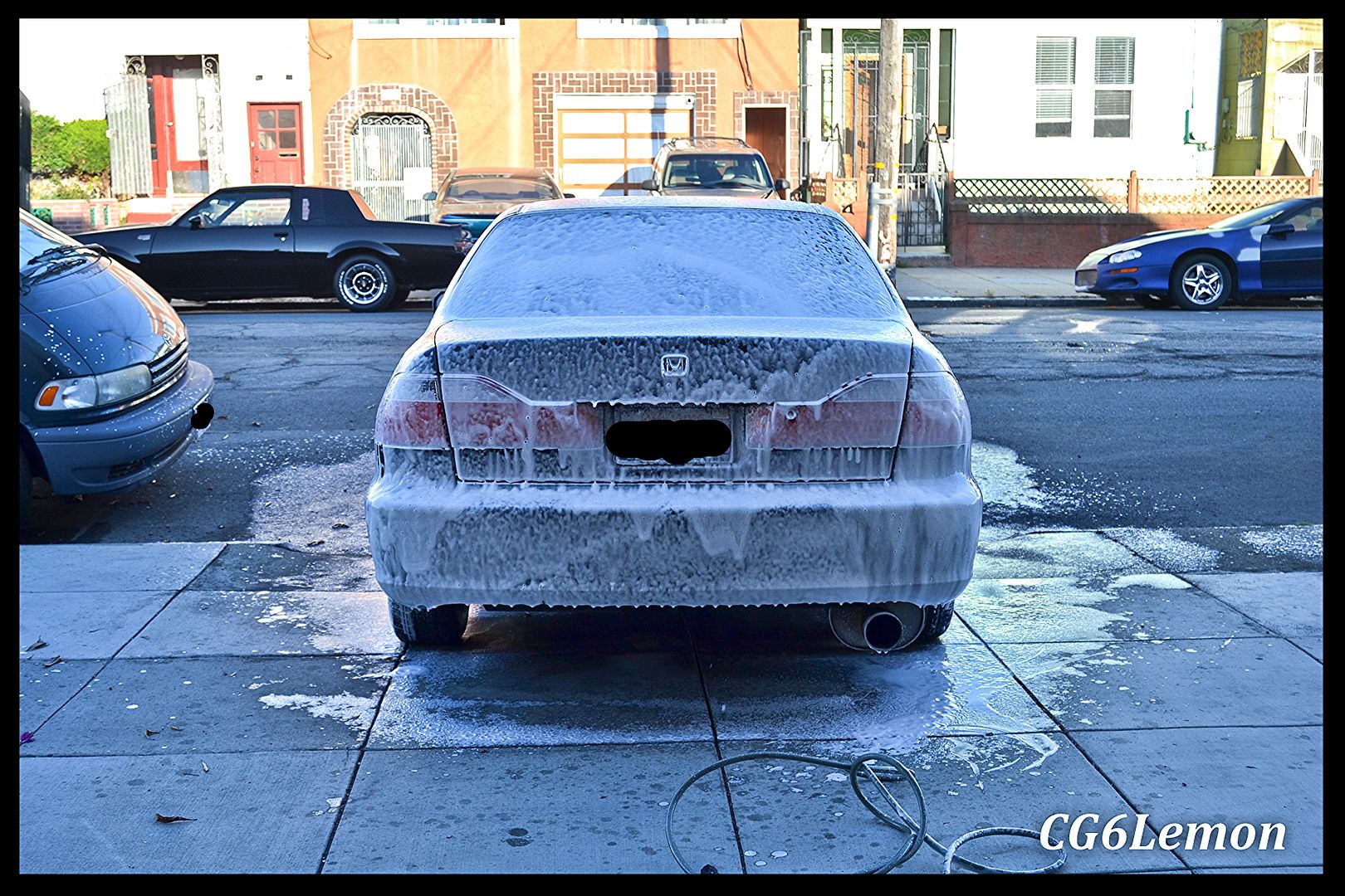

You have a pic of washing your car Accord914? Here's mine from this weekend.
