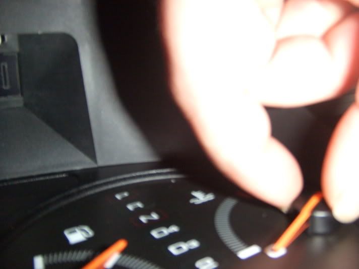

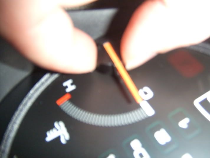

I decided to use the cluster Im selling as a Guinea pig and show u some pix. U need to have ur fingers touching the cluster. As u pull with ur fingers using a closing motion, the tip and part of ur finger will start to push against the cluster. Giving a kinda pull push thing. Its hard to explain but here
NO
YES
Do u see the difference on how my fingers are positioned for the pull? U want to pull by closing ur fingers, not by pulling with ur arm. You should introduce yourself on here. This is a real good community, I think it's the best actually.

I see exactly what you mean Abdi, about how your fingers are positioned. Ad you roll your fingertips down and close them, it puts pressure on the face and thus the needle is pushed away from the face since your fingertips are on it. Leverage action.
