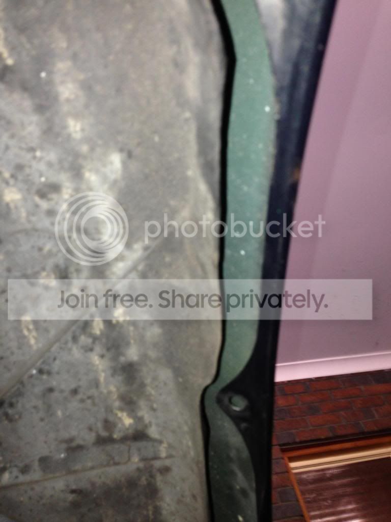

Cut a bit more if you need.
CleanWhiteHonda
Aug 14, 2011
341
Knoxville/ Nashville, TN
Just take an exacto(?) knife and run it parrallel to the fender arch and cut off like the first 3 inches from where the liner is attached to the fender. The picture above is an example of like 5-6 inches cut away. Whatever makes it so you dont rub.. but i wouldnt recommend cutting it all out.

Sleeper Cell actually cut the top section out, and I think there is a rough diagram on V6P about it.
You can always shoot him a pm about it as well.
Well, I never got to do that because my fender liner got ripped out from my wheels and tires actually lol. It should work though.

You could easily have it done though. You'll be able to see where your wheels and tires rub on the fender liner and you can just cut around that so it doesn't rub anymore.
