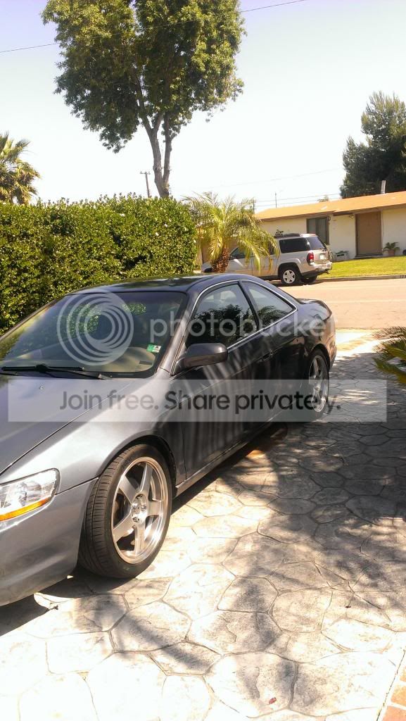

Alright, so I finally had time to adjust my Tein Street Basis Coilovers. My fronts are at the 2.8" maximum drop and I have about an inch left to drop in the rear, but I want the front lower, so they're good where they're at. In all four corners I have about a 1" gap from the tire to sitting flush and between .5-1" from tire to fender.
I have steelies on the front and MSR 029 18x7.5 +45 on the rear.
What I'm looking at after my upcoming five lug conversion:
Front:
18x7.5 +38mm
18x8.75 +35mm
18x8.75 +20mm
Rear:
18x8.75 +35mm
18x8.75 +20mm
18x10.25 +20mm
And I'm also looking for some feedback on my idea of using a bit higher profile tires in the rear to make the front sit a bit lower in comparison.
If I go 18x8.75 all around I was thinking 215/40 in the front and 215/45 in the rear. If you guys think I could fit the 18x10.25 I'm assuming 225/45 would be my best bet.

Scratch the 10.25 off the list. You wont get low enough to pull them off on those
Never put 45 series on a 18.. way to much tire.
18x8.25 +35 with 215/40 will sit pretty flush at your height

Alright, thanks. You think I could pull those wheels off all round without rubbing?
And being about 3" dropped all around, would the 18x8.75 +20 be too aggressive?
