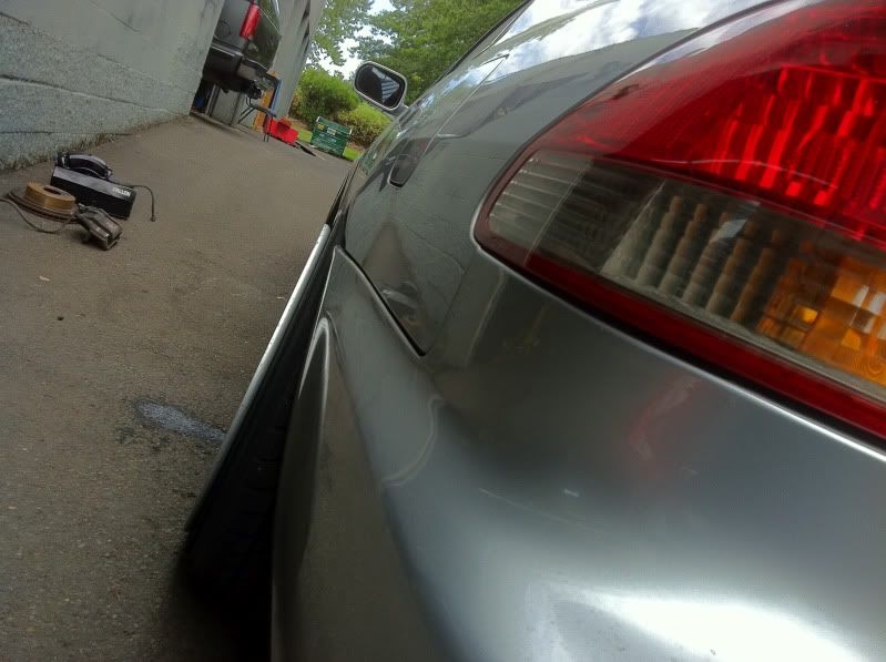

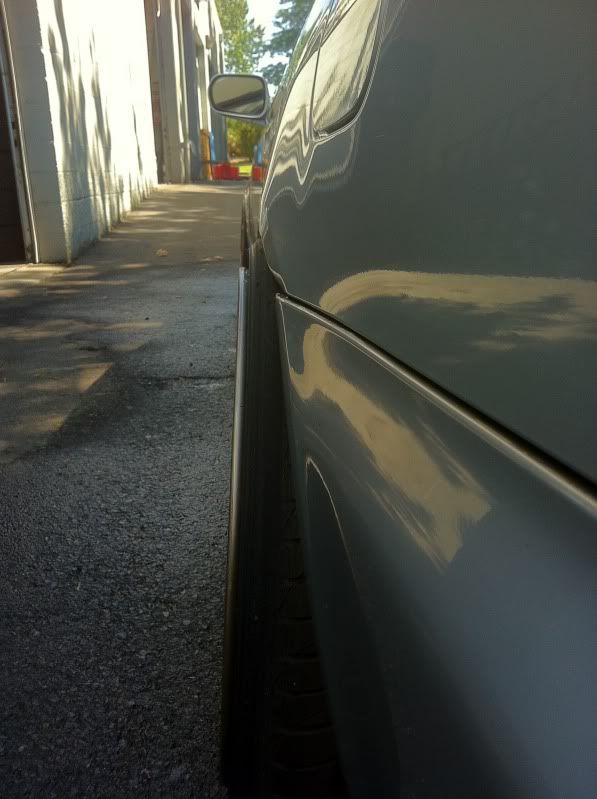

18x10 20 offset 225/40/18 yuppppp
18x9.5 with a 15 offset 225/40/18 i can throw a 215 on and go lower with more clearance if i wanted too all natural camber
