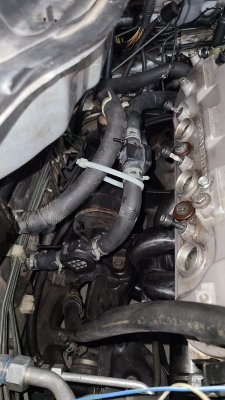

Motor is alive and kicking on 1st start. Let it warm up, to bleed radiator, the fans kicked on as it should. Idles around 800 rpm. Couldn't post a mp4 vid, but here's a pic of the engine bay.
