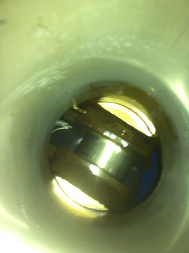

JDM H22A Block- Glad to see a nice smooth wall compaired to my last puchase.

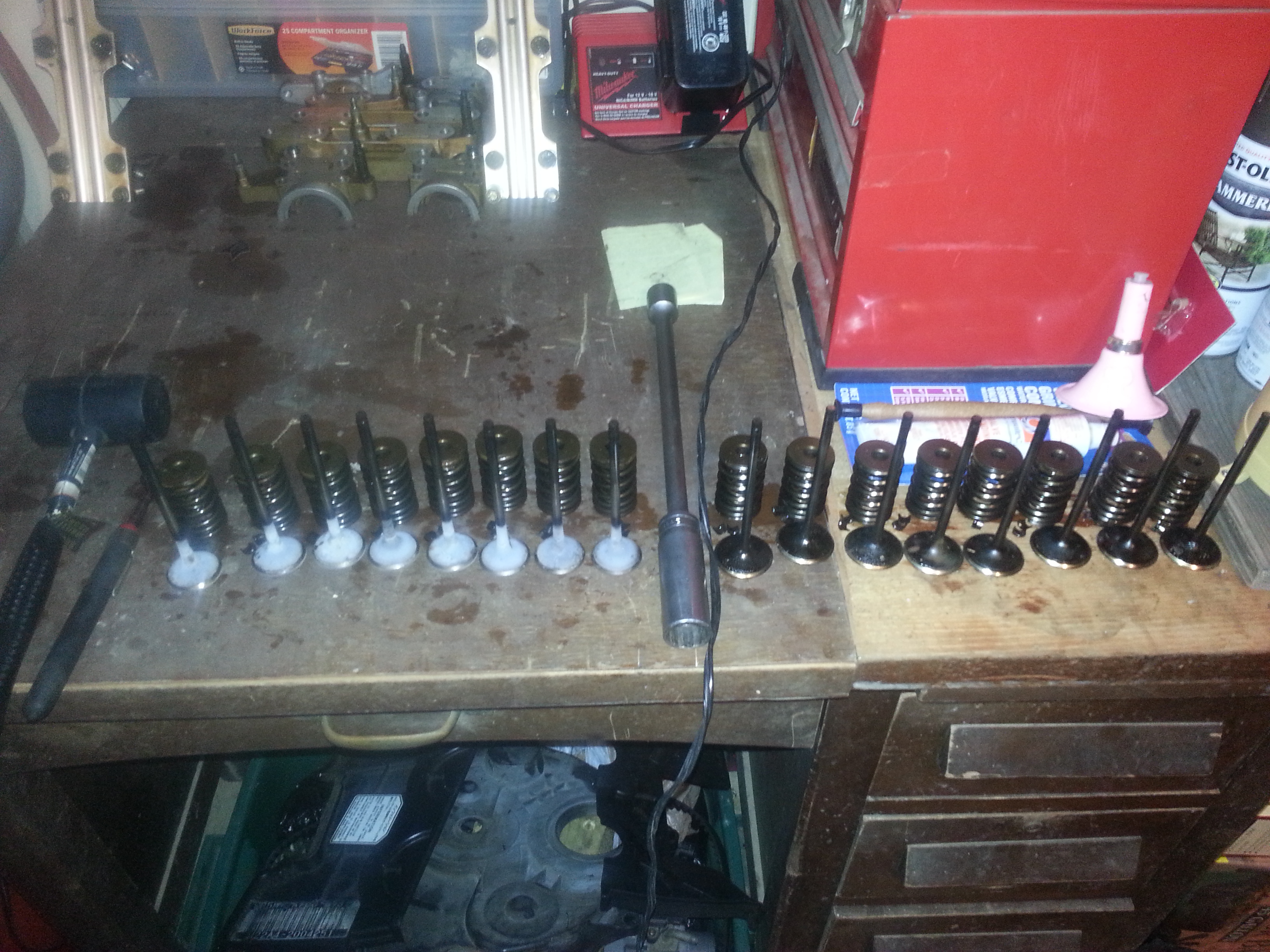

Valvetrain-

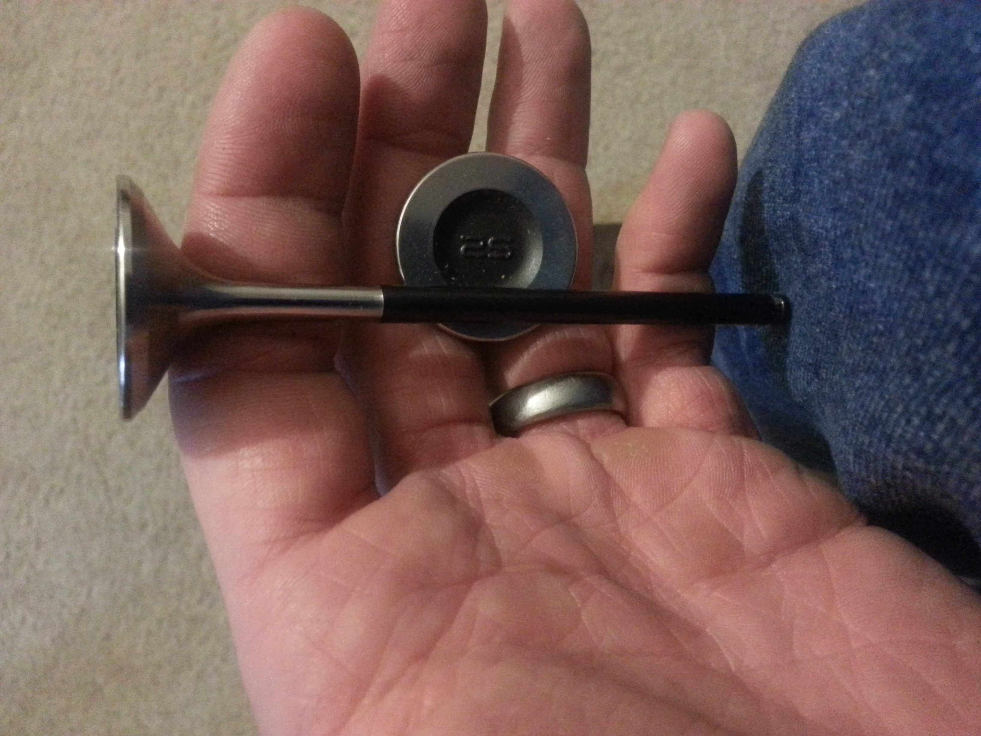

New Skunk2 Valves-
