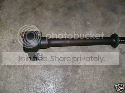

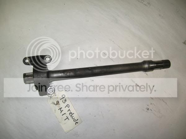

this is the half shaft i bought.. its for a (93 prelude S) which is the same tranny i got.

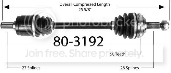

and this is the Accord ( Manual) drivers side axle i am planning to buy
but they i cant see how they are gonno spline from these pics..
unless i bought the wrong halfshaft.

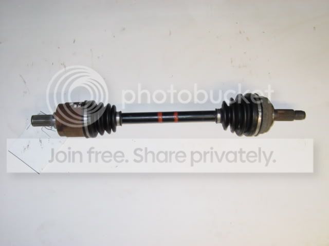

NOw this is an Automatic Halfshaft from the prelude.
this more looks like it will spline ..

Could just be a generic axle picture.

badgertype or any1 familair with the swap.. answer me this..
That pic you posted still has the spline from the axle stuck in it....other than that it looks right.

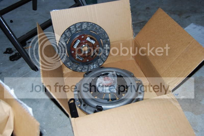

wel.. i got the clutch, and pressure plate.

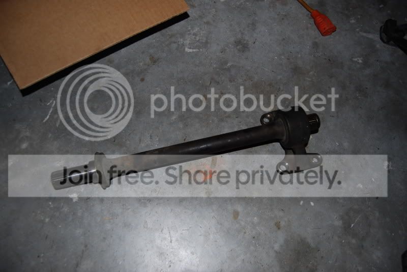

i bought a F22 halfshaft..
but i was told to get a driver side axle shaft..
but the one i bought i realized has 2 male ends, instead of having a female one..
i pretty much been buying the wrong parts here and there.. it sucks..
this is the one i purchased....
