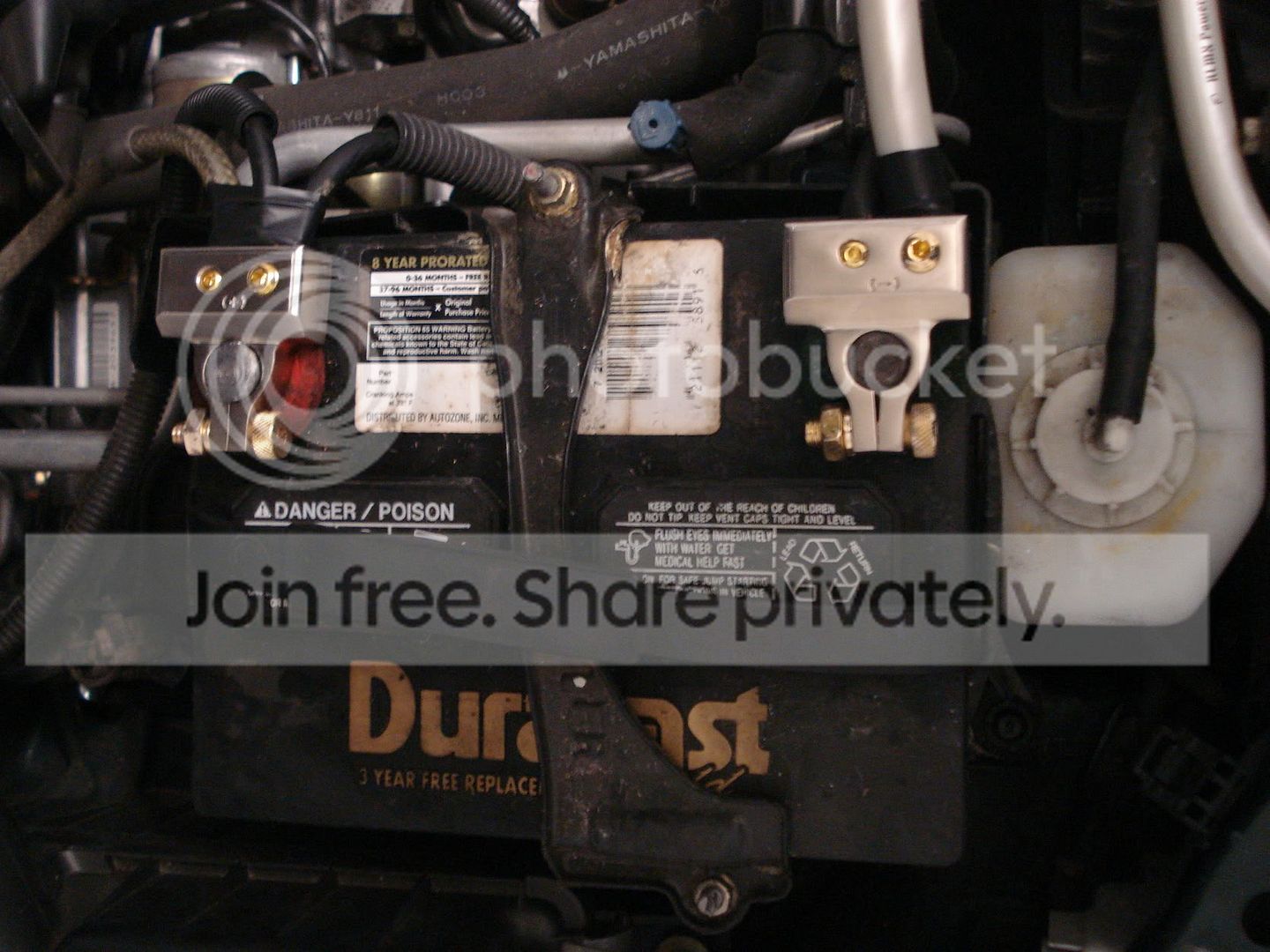

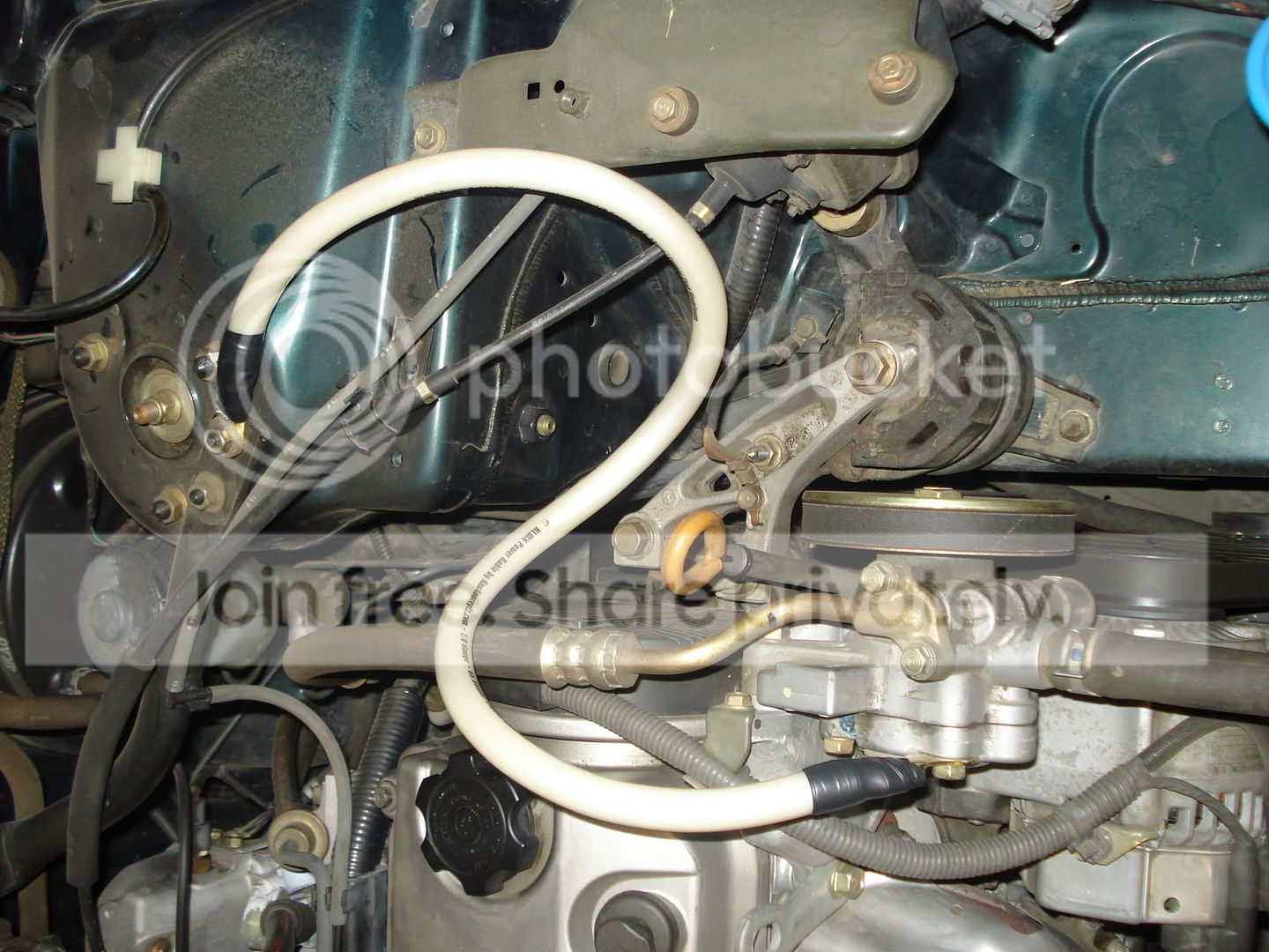

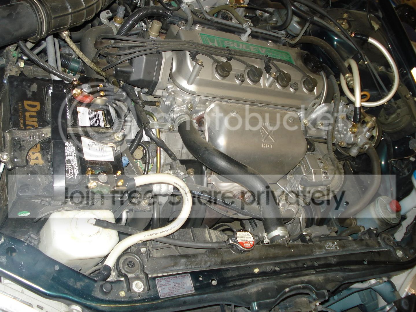

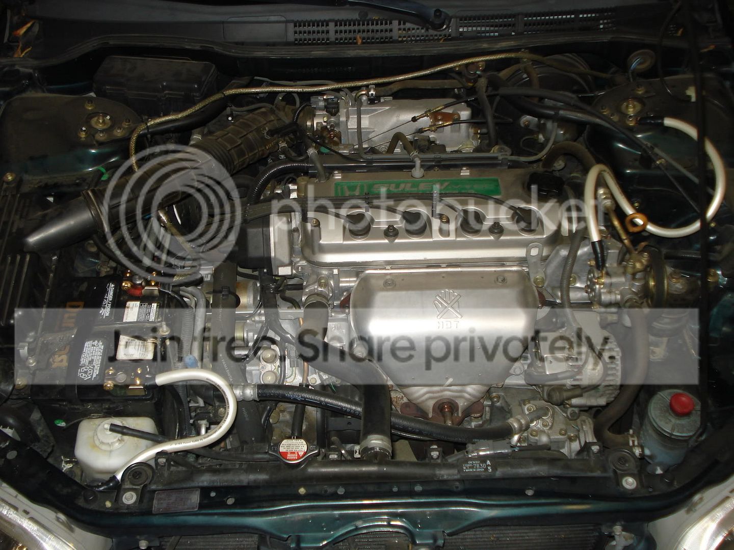

Okay, here are the results of the install...
Excuse the dirty engine bay...
The only problems I ran into was cutting the wire and throwing them into the ring terminals.. they were such a b****. Other then that, everything went fairly smooth.
The positive terminal is a bit loose and it worries me a bit. It is snug, but I wished it was more tight. I'm thinking about grinding down the clamp to make it more fit, but I don't really know what to grind it down with.
I also wrapped anything that was sticking out with electrical tape to give me a better sense of safety.
Overall, the install went pretty smoothly and my idle is noticeably smoother.
I can't speculate on how much brighter my headlights are just yet, but when I do get around to driving at night, I hope it gets brighter.
This cost a bout 35$ and it was a great investment. Thanks for the DIY Wildman!

Looks good man. Glad you noticed at least some improvement. I did the exact same thing, but with copper wire. I didn't notice a single difference lol.

Looks good man.
My positive terminal was loose as well (I could just pry it off by hand even after fully tightening), but I found that if you push them down onto the terminal (bang on it with a rubber mallet or something) then it becomes much more tighter/secure. Or just put something conductive between the terminal and your post lol

Sounds good! I'll keep that in mind.
And another thing.. I was driving earlier today at night and I REALLY noticed that my light output had dramatically increased. It was quite pleasing to my eyes. Now I'd really recommend doing this! ;)
