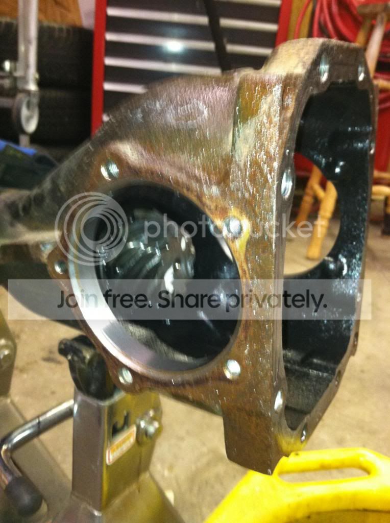

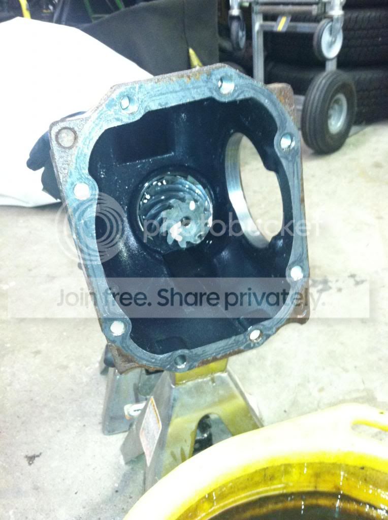

The '07 rear diff I picked up at my last job.
12k, 3.90 ratio - Researching which LSD I'm going with currently. Despite it only having 12k, once I tore it down it didn't exactly appear that way. There was rust/salt corrosion on all the bolts and in some of the gaskets around the axle cover plates.
Tear down took about 10-15min. Once I get it fully cleaned it'll be going to the powdercoater. Probably stick with gloss black, haven't really decided yet.

Pulled (rather beat) the OEM 3.90 ring gear off tonight. Ordering Carbonetic 1.5way LSD tomorrow. Just need to clearance the casing a little (minor grinding), prep it, paint it, order the correct shims for the side plates.

Same gear ratio, just swapping the ring gear onto the LSD unit and drop it in once I clearance the case for it. Found out I wont get my LSD till almost Xmas b/c they had to order it in from Japan. Started polishing the diff cover over the weekend, not completely satisfied with it yet, will finish that up tonight hopefully.
