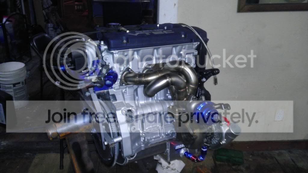

Is the Moroso pan going to be a slimmer one to create a dry-sump system, or is it just the regular size Moroso brand name pan, with the oil-return bung pre-welded onto it?

Did you have to get rid of your AC to make room for the turbo/intercooler?
The manifold I got isnt ac/ps compatible. Didnt want to go with that log style bull**** manifold, which i think is the only one you can use to retain ac/ps

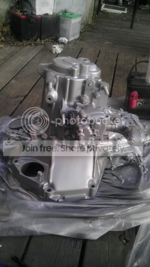

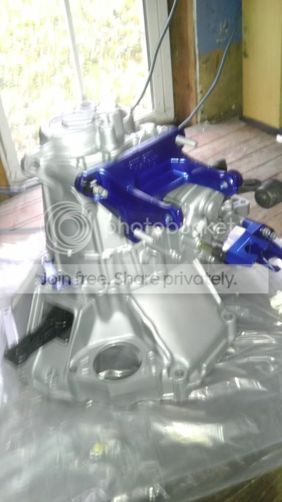

UPDATE! NEW PIX
So I've been acquiring parts and over the last 2 weekends, I wet sanded my roll cage, painted it and then started working on the motor. Took everything apart, and took a wire brush, qtips, rags, and engine degreaser to EVERYTHING!, Then primer, paint, and admiriing.... more to come.
Roll Cage Painted
After engine tear down, and hours and hours of cleaning, its just about ready for paint.
Scraping the intake manifold gasket off... fml
Taped off and primered
After Paint
Painting more parts
Tranny gettin sprayed
Lookin Clean
Sky is on fire lol
Engine after paint
Engine after paint 2
Oh Yeahhhh
Tranny just about finished
Lookin sexy
So thats where we're at currently..... sigh..... I just wanna drive lol
Oh Yea.... Skunk2 Pro series IM and Alpha 70mm TB came in today, tryin to drop it off at the machine shop before 5 so they can port match.... Will Update soon.

im not sure if that IM will clear the fire wall. its came up a few times in a few threads.

looks good, gonna run low boost on 11:1 CR or new pistons?
Progress looks dope tho. keep us posted
Yea I heard its an absolute ***** but if you do it outside the car, its not bad and itll clear.... fingers crossed. If not you'll see a Skunk2 H22 IM port matched to a Skunk2 70mm TB on here for sale soon lol.
EDIT: Yea after a little more searching it seems to be the brake booster that gets in the way..... Chase Bays makes a booster delete for 199, so I'm sure that'll be one more thing to add to the list lol, whatever, I'll cross that bridge when I get there
Low boost to begin with, got a 7.25 spring. Eventually gonna rip it all up and fully build it and go high boost.
Looks like you got it all planned out. Good luck
