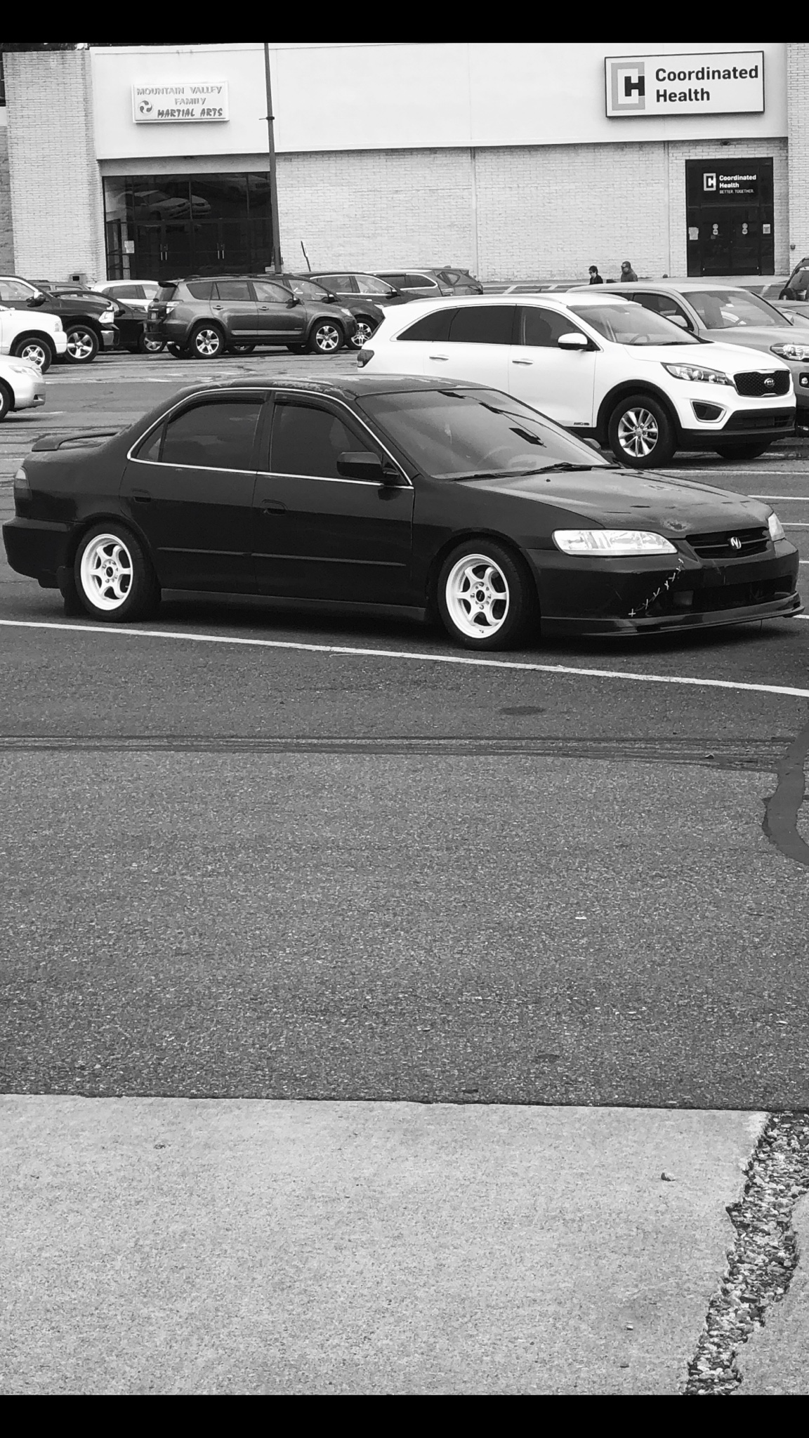

Not sure if anyone is still on here, however, I’ll throw up some progress pictures for the thread to keep it current. I’ve lowered the car with some truhart lowering struts and Megan racing lower springs. They required some work to cooperate together but other than the occasional slight bottoming out on bad highway overpasses, the ride is much more comfortable.
As with any coilover setup, braking, straight line stability and cornering have drastically improved. The F20b has been trouble free and has required nothing but basic maintenance since it’s installation.

Thanks for updates. Im in the planning stages of a f20b swap as well on my 5 speed. Will be asking you questions.

Boyee, car looks good. But damn those wheels look too small. Some 17's would be nice, 18's would fit perfectly.
Any particular reason for swapping? Lol. Just curious. I think your money would be much better spent on your current engine but I’ll be happy to answer any questions for a measly 1 billion dollars and a ticket to Japan so I can visit Type 1 :lawl:
M
I know. But to be honest these wheels were free. I can’t complain since they’re an upgrade from the steelies :lawl: I have to take them off for winter though so it’s back to the steelies. Cant wait to get back to Florida. No snow there. Just those vicious curbs and driveways lol.
