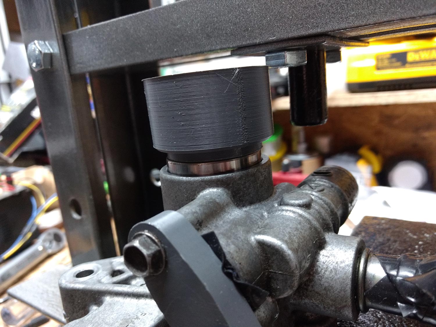

    Not wanting the vanes to change position, I printed out a holder for the core pump mechanism (slotted disc and vanes):
    [​IMG]
    Also printed out some jigs to be able to press the bearing at the right depth as well as seat the inner seal:
    [​IMG]
    Pressing the new bearing:
    [​IMG]

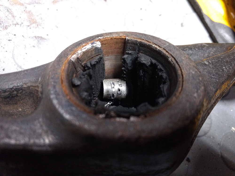

    Lower Arm Bushings
    The worst part of dealing with the bushings is removing the shells. Managed to peel one like a tin can:
    [​IMG]
    [​IMG]
    [​IMG]
