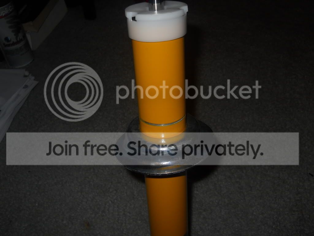

Lol I didn't know also, my cousin said I can lower my car about a good inch more after I told him my car had a boat look. He showed me how and boom, took only 2 minutes to do lol
Jack car up, remove wheel, use jack stands, use flathead to pry it the small yellow ring, and them put them on the lower one.

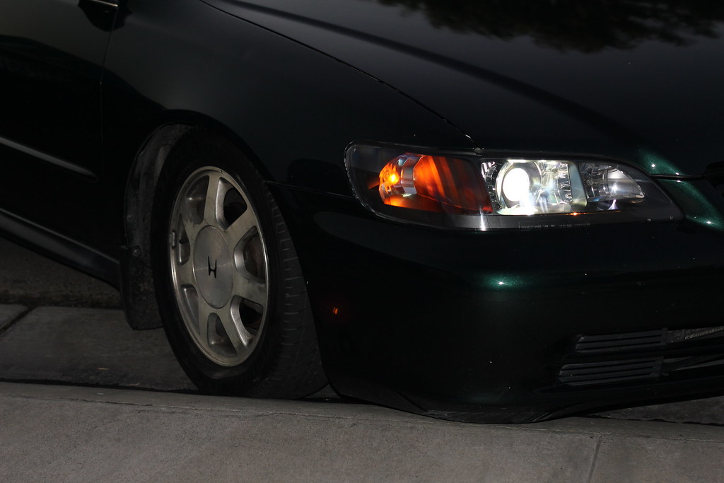

Moved the snap ring down. I only have 2 perch settings. It went a litte more than HALF an INCH
Another Picture of the ring moved down.
The Strut together with it on the Lowest perch setting.

I changed my perch with my shocks still on the car and it was even faster since the springs moved the perch for me. my car is lowered about 3 1/2 inches now.

Yes if you get the koni adjustables, it lowers your car about 1/2 inch to 3/4 an inch. So if your riding on sportlines, keep the back strut where its at and drop the front one to get rid of the boat look. Also they have comfort adjustment. Its about 20% stiffer than stock.
