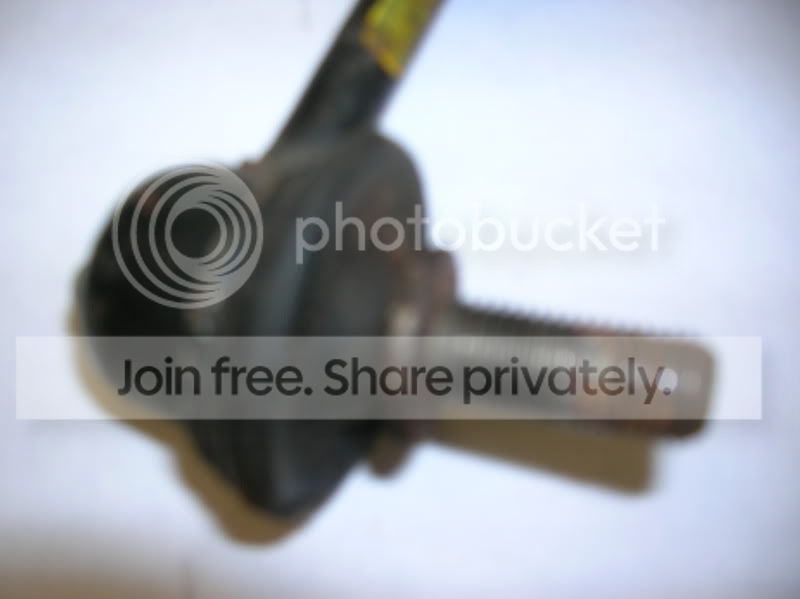

I replaced my front end-links a few weeks ago. The hex was stripped, and it was a bitch to get off. It is a very poor desing. There is no way to replace a nut/stud or any part involved in the link, the whole link itself must be replaced. It is deffinately a good idea to replace them in pairs. There is no danger with driving w/o a sway bar, just poor handling. When you fix it, you will feel like you modded your car because it will handle so much better.
When I replaced my links, there was basically no way to get them off without destroying them. I pried the link off of the back to expose the ball on the back of the stud that makes up the ball joint, clamped vice grips onto the ball, and used an impact gun to remove the nut on the front. I believe that I still have the destroyed links somewhere, and I do have the day off tomorrow so I will try to post some pics to show you what I am talking about.
thanks! very helpful info!
i was pretty sure it would have to be a destructive removal.
since mine are partially loose, i think i can just cut the bolts in half with a sawzal and everything should fall out....right?
