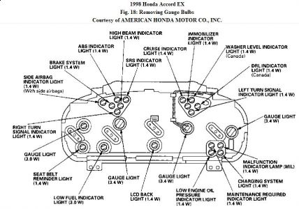

Our cars have a low oil light? Just curious, which one is it? I would stick with a higher mileage oil incase your car is burning or leaking oil somewhere causing the light to come on. Plus, higher mileage oils have additives to prolong the life of your motor. I started using Mobil 1 5W-30 High Mileage and it's been burning a lot less oil.
ActNow
Sep 26, 2007
1,639
Killeen, Tx
Its red in color looks like an oil can.
This is from a 91' accord but its the same thing located far right.
