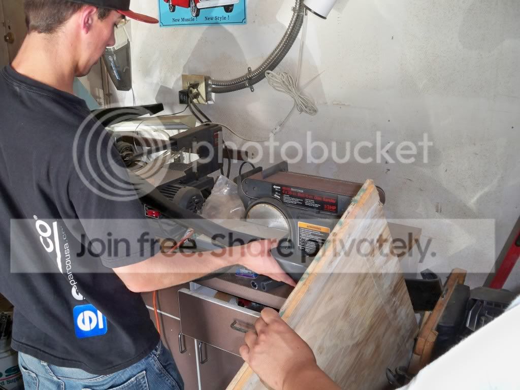

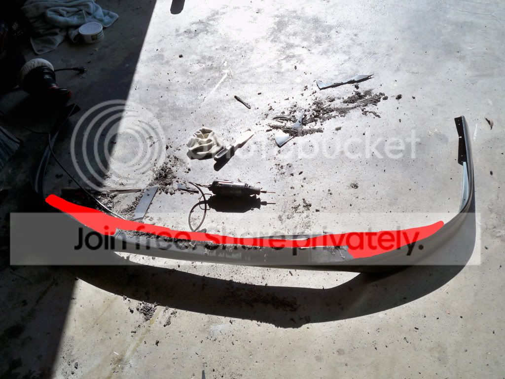

i did yesterday.
1. measure out how much you need to cut to make the middle piece fit inside the grill. mark it on the lip
2. i used a dremel to cut out the big pieces and belt sander to get it smooth
3. dont cut too much at a time. have patience.
4. the middle part was too long so i had to cut that too. to prevent it from hitting the bottom grill.
its not that hard.. you just need patience to get it right. gl
