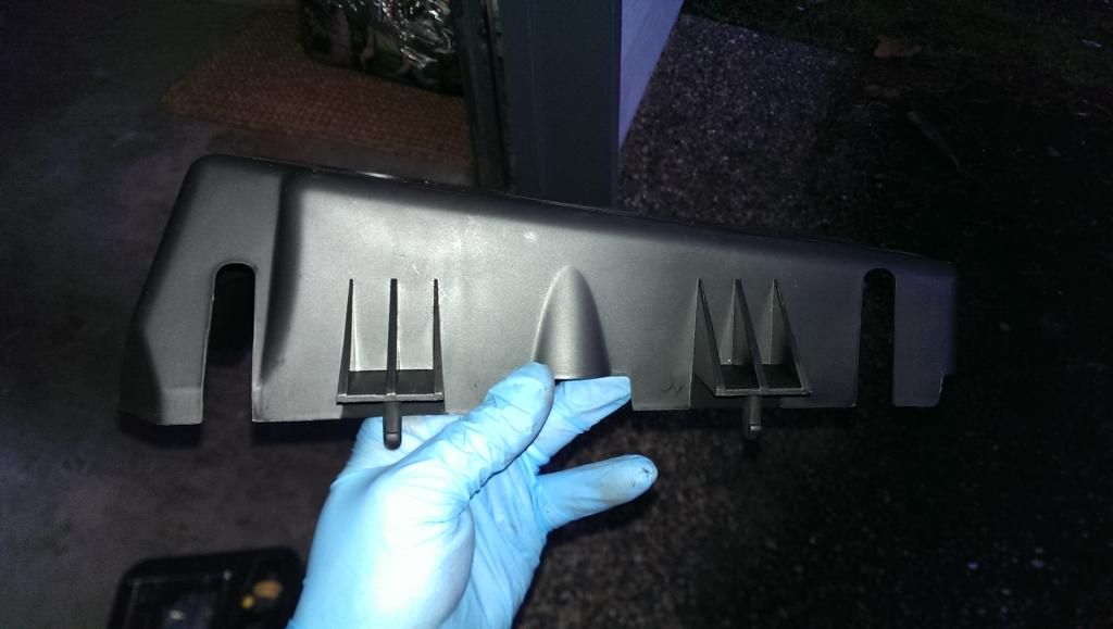

Got the Christmas gift from Santa. (2G CL / TL Battery cover & box.)
Was hoping for them to be PNP, but I unfortunately had to trim off a few sections, since I have zero gage ground wires coming out from my battery terminals.
BEFORE:
AFTER:
______________________
Haven't had a chance to do a proper photoshoot w/ a descent camera for a long time. Was already dark at the time, so I dug into the ground, where there were some lights.
Thanks for looking. :)

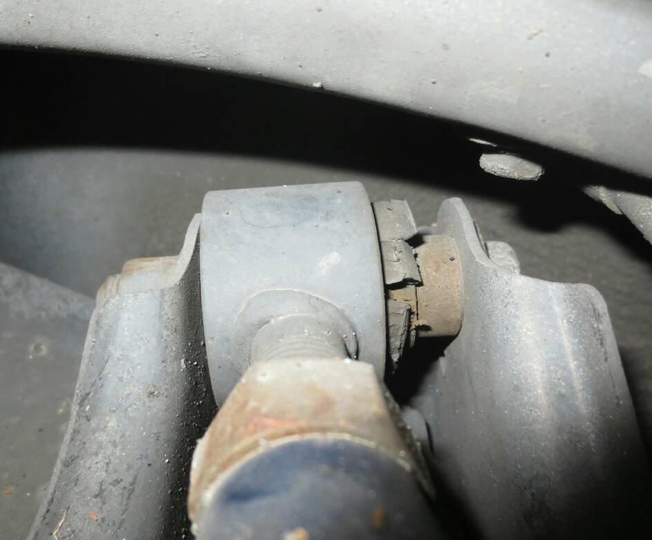

Went to the shop to have my Powertrix rear LCAs installed and my front coilover kits lowered to the max, since the car needed the alignment service.
Well, the shop discovered 3 problems on my suspension:
1) The alignment on my right rear upper control arm (Wicked Tuning) is way off and the bushing is pooched out and damaged.
2) The right front upper ball joint (Ingalls) has a large amount of excessive freeplay.
3) The front strut (Tein SA) to be sticking quite high out of the knuckle. They called Tein and sent them photos. Tein said “It looks like the installation was not done correctly, the lower fork bracket would have to sit more up on the damper, it would have a second groove that the lower bracket bolt can be tighten to."
At this point, the shop could only install Powertrix rear lower control 'rear' arms, but the OEM piece was rusted pretty bad into the arms so much that they had to cut all of the bolts (additional work). They did lowered the height on my front suspension "properly" but it required some disassembly work (additional work).
Now, what I need to do is:
* Get a replacement of my right front upper ball joint. Screw Ingalls... I'm getting SPC, since their products are well trusted, which I later discovered after I got Ingalls.
* Get a replacement of my right rear upper control arm. I thought Wicked Tuning was good, but maybe I wasn't lucky... I'm getting SPC's for the same reason.
Finally had the Powertrix LCAs installed completely. (Black stein is the anti-seize.)
The piece in blue is the Wicked Tuning upper control arm, which seems to be holding strong, as opposed to the right side.
