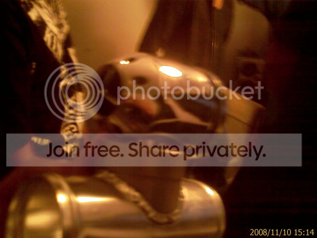

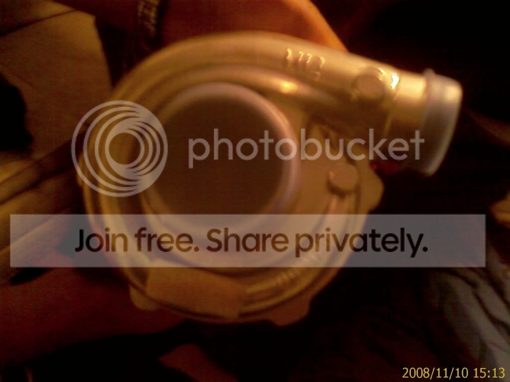

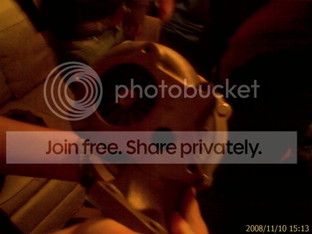

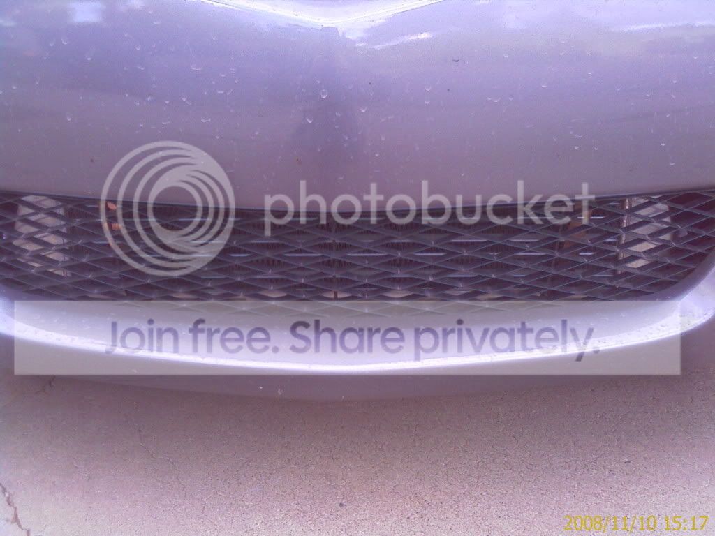

here are turbo pics
50 trim JDM

Intercooler still mounted on my freinds mazda

now, im not familiar with turbo kits on the v6 but on the 4 i am, but i think that that sounds like an awesome kit put together with some quality parts....
i'd be a little iffy on the turbo itself... don't know much about JDM turbo's is an oem off another car?
also tial intercooler? what?

that JDM turbo is nothing but a cheap China turbo,thats ALL over ebay for 120$-got one myself.
Tial is the wastegate. the intercooler is also probably Ebay. if the BOV dosnt have HKS in gold/yellow letters on it than its also another ebay replica.
