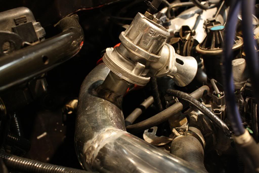

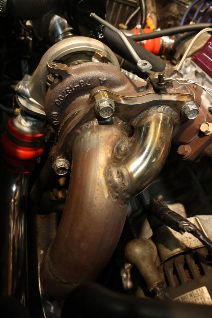

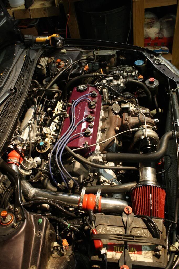

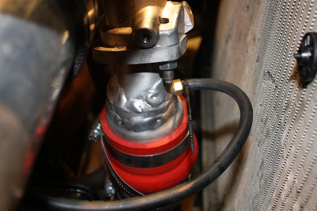

some new pics, with pauls fab work.

Everything looks really nice. Congrats on getting it up and running. Good thing nothing happened with the cam pulley bolt going MIA. Did Paul use a MIG for everything?
thanks man. He used a TIG for everything as far as I know. I'll say one thing welding is not his strong point. the weld where the wastegate routes into the rest of the exhaust doesn't even look like a TIG weld. Maybe when I get a welder I'll grind them down and lay down something prettier hahaha
