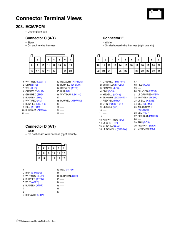

Re: [Updated 3/11] J32 Swap [Engine Mounted]
Hey bro,
I think the connector e plug from the RSX Type S will work. Although it looks like you have to add some pins/wires to it.
This what you meant to screenshot Varnell? Page 4.

Re: [Updated 3/14] J32 Swap [Engine Mounted]
Thanks, James, but it's actually a broken image at the bottom of the fifth page.
Just spent two and a half hours working on the wiring. Honestly, it shouldn't have taken that long but I snipped the dash harness assuming each wire was a distinct color. I later realized seven wires had the exact same colors/dots/stripes. lol
Yeah, I recall seeing it but I thought it was this exactly. Sorry buddy.
