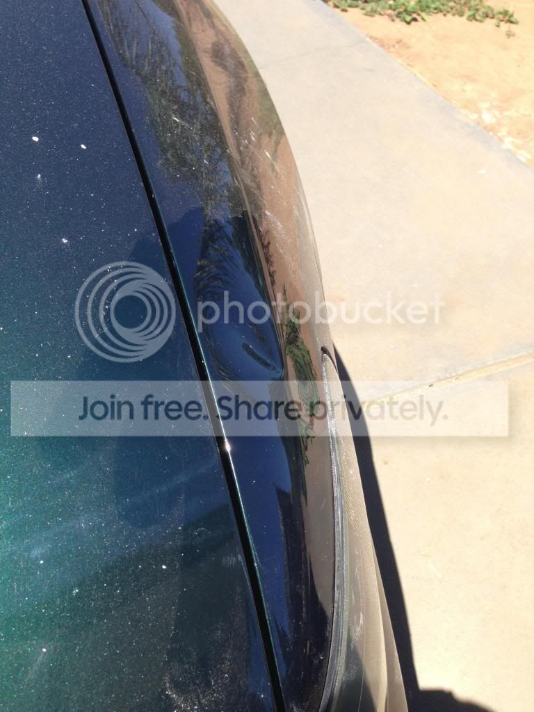

Today .. Went to my garage and saw that a massive piece of gyprock fell from the ceiling edges and dented my fender and put two scuff marks on my side mirror :furious:

Nooooo! I'm sorry to see that... Well, at least the paint wasn't damaged though. Planning to go to those paintless dent removal shops? Perhaps you can buff off those scuff marks to make them less noticable / disappear.
Wait a min. If those dents are bigger than size of a coin, and not too deep, there might be a way to remove them with DIY.
You might have seen this on youtube or something, but:
1) Heat up the affected area w/ a heat-gun or something.
2) Use an air-duster (those cans to clean out your keyboards for your PC) shaking & spraying upside down to hit the affected area.
They might pop right back. I'm sure you'll see many videos on youtube. I know it works if the size of a dent is from fist-sized to foot-sized and beyond. (Bigger the better.)
I know it doesn't work for those fingernail-sized typical door dents, but since your dents are relatively bigger than those, It might be worth trying this out. (Judging by the size of your dents, chances are about 30 ~ 40% success. If you do this, I'd consicer taking off your headlight since the dent is close to the lense. You don't wanna melt your lense.)
If it works, give me high five.

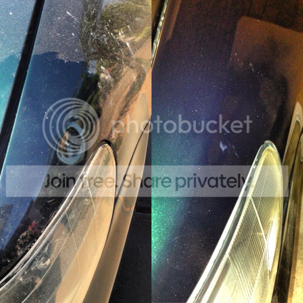

I spent nearly 4 hours taking off the fender so I could push out the dent a bit. It did improve but there's still two dent marks there that I can't get out.. Scuff marks are still there ..
In order to get the fender out you gotta take off the front bumper, your headlight and take off your side skirt. I found the side skirts in particular very difficult to get back on. It is a PITA. Oh and I sheared a bolt that holds the fender on but it's okay .. There's still 5 other bolts holding it on lol.
While I had the bumper off, I drove it up on planks and lowered the car again a bit.. Still not at 23" just yet but I'm starting to think how the hell you guys at 23" or lower can drive around town .. Lol
Now Richard :),
Because I didn't have a heat gun I used a hair dryer, still as effective, just takes a bit longer to heat up that's all. Once I heated it up enough I just pushed from the inside with my hands (didnt have that air duster can and I sorta couldn't drive to the shops because I already had my fender off lol) and it slowly moulded back into shape. Here's before and after comparison :
As you can see there is a bit of paint damage but most of it will buff out.
Still appreciate the info you looked up for me :rock:

^ Not a prob, my friend. Looking at the before & after pic...., damn... Job well done! You're seriously becoming a major DIY guy. Very respectful! (If it ever happened to me, I'd try that heat-gun + cold spray first, and if it doesn't work out, I'd call those body shops immidiately lol.) ← What a lazy guy, I know...
What I liked reading your comment was this:
I spent nearly 4 hours taking off the fender.....(Albeit all of your intensive labor to get rid of your damage)......
I was like, "again???" lol. I think yours is quite low already. It just makes me giggle, b/c you never seize to stop going lower lol.
Anyways, this gentleman's DIY spirit truly amazes me. :thumbsup:
