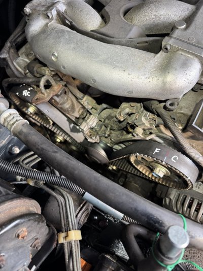

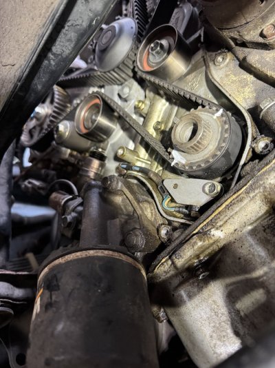

Hope everyone is doing great! Decided to do another timing belt job on my 2000 3L Lx coupe! First time was by the dealership and I diyed 2nd time March 2016. Been about 10+ years and the car runs great so I ordered the aisin kit TKH011 (and belts and coolant (ABC003) from rockauto and went at it July 1st. Took a bunch of hours, who cares, but everything worked again! My 3rd personal TB diy (last July did a 2014 odyssey).
Fingers crossed but I might have also fixed the small oil leak that was seeping from the oil pan gasket by tightening some of the 10 mm bolts. Yeah this car at 228xxx miles just won't quit! If it lasts another 10 years, I might do it one more time and I think I can do it without any instructions haha. FWIW I bought this car new from White Plains NY honda for about $19k Jan 2001 and did I get my money's worth! No dash lights at all except for the occasional SRS which I clean the seat belt buckle and reset. It may be covered under the lifetime warranty but anything to NOT visit the dealership is a win.
Enjoy the pics, you can see how OCD I am about marking the belt and cams. Oh I had to buy the milwaukee hi torque impact last summer for the ody b/c my midtorque with the heavy lisle socket (and a 6amp battery) wasn't cutting it. This time the midtorque with the lisle socket was good enough so I didn't even have to bust out the big high torque so the crank bolt was easy this time. Also in 2016 I did the cam and crank seals and the thermostat but not this time. I also reused the coolant b/c I did the radiator a a few years back. One of the fan was also replaced a couple years back. Hopefully nothing major any time soon.
