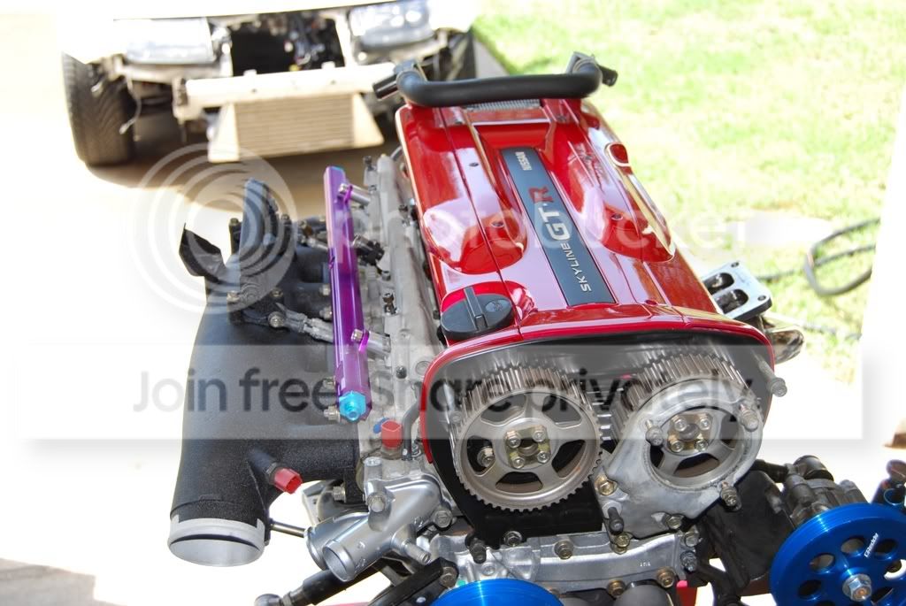

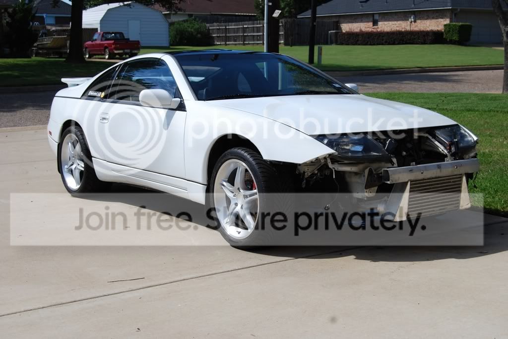

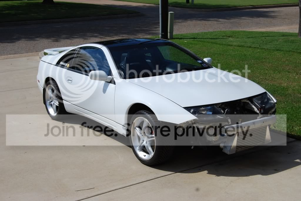

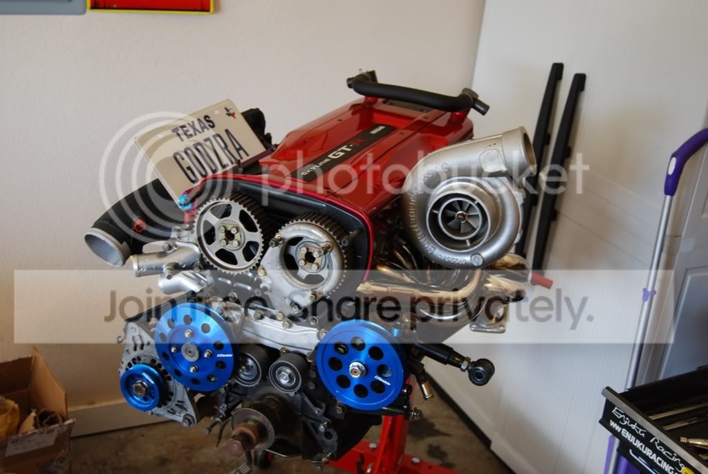

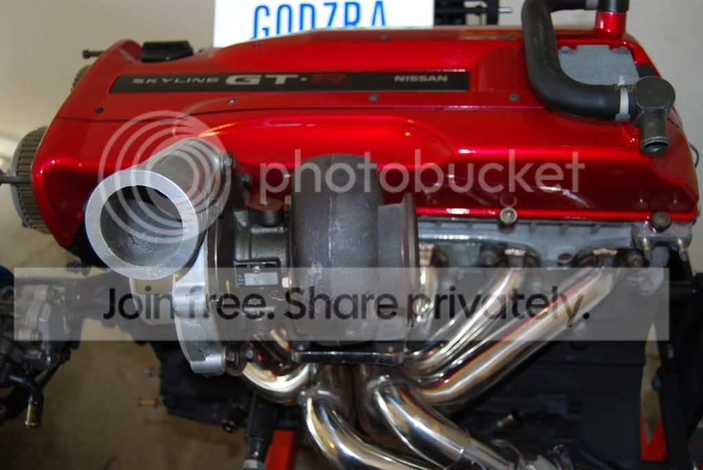

Updates:
Custom FMIC is installed w/4" piping using the front bumper support. Turbo has arrived. Borg Warner Airwerks S300 series S360sx 1.00/0.91 using a T4 flange. V-band FTW!
It's still a ways from running, but I'm getting there, slowly...

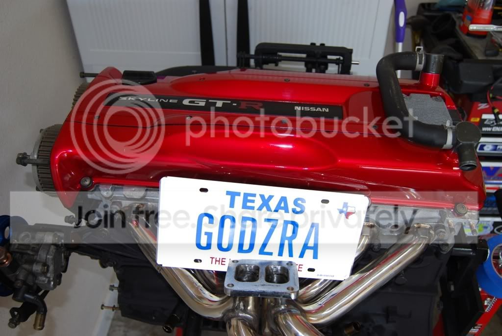

(P.S. I put my GODZRA license plate by it in the pictures because due to the "rarity" of this swap, there are many people out there that are nonbelievers that this isn't my swap.... similar to the person here that posted his "K20A2 swap in a CG5").... so just to take away any doubt. :) I can take any pics, any angle, whatever... I can take a pic of today's newspaper if it matters. :)
