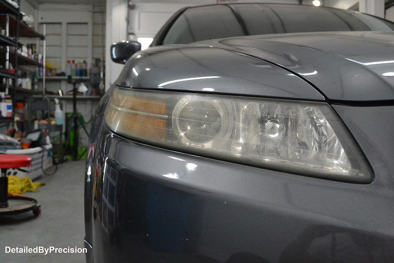

auto-detailing-san-francisco-Detailed-By-Precision1763 by Limny Kuang, on Flickr
auto-detailing-san-francisco-Detailed-By-Precision1768 by Limny Kuang, on Flickr
auto-detailing-san-francisco-Detailed-By-Precision1776 by Limny Kuang, on Flickr

DetailedByPrecision Very clean and low mileage 2004 Acura TL Paint Correction CquartZ Ceramic Coating Auto Detailing San Francisco
Customer found me online and wanted to know if the original Opti Coat ceramic coating that was applied to the car couple years ago was still intact or not. He drove up to San Francisco from Redwood City so we can take a look at the car together in person. After seeing the car in person and talking to him I can tell he takes great care of his car. Not just low mileage for the age, but the paintwork and body was clean. I explained to him the characteristics of a coating during initial application, the maintenance required in between washes to upkeep it, and to determine if there were any protection left or not. Because it's been a couple of years, some swirls and scratches were accumulated so he wanted to get the paintwork dialed in with paint correction, apply CquartZ ceramic coating, glass coating for exterior glass, and headlight restoration to fix the previous detailer attempt.
1000,1500,3000, Optimum Opti Lens for protection
auto-detailing-san-francisco-Detailed-By-Precision4064 copy by Limny Kuang, on Flickr
auto-detailing-san-francisco-Detailed-By-Precision4071 copy by Limny Kuang, on Flickr
auto-detailing-san-francisco-Detailed-By-Precision4113 copy by Limny Kuang, on Flickr
