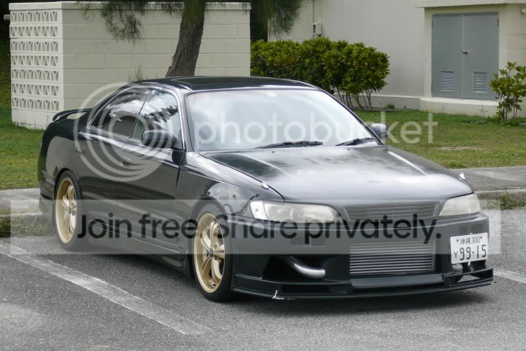

Who needs a bumper support when your going fast? HAHA.
Sigh... I miss having a turbo car...
Pic of my old Toyota Chaser, from when I lived in Japan
