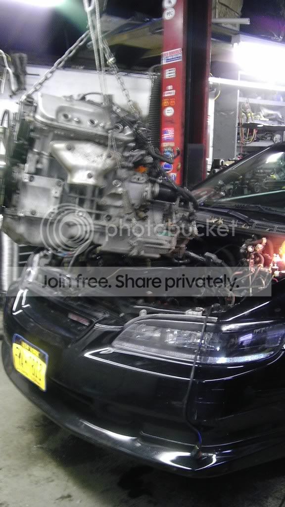

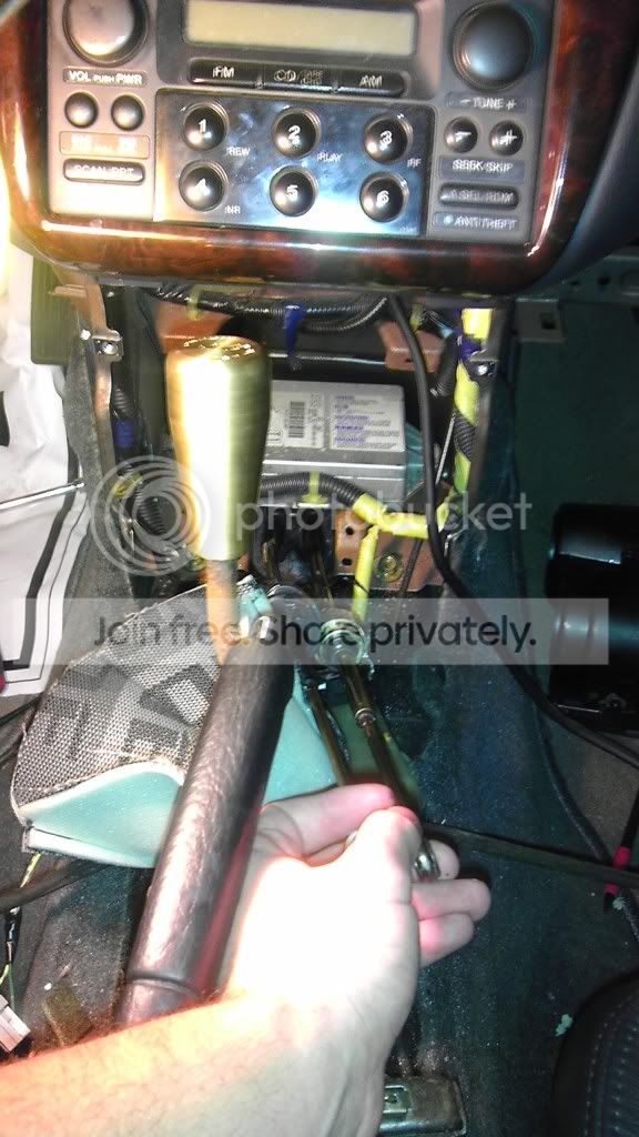

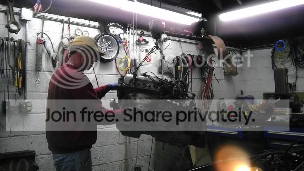

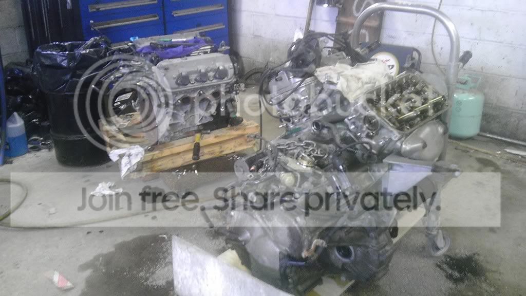

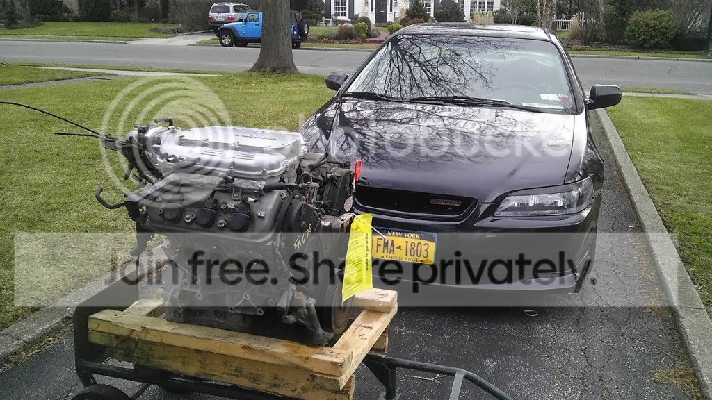

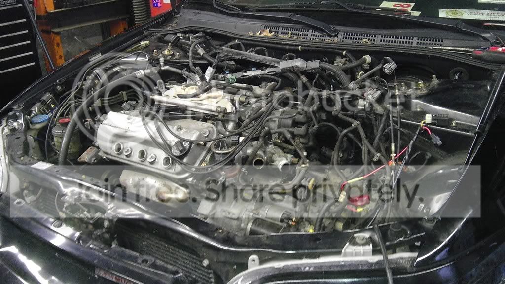

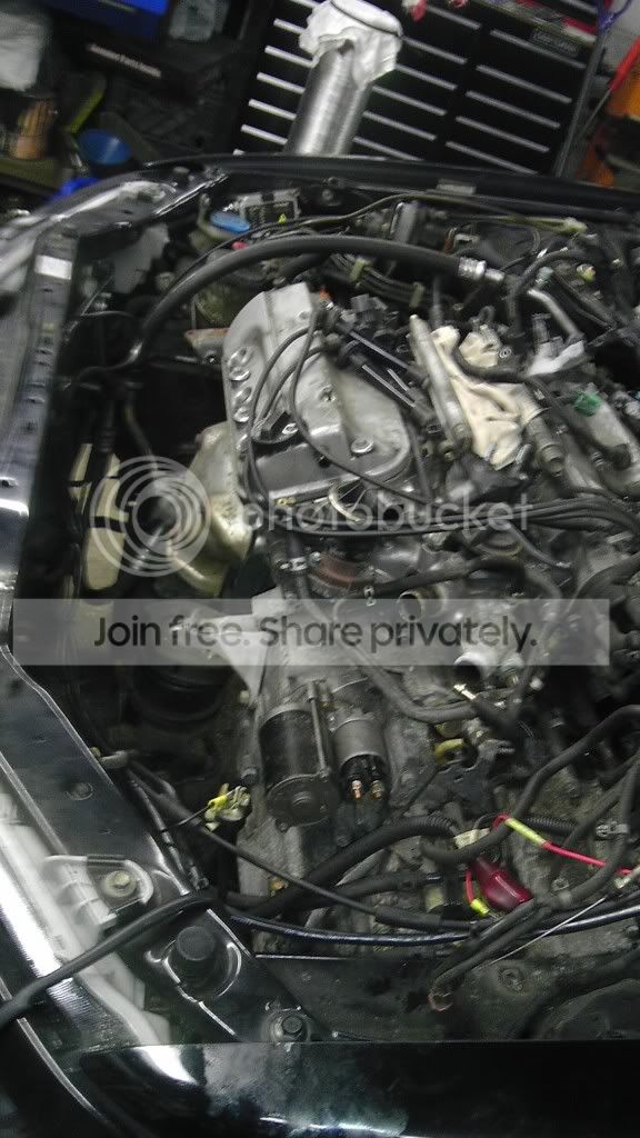

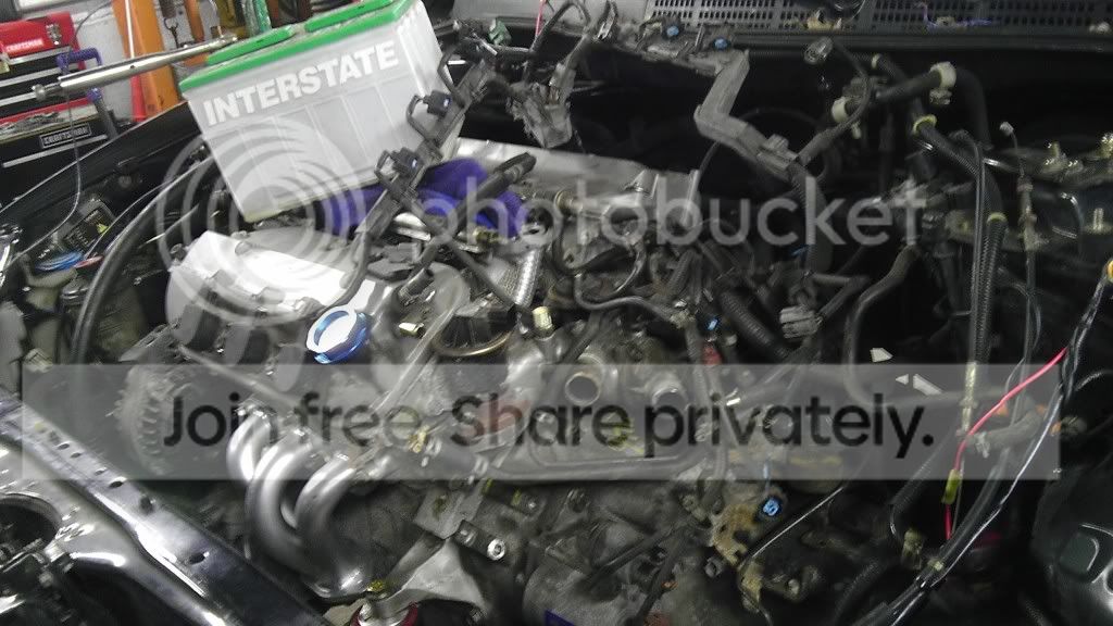

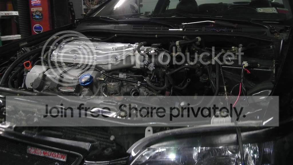

Here are some pics I took while doing my swap.
