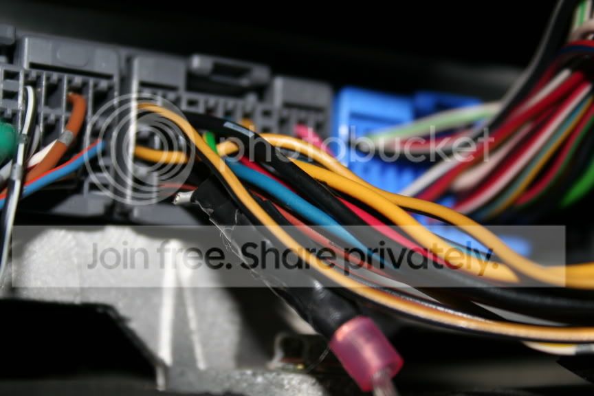

hmm, i tried to do this mod but it's not working. there are 5 plugs in all. 3 are small and 2 are big plugs. i tried to wire the green with yellow stripe (small wires) from "both" big plugs. it doesn't light up as much. but when i go over about 30 mph, it blinks in a very dim light. other than that, i can't find any green wire with yellow stripes. picture would help alot.

Once I get off of work I can post of a scematic. The VTEC wire your looking for is in the forward most ECU plug towards the cabin, green/yellow wire. What I did is wire it to light up my cruise control light, my cruise doesn't work anyway. If you want, I can get some pictures of the wires that need to be cut in order to make it light the cruise indicator light up.

If it's pre-resistored you've got nothing to worry about as far as that goes. Do you have an auto or manual?? I know the manual has three plugs on the ECU, and the auto has 5. I have a manual, the VTEC wire will be the same between all the models. It's in the forward most plug towards the cabin. I'll take some pics for ya'.

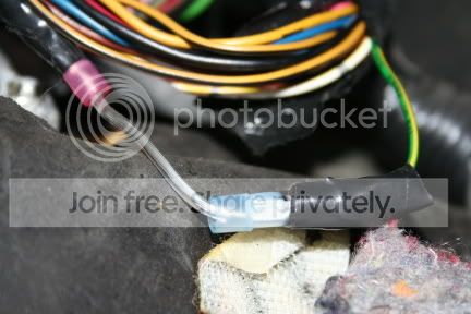

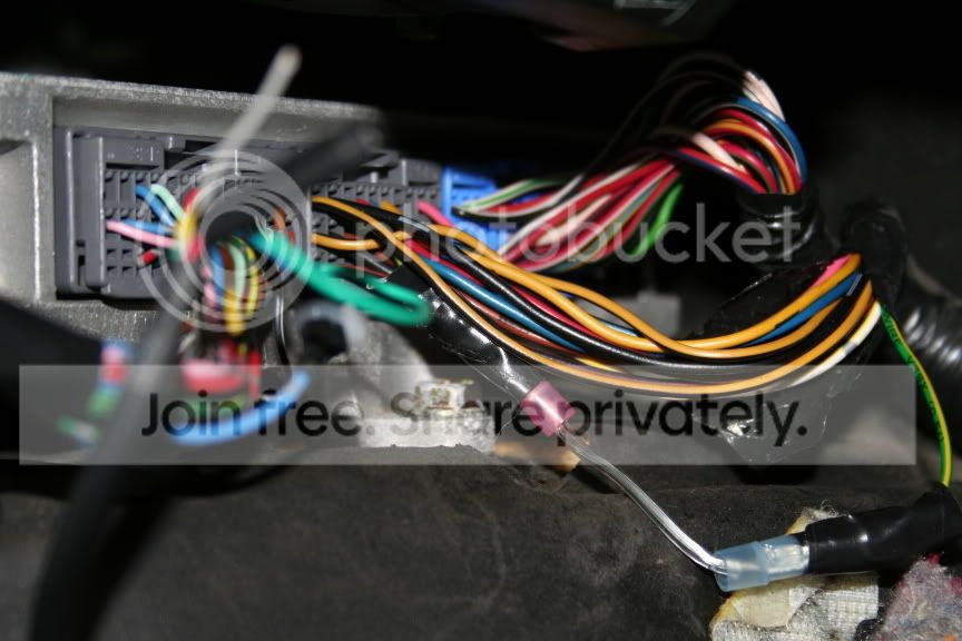

OK, wicked sorry. It's in the second(middle) plug on the ECU. Here's some shots of it for you.
If I find a schematic Ill post that too.
