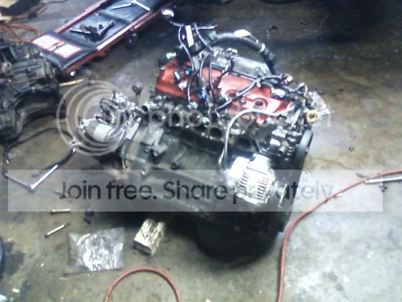

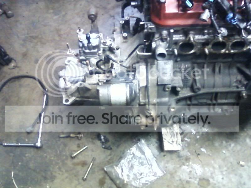

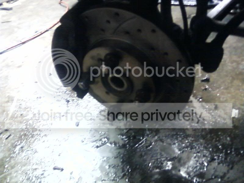

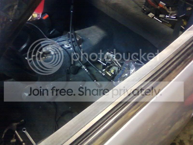

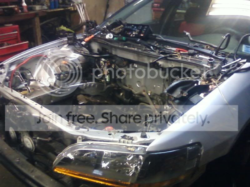

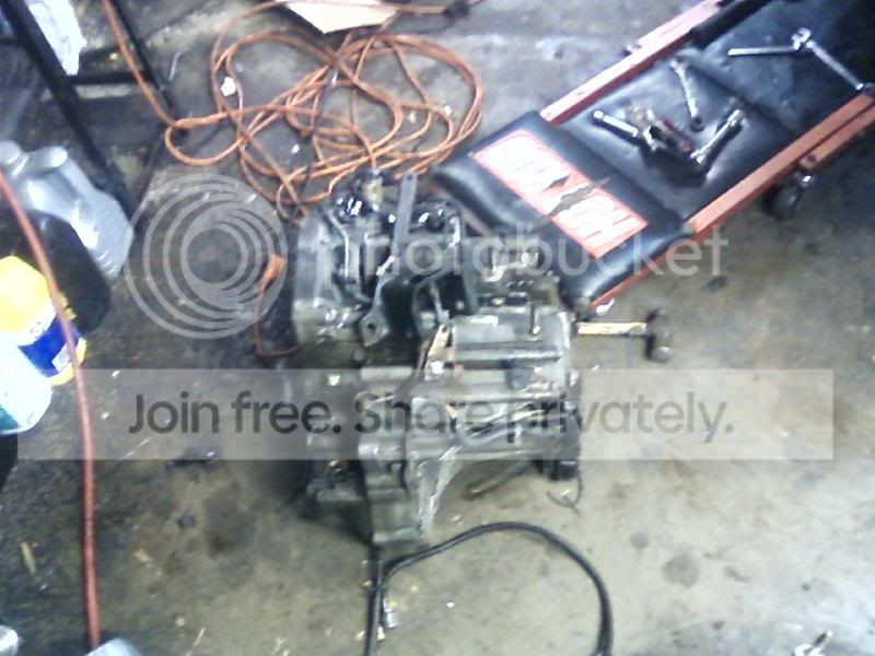

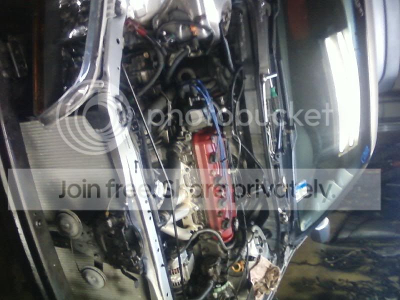

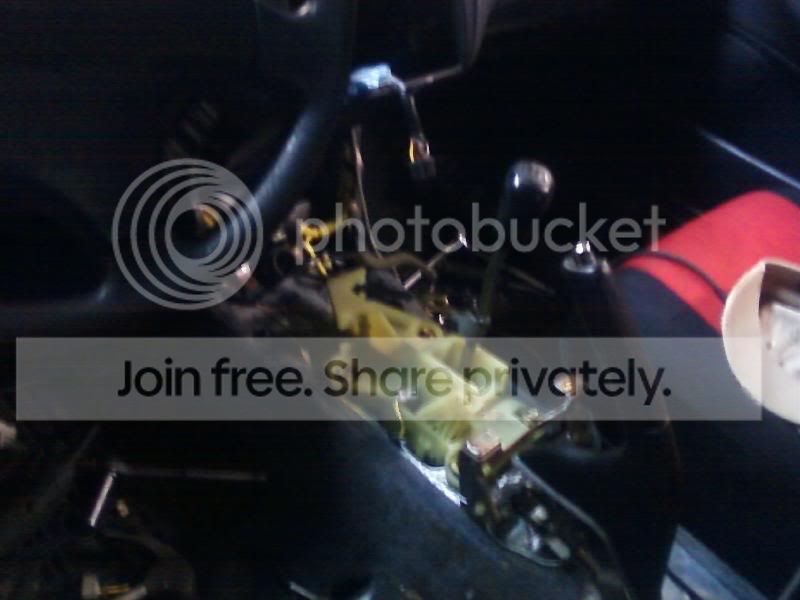

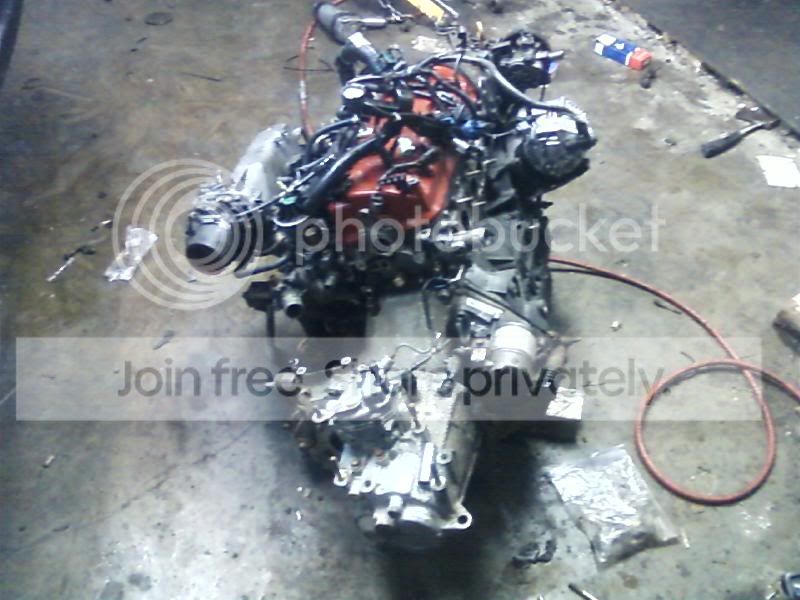

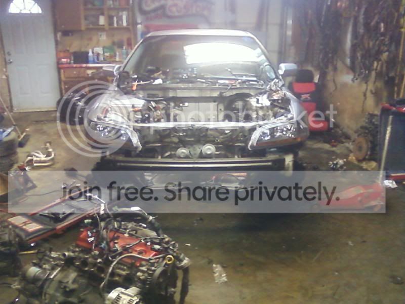

Heres Some Pics...
Old AT
F23A1 W F22 Tranny
5 Speed Shifter
Roto Tech Rotors

Its not really a shop, more like a friends garage with 16 years experience working on cars, so a lot of knowledge, They pulled my motor yesterday while I was at work. Other then my friends father who has a 2000 Accord SE this is the only other accord thats been in this Garage and his father does just minor work, nothing like I done to mine. This was the first auto to 5 speed swap ever done here. They mostley work on civics and integras.
First time my motor was ever pulled out of my car.

oh lol... it looked like a garage in a house or something in the pics :p my bad.

FML..
Clutch line does not fit. Then again was made for a F23A1, 98 Accord.
Fitting to the clutch master cylinder is too small, Then the fitting for the slave cylinder on the tranny is too big. But its the same fitting. Guess tomorrow I'm gonna need to make my own.
