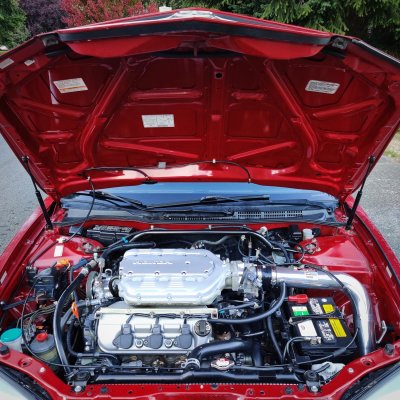

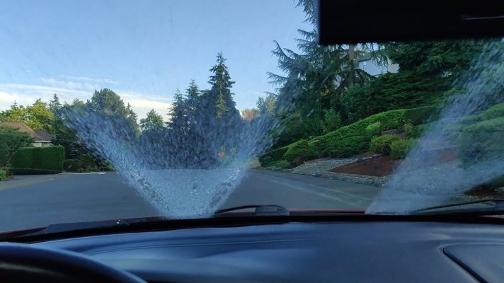

My driver's side windshield washer sprayer has been clogged since day one, 4 years ago, and I FINALLY fixed it! Here are some pics!
Removed and ditched the 21-year-old nasty hood linear, so I could clean out the build-ups in the tube with the air compressor & the pipe cleaner brush to get the gunk out.
My OCD kicked in, and cleaned the hell out of the hood panel, as you can see!
It's soo satisfying, and making me sooo happy now lol!!
Updated the OP to take care of the vehicle remark sections! :rocking:
Thanks for checking! :peace:

Been self-complimenting the engine bay lately, ever since I removed the hood liner lol. Then, I noticed that there were two sections where water has been getting into the bay!
One of the sections was by the driver side's head light, where it meets the hood panel when it closes. The headlight already has the weather strip on the housing, but the hood hasn't been sitting flush. So I applied some rubber weather trips on the edge of the hood panel to fill out the gap.
The other section was by the top of the fire wall, behind the strut bar, underneath the cowl grille. There were two holes for clips that weren't used, and some rain water was dripping on the rear engine mount. Figured duct-taping was the easiest to deal with, so I applied that sucker for the hell of it.
Hopefully, there won't be anymore rain / water going into the bay!

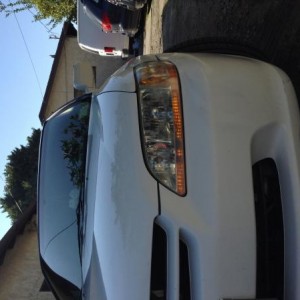

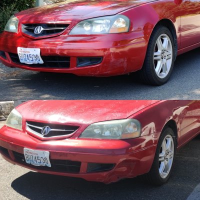

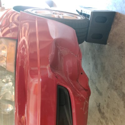

Forgot to document this dent removal project I've had a few weeks ago lol. A clueless kid slammed into here with his bicycle. He was coming from a downhill with a full speed, not knowing there would be cars making a turn. There was quite an impact, but he stood right up, and started to walk, so I just drove away after telling him to watch out. I could care less about this car's cosmetic, since she is a beater lol.
Came home, and realized how embarrassing this dent was, so I decided to pop it back out. Thanks to the factory bumper, it didn't crack. Luckily, I also found one missing bolt by the HID ballast's mount, so this was a plus, and a fun work done together with my son.
It was such a rough and simple repair, but I hope the poor kid got some better treatments than this lol. It would have been a totally different story, if this shit was happening to my Accord instead lol.

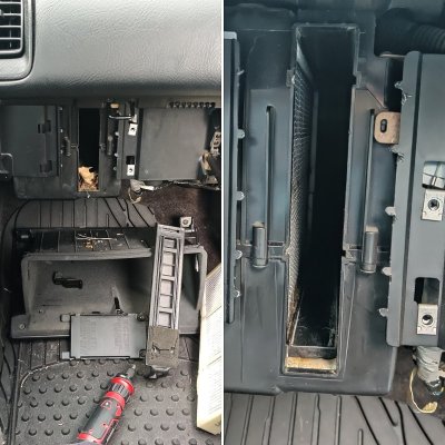

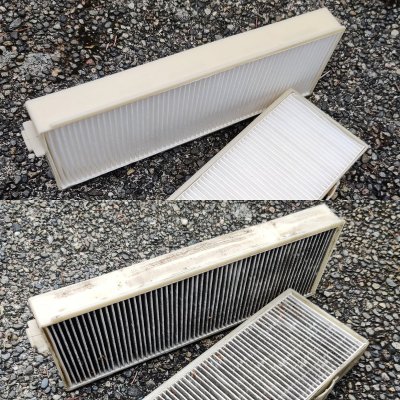

The smell of air coming from the air ducts started to be like an old vacuum cleaner running, so I figured it was time to change out the filters. I was amazed how easy it was to access the filters, when compared to the 6th gen's lol. There were only 5 screws needed to get this thing done, instead of 10-15 screws on my Accord lol.
I let someone else change the filter 4 years ago, when I bought the car iirc, but it was nasty this time! After all, the old vacuum cleaner-like smell is completely gone, and it smells like nothing but breathing through a new facemask now. :Big Laugh:

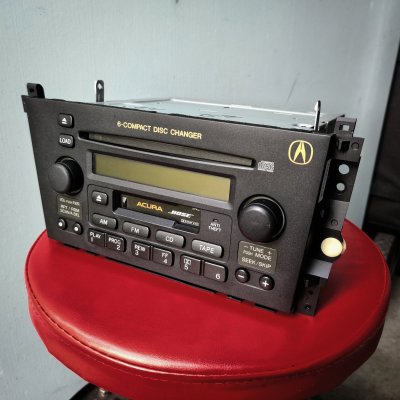

Here's the '01 CL non-NAV HU I bought in order to resolve my '03 HU's CD playa being n/a. It was filthy as hell, when I unboxed the package, so I cleaned the hell out of this sucker.
A lot of screws and panels need to be removed lol. I had to take this pic to memorize which ones to go back lol. There were about 28 pieces or so. Kind of like the 6gen's cabin air filters change deal lol.
Well, guess what? this '01 HU is not playing CD's either lol! Threw me the same error display like my '03's.:banghead: I guess I can't really complain much for $60 price with free shipping haha.

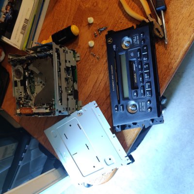

Decided to disassemble my original '03 HU to see if I can try to fix the CD player issue. All of the mechanisms were moving, as far as I checked. Actually, there were 2 custom burnt discs in the changer, which I was able to extract them out of the slots. Hopefully, these discs were the issue, but we'll see what happens, when I reinstall this '03 piece later.
Thanks for checking! :chewie:

Removed the defective '01 HU I bought, and reinstalled my original '03 HU that I recently disassembled & extracted two old discs. Wow, it's working! I didn't think I could fix it tbh lol.
This playa's in the game. let's go! :burnout:

Nothing much, besides a casual inspection, after removing the face plate and the top head. I was just manually checking the mechanism of the disk changer and the disc ejecting assembly. I ended up removing 2 discs that were left out within the slots, but that's about it.
Oh snap, maybe it's time to replace your HU, too.

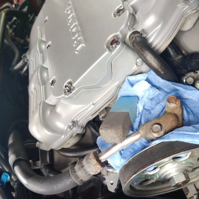

Got this thing at a Japanese dollar shop called Daiso to remove some rust in the engine bay.
This is a half-way progress, but I ended up almost polishing up the entire thing lol.
I'll try to work on a few more areas, when my lower back allows me lol.
Updated the OP for a little bit. Thanks for checking! :dogpile:
