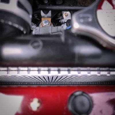

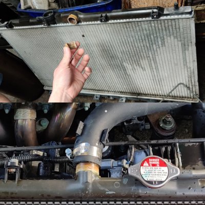

The radiator decided to end its life, as I was expecting it to happen soon, based on my experience with my 6GA's six years ago at the similar mileage. These Denso radiators seem like it can only last for less than 200K mi, when they're exposed to somewhat "extreme environment." In fact, this CL spent the most of its life in Indiana, and my 6GA's first few yrs were in Illinois, so that could be one of the reasons why both of my rads were done at 160K mi. I was expecting to get a crack on the surface or something, like I had it on my Accord, but the upper hose neck section got broken into pieces, and the hose got detached. Currently, the car has two aftermarket motor mounts, so I'm guessing the extra vibrations in the bay could have also shortened its life..
I was omw to work at 4:30 am in the cold ass morning below 32°F, when it happened. After a few minutes of driving from home, I started to smell the coolant from my heater duct, and lost the heat all of the sudden. The temp gage sky rocketed, and I knew it was done.. Drove back home immediately for about a few miles, and switched out the car to be on time to work.. Spent a few days of waiting and collecting parts + cleaning out the Blue Hawaii in the bay. Towed the car to the shop with the new parts upon arrival. (BTW, engine coolant can be one of the life hack things to stay away from mouse and rats problem in your home / garage / car, because engine coolant attracts and eventually kills them, since it's sweet & poisonous.)
The shop suggested me getting this aftermarket radiator by Koyo. I always like having OEM parts, but I decided to give it shot. The price was about the same as Denso's Internet sale price, so it was kind of promising as well. Even if not, I believe I can still rock with my Accord's factory one at the motor swap, since it's relatively a new one with the OEM hoses that came with it.
Got the car back from the shop, and drove it back home. I couldn't get enough chance to test it out spiritedly, but... Wow, this clutch pedaling is feeling so much different now lol. I'm still getting used to let it go faster, w/o the fear of getting the harsh engagement, but I like the fact that I don't have to step on it so much anymore in the first place. I need to drive it more to feel more actual differences.
EDIT: Drove it for a while to get the overall feeling of the difference. Noticed that the pedal has now a little bit of free play in the beginning for about half of an inch. This is why I feel like I only need to step on it so much less than before. The clutching is def faster and smoother on a city driving. It's a lot less likely to hit the stalling point, and move forward by idling, too. The highway driving seems to have small differences in feelings, but the pedaling became a lot smoother n quicker to shift gears and speed up. Overall, it's smoother, quicker, easier. Def sportier feeling than the factory feeling. Ill post up some photos later, when I get a chance, while I'm still allowed to edit things up here

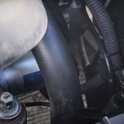

I thought the hose just got dethatched, but it really broke off internally..
