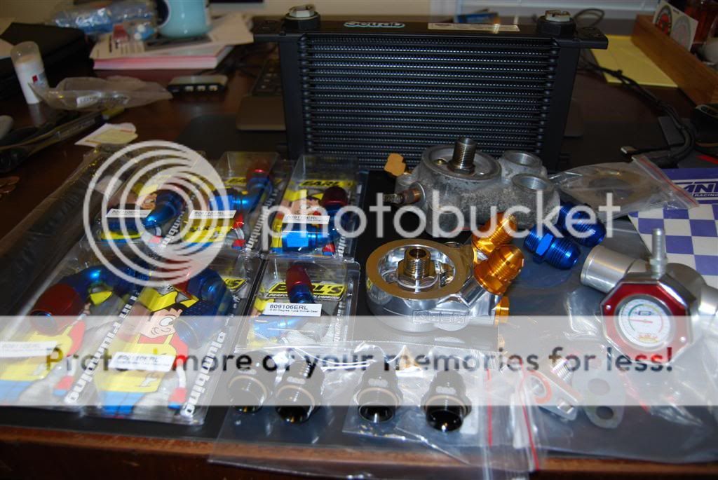

It's sad really how expensive these -AN fittings are... :( Here's a few from a recent order of parts.
-AN fittings
GReddy Oil Filter and Cooler adaptor
Setrab 19 row oil cooler
Canton P/S reservoir
etc...
I found out about this GReddy piece from the Skylines New Zealand forums and decided to go that route. So after $280 for the NISMO piece (used), $100 for the M26x1.5mm to -12AN fittings (and $40 for the Setrab -12 fittings), AND $10 for the brass fittings, I've decided not to use the NISMO piece and use the GReddy one instead. I use a threaded piece into the block (3/4-16 x 1" long), the GReddy piece fits on that, and the oil filter and oil cooler lines fit to that. Much cleaner install and less cluttered. Oil Pressure sensor and oil temp will be tapped into the bottom of the GReddy piece. After all the whole point of this build is to be less cluttered, right?
Old part:
New Part:
