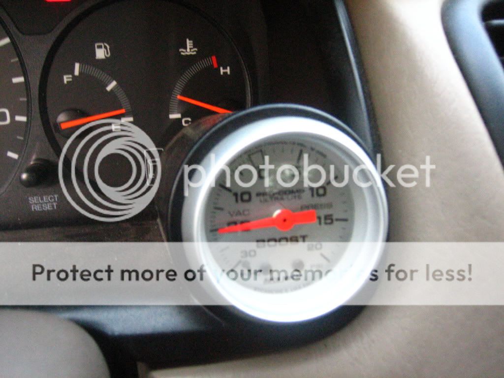

Idle issue with my IACV has been worked out. Air/Fuel readings are consistent with my previous tune. Temperature is perfect. Oil pressure system has been revamped with copper oil line mated to a steel braided hose tapped to the block. Leakless system with much better accuracy and fluid movement than I had before. Vacuum stable at 20, as it normally was before the project.

Thanks man! Yeah the videos are short, but they get the point accross. I'm just happy that it fired up flawlessly first try, I'll toot my own horn and say that I'm impressed with myself, as this was my first internals-related 6GA experience. It definitely is a thrill to dig into our engine. I was amazed at the simplicity of everything. The trick is to do everything the correct way it should be done - the consideration, or failure to consider a microscopic detail can mean EVERYTHING.
The AEM wideband I bought all together as a kit, it was $200 shipped. I'm sure you can source the gauge and wideband sensor seperately, for maybe even cheaper, but $200 shipped is a good deal for the AEM UEGO wideband controller as it is, so I snagged it when I was amidst the early shenanigans of stage 1.
