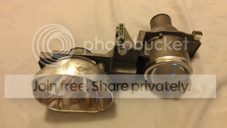

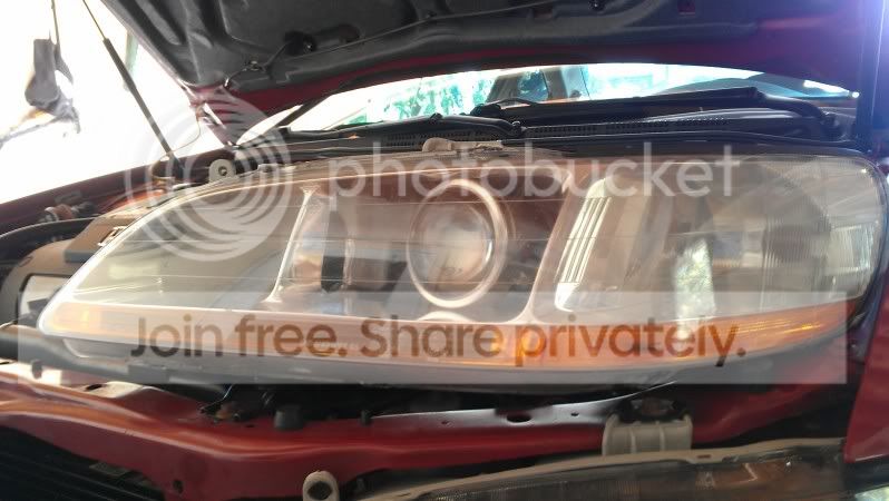

So far I took apart the headlights.

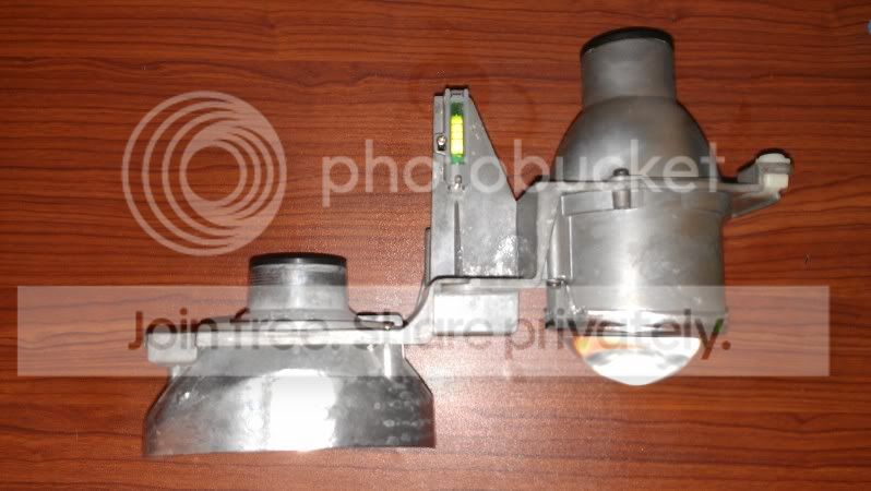

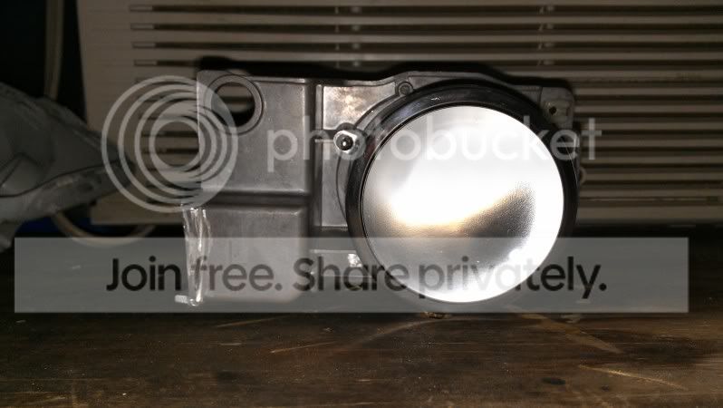

The projectors is one whole piece with the high beam so a little cutting and custom fitting will need to be done of course.
Just a quick bulb test and to see how the cutoff was and surprisingly it wasn't that bad.. (will upload cutoff pics when retrofit is completed).
Since this is my first time doing a retrofit, I'm gonna need a "test" headlight. I'm currently searching on CL and nearby junkyards for one, I should be able to pick up a headlight by this weekend and have it retrofitted beginning of next week. Thanks for looking and stay tuned!
******UPDATE 8-22-12

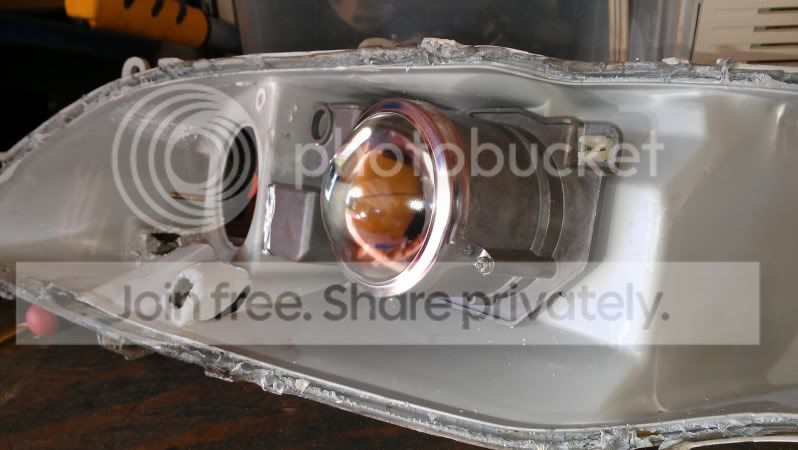

I did some cutting today and it turned out pretty good except for the corner but no one will notice once everything is put together.

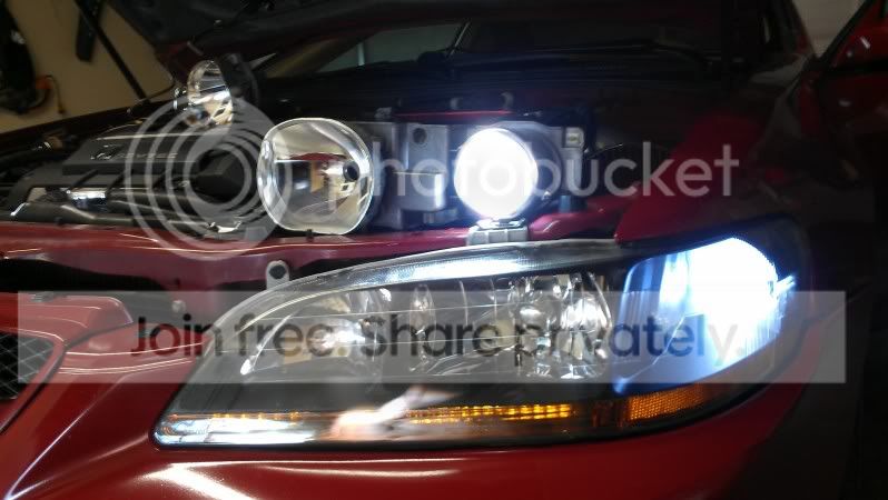

A couple test fitting again..

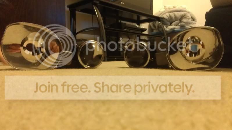

I'm probably not going to use my low beam bucket, I might just mod something different to it. I'm still going to use my high beam bucket though.
Keep in mind this is a "test" headlight these projectors will go into my black housed headlights once everything is fitted and looking the way I want it to.

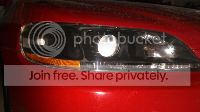

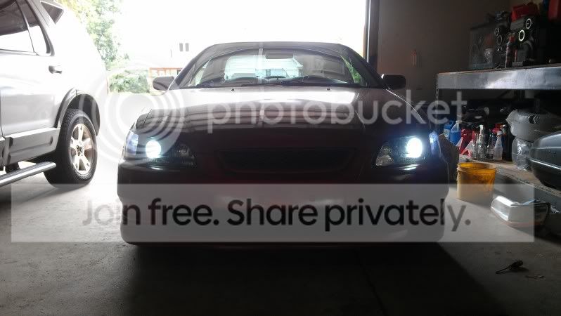

******UPDATE FINISH 10/08/12
Sorry for keeping you guys waiting, even though you guys probably forgot all about this thread lol I've actually completed the retros two weeks ago but I never had the time to keep you guys posted, well here it is!

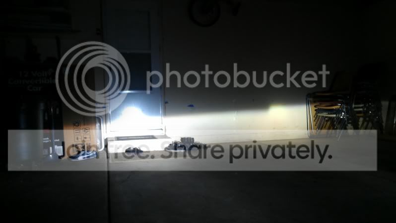

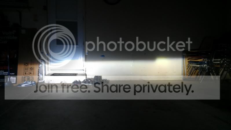

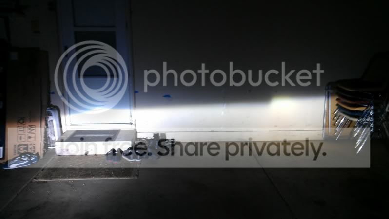

Here's the cut off. Don't mind my different HID bulbs lol and don't mind the left cut off. It's just the reflection off the door that's why it gives that scattered light, the cut off is the same as the right.
As you can see I still have some adjusting to do.

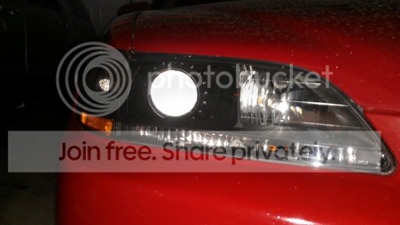

and one last pic..
Thanks for looking!
