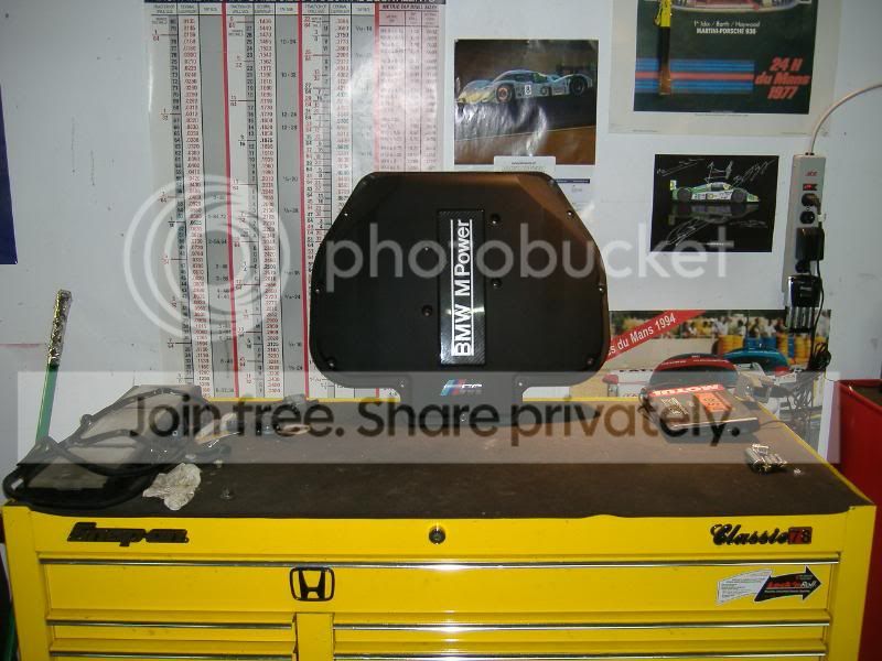

We have an e39 M5 at the shop that had a CEL for an idle air controller. For some reason the customer went to 3 different dealerships for this issue, and none of them could figure it out. (probably because they only use the computer for diagnostics, and don't actually look at any of the components.) So I went at it. It ended up that even though the IACV had been replaced, it was seized up with carbon. I cleaned it all up and its good to go now. I put new gaskets on everything and put it back together.
Those trumpets are so sexy!
MMMMMMMMMM Power!

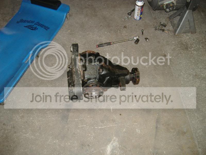

We're also doing the axle seals on the rear diff of the M5. I have to do the same thing on my M3, :(
Its a heavy b!tch.

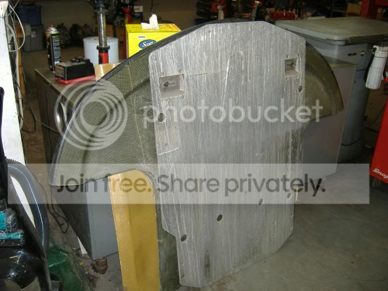

That's the old, super heavy, super thick sump guard resting on the new carbon/Kevlar sump guard. The weight savings is close to 60lbs!
