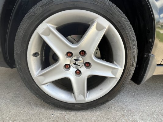

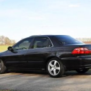

So there’s that. Looks so much better. They rub over bigger bumps and hard turns. Which doesn’t make sense cuz while they are 1.5” wider, they don’t poke *IN* but maybe a couple millimeters. They’re also only 0.3” taller than stock.
Oil change, PS hose, plugs/coils, VTEC solenoid AND gasket, and filter housing gaskets… DONE. Now have a P0131 code: upstream o2 sensor. Fairly cheap and should be pretty easy to do.
Also need hood struts. And front brakes. lol.
19,602
161
Hmm is there a loose fender liner, strut boot hanging down/disintegrating, or something? That's all I can think of, 17x8 +45 and 235/45/17 shouldn't rub at stock height. Unless something suspension-wise is out of alignment. Just thinking aloud here.
Either way looks great lol. One of the all time great Honda/Acura OEM wheels.

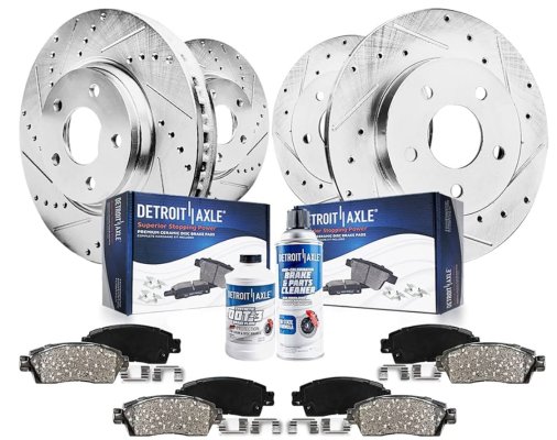

Also need brakes in the front. They’re getting pretty thin (1/8”). I have rear rotors so I may do the fronts. Unsure of their thickness or if they can be turned but I might as well. They’re not terribly expensive and it’s a decent piece of mind.

So I picked these up off of Amazon. I’m very familiar with Detroit Axle as I work with them often. These have a lot of real good reviews with the exception of squeaking pads after several months, so we’ll see.

Pads and rotors replaced.
Front and then rear.
Rear pads were pretty much gone. Fronts weren’t terrible but might as well. I know factory wheels are 15 and these are 17 but I didn’t think the rotors would look as small as they do. Oh well, lol.

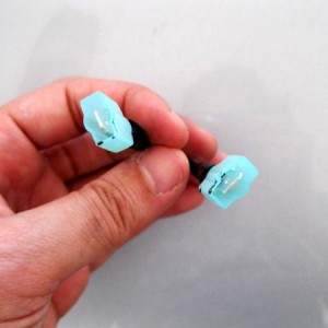

Also replaced both front corner signals for something brighter. They’re not as deep amber but a more yellow. They’ll do for now.

New brakes look good. Always made me chuckle how small the rear rotors are on these cars.
