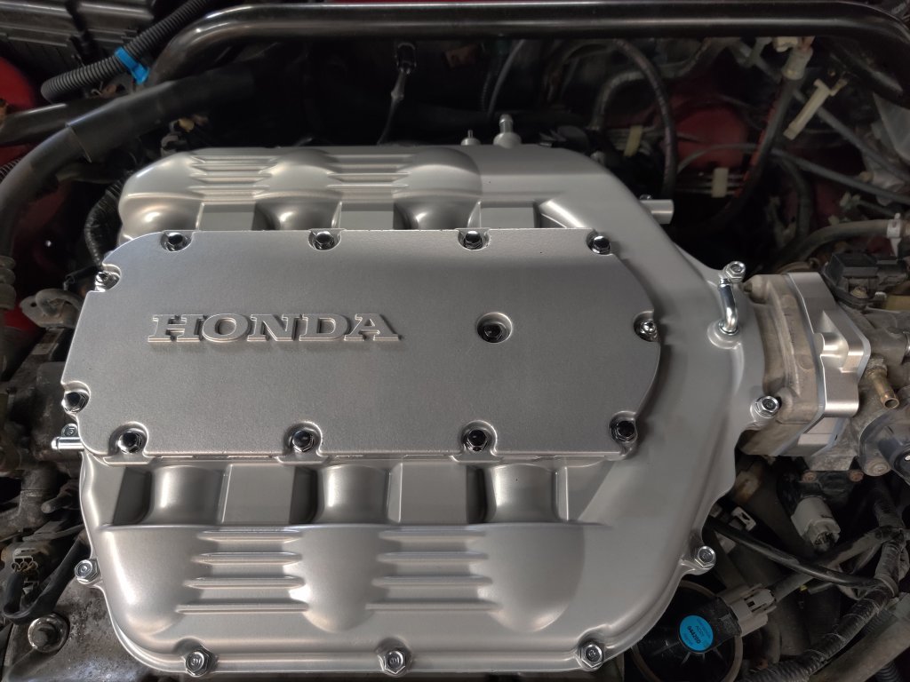

Updated 2021! Welcome to my CL's thread. :)
Got this car as a donor car for my Accord to do the 6-6 swap. Was trying to get the engine & MT by itself gutted out, but since this vendor was taking forever to sell me one, I found this running J32 6MT with wheels on instead, with a surprisingly good vehicle history, though it's relatively a high mileage car.

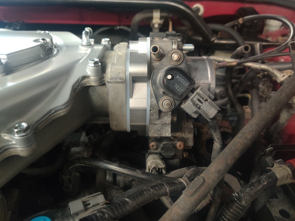

A few updates to report some progress. The rear wheel bearings and hubs were done, so I had to get them new. Front ones, knock on woods lol! Got the J37 I.M. installed along with the valve clearance adjustments. New front valve cover + engine cover stay bracket as well, and the motor is looking a bit shiner this time again! Currently, the air intake temperature sensor is stuck out bare naked by a zip tie from the original J32 I.M., as well as the 2-pin air temperature sensor plug from the J37 I.M. in the bay, but those will be taken care later, when the swap begins. The oil pan was leaking oil, so I got that resealed as well. Got some further vehicle inspections at one of my favorite motorsport performance shops, and received some additional remarks on the vehicle. Half of the stuff I got isn't really swap-related, but I'm adding these to the remark section below: (More stuff to take care lol.) The car is now at the Acura dealer to get the airbag service recall + some fluid change done. Turns out that my airbag needs a replacement! :eek: The J37 I.M. lower gasket, didn't fit exactly on the J32. Ended up keeping the original J32 gasket instead, and it was a perfect fit. I'll need to update my old parts list for the J37 I.M. swap. Have been working on the trunk flood issue, and I finally tracked down the leaking area. Filled out the trunk's rain gutter with some Flexi Glue. The left side stopped leaking, but the right side didn't, so I added some silicone sealant by the window frame. Couldn't confirm the result, b/c the car's gone for the service recall, but we'll see what happens.
EDIT: Still leaking lol. Gears are shifting a lot softer now! Gave a little search on Azine, and it seems like it's the bottom rea window seal. I did put some silicone, but I figured that wasn't just enough.

Updated the list! Still playing the silicone game to sort out the right side of the trunk leakage. She is wearing a used set of tires from the Accord now. The rear tires were in a poor shape, due to the recent tire rotation (ones that came with the car) and recently there was a screw stuck on each of the nearly new front tires lol. Both of them were not really punctured to the back side, so I kept them as a spare set, or sell them for cheap.
Engine Bay / Performance:
* '08 - '12 Honda Accord V6 AT J35 I.M. Top Cover
* '09 - '14 Acura TL SH-AWD J37 I.M.
* Bosch Icon Wiper Blades
* Denso Ignition Coils
* Injen Technology Cold Air Intake
* P2R Power Rev Racing J32 T.B. to J37 I.M. Adaptor
Suspension / Footwork:
* SPC Right Front OE Replacing Upper Ball Joint
Exterior / Cosmetics:
* Stock
Interior:
* JDM Air Fresheners
* Meguiar's Air Re-Fresher
* Window Films
Lighting:
* Stock
Electronics / I.C.E. / Misc.:
* Stock

Engine / drivetrain maintenance:
– Timing belt ----- Done! @108K mi
– Water pump ----- Done! @108K mi
– Air intake ----- Done! @144K mi
– EGR Valve & Gasket ----- Done! @143K mi
– Spark plugs ----- Done! @143K mi
– Ignition coils ----- Done! @143K mi
– Throttle body gaskets ----- Done! @144K mi
– Throttle Body Cleaning ----- Done! @144K mi
– Throttle position sensor gasket ----- Done! @144K mi
– Front Cylinder Head Covers ----- Done! @144K mi
– Rear Cylinder Head Covers ----- (From the Accord)
– Cylinder Head Cover Gasket Sets ----- Done! @144K mi
– Valve Cover Gasket ----- Done! @144K mi
– Valve Clearance Adjustment ----- Done! @144K mi
– Oil Pan Gasket ----- Done! @144K mi
